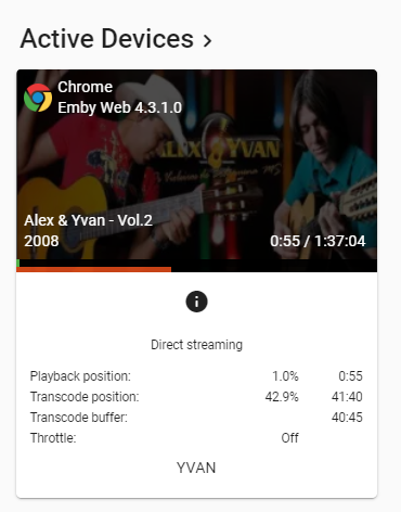

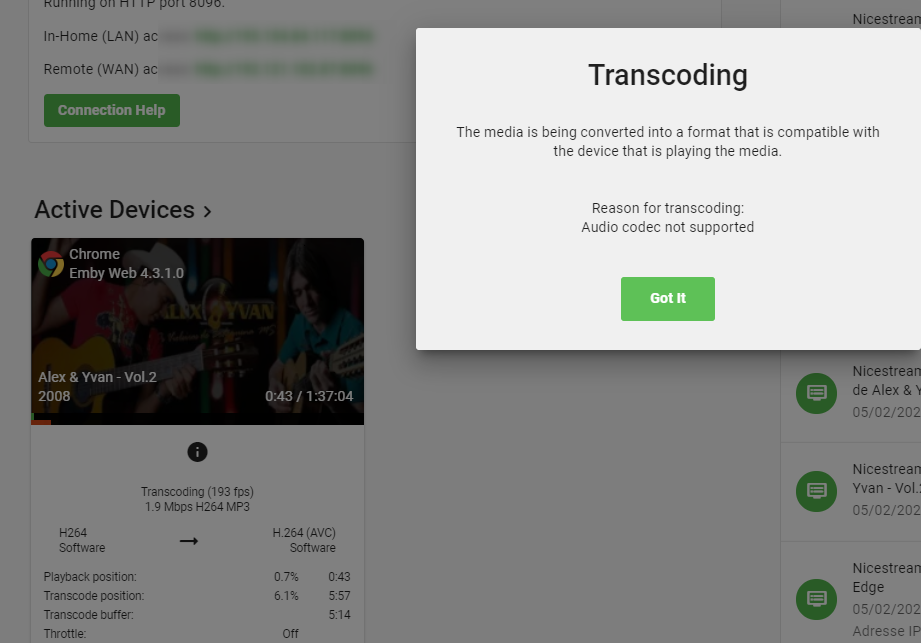

Nostromo86 17 Posted February 4, 2020 Posted February 4, 2020 (edited) Hi everyone, I have the same movie on 2 different server. On one of the server, audio codec not supported and on the other server it's ok. I have emby premier only on one of the 2 Can you tell me why? Thanks Here example https://ibb.co/W5M2CxF Edited February 4, 2020 by Nostromo86
Luke 42216 Posted February 5, 2020 Posted February 5, 2020 Hi there, what do you mean by audio codec failed?
Nostromo86 17 Posted February 5, 2020 Author Posted February 5, 2020 (edited) Hi there, what do you mean by audio codec failed? Thank you luke for your response. My issue is the following : I have exactly the same movie on 2 different servers. When I play the movie with chrome via server 1, the movie is transcoded because it tells me that there is a problem with the audio codec If I play this same movie on server 2, the movie is live stream and there is no codec problem. why server 1 transcode? i prefer direct stream I ask where the problem may come from. Thank you Edited February 5, 2020 by Nostromo86

Luke 42216 Posted February 5, 2020 Posted February 5, 2020 why server 1 transcode? i prefer direct stream Hi there, did you explore the stats feature in the video player to learn why it was transcoding?
Nostromo86 17 Posted February 5, 2020 Author Posted February 5, 2020 Hi, Yes see bellow SERVER 1 SERVER 2 Stats for geek on 2 server https://ibb.co/W5M2CxF thx
ebr 16313 Posted February 5, 2020 Posted February 5, 2020 So does that answer your question? I don't think so as his question is why is the audio codec incompatible when coming from server 1 but the container incompatible when coming from server 2? That's got me a bit puzzled as well as the target system is the same (supposedly)...

Happy2Play 9806 Posted February 5, 2020 Posted February 5, 2020 (edited) Stats for geek on 2 server https://ibb.co/W5M2CxF thx Looking at this images Server 1 would appear to have a 2Mbps bitrate limit so video is transcoded. Edited February 5, 2020 by Happy2Play
ebr 16313 Posted February 5, 2020 Posted February 5, 2020 Looking at this images Server 1 would appear to have a 2Mbps bitrate limit so video is transcoded. Ahhhh... nice catch. And the transcode reason is just wrong.
Nostromo86 17 Posted February 6, 2020 Author Posted February 6, 2020 (edited) Looking at this images Server 1 would appear to have a 2Mbps bitrate limit so video is transcoded. thanks for the information How can we remove the limit? Here the log server Server1 https://pastebin.com/XWrNKaJ0 Server 2 https://pastebin.com/RWWGbLSa Thx Edited February 6, 2020 by Nostromo86

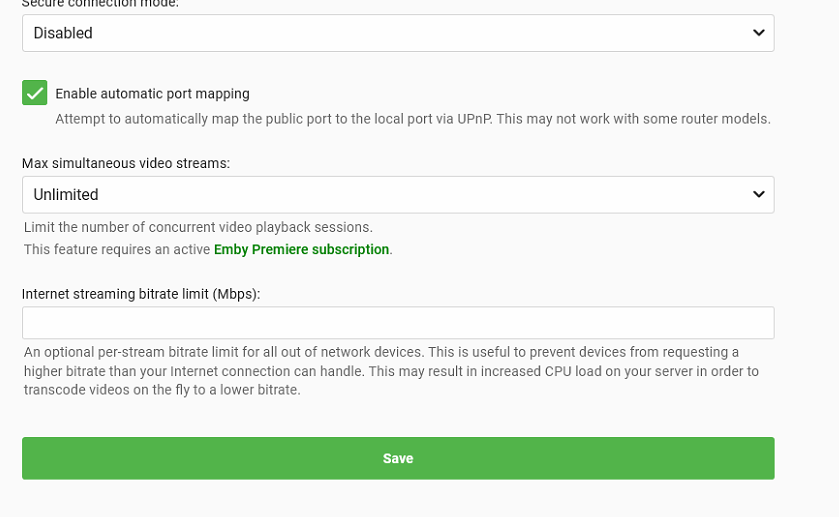

ebr 16313 Posted February 6, 2020 Posted February 6, 2020 thanks for the information How can we remove the limit? Hi. Are you sure you didn't enter a limit of 2Mb/s in the "internet streaming bitrate limit" field in the server configuration? That's what it looks like is happening.
Nostromo86 17 Posted February 6, 2020 Author Posted February 6, 2020 Hi. Are you sure you didn't enter a limit of 2Mb/s in the "internet streaming bitrate limit" field in the server configuration? That's what it looks like is happening. Nop
