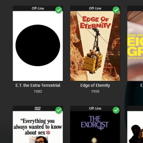

crusher11 1137 Posted February 3, 2020 Author Posted February 3, 2020 That setting keeps from distorting the poster. That does not change the fact that the different treatments will have different shapes themselves. e.g. This treatment: Will be a different shape (aspect ratio) from this one: Right, but everything in my library has the same treatment so I'm just talking about the actual poster. It's fine on each movie's individual page but is stretching my 2:3 covers horizontally on the library page. My collections are untreated and 2:3 works perfectly there.
ebr 16313 Posted February 3, 2020 Posted February 3, 2020 Right, but everything in my library has the same treatment so I'm just talking about the actual poster. It's fine on each movie's individual page but is stretching my 2:3 covers horizontally on the library page. My collections are untreated and 2:3 works perfectly there. Those were just examples. When you use CoverArt almost every treatment adds something around your posters which will cause the shape to be different from the poster itself.
crusher11 1137 Posted February 3, 2020 Author Posted February 3, 2020 Right, but that's not what I'm talking about. The attached "primary.jpg" is 2:3 and contains a perfect circle. But if I set it as a poster image the circle is now wider than it is tall. However, if I then click on it and go to the page for that movie, it's a perfect circle again.
ebr 16313 Posted February 3, 2020 Posted February 3, 2020 Right, but that's not what I'm talking about. The attached "primary.jpg" is 2:3 and contains a perfect circle. But if I set it as a poster image the circle is now wider than it is tall. However, if I then click on it and go to the page for that movie, it's a perfect circle again. That is most likely due to what I mentioned above. The web app is expecting 2:3 - but when you add the "Off-Line" title bar to the top of your image, it is no longer 2:3 but it is close enough that the app decides to squeeze it in.

Luke 42216 Posted February 4, 2020 Posted February 4, 2020 CoverArt alters the image aspect ratio so that it is no longer 2:3, and then the web app stretches it back to 2:3. Try enabling the Cover Art option to preserve original aspect ratio.
crusher11 1137 Posted February 4, 2020 Author Posted February 4, 2020 (edited) Try enabling the Cover Art option to preserve original aspect ratio. As I said earlier: I'm using Cover Art and I have it set to use the original aspect ratio. Edited February 4, 2020 by crusher11
ebr 16313 Posted February 4, 2020 Posted February 4, 2020 CoverArt alters the image aspect ratio so that it is no longer 2:3, and then the web app stretches it back to 2:3. Try enabling the Cover Art option to preserve original aspect ratio. He's already got that set and, as he can see in the detail page, CoverArt is preserving the aspect of his original art. It is the web view (presumably the home screen) that is distorting it. It looks like it isn't respecting PrimaryImageAspectRatio on that screen and, instead, forcing it into a 2:3 box.
