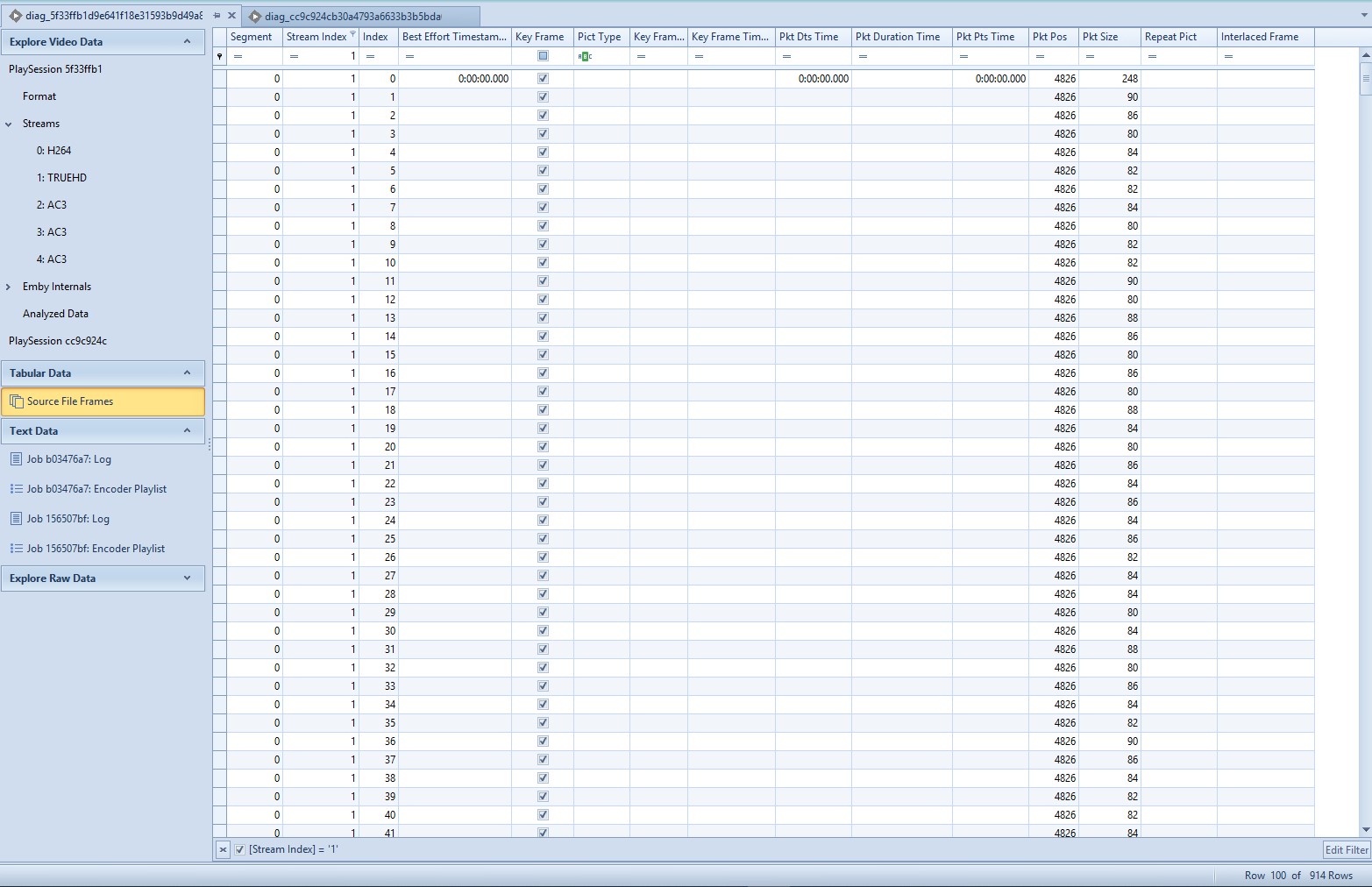

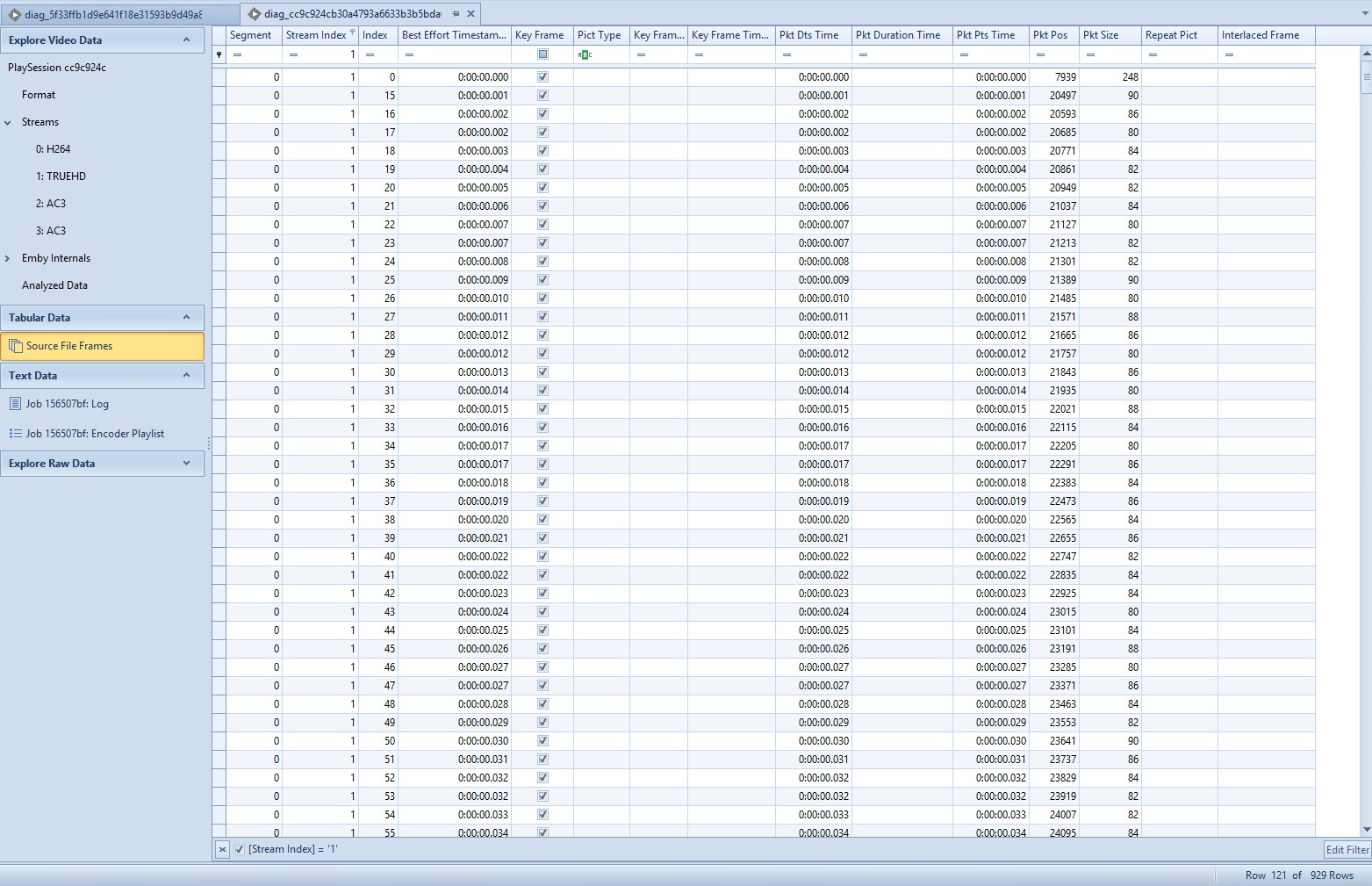

softworkz 5130 Posted February 17, 2020 Posted February 17, 2020 I figured it out. I was using MKVToolNix to change the names of the audio tracks. *EDIT* actually not sure what it is, but happens after i edit it using MKVToolNix for the audio titles. Will dig further later I think what you did is much more than changing track titles (maybe unintentionally though). Here's a detailed comparison of the metadata: mkv_compare.pdf But I don't think that it's the metadata. What I've seen is a significant difference in the frames of the TRUEHD stream: Look at timestamps and PacketPos values. (all other streams are very similar when looking at the single frames) Whatever you did to the file - something wrong happened.
