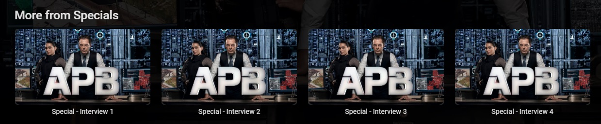

Happy2Play 9806 Posted January 30, 2020 Posted January 30, 2020 I just added "interview 1-4.mp4" to a Specials folder of a Series and did not have any issue. So yes specific examples are needed. 1
