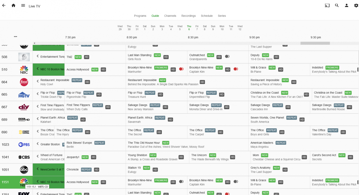

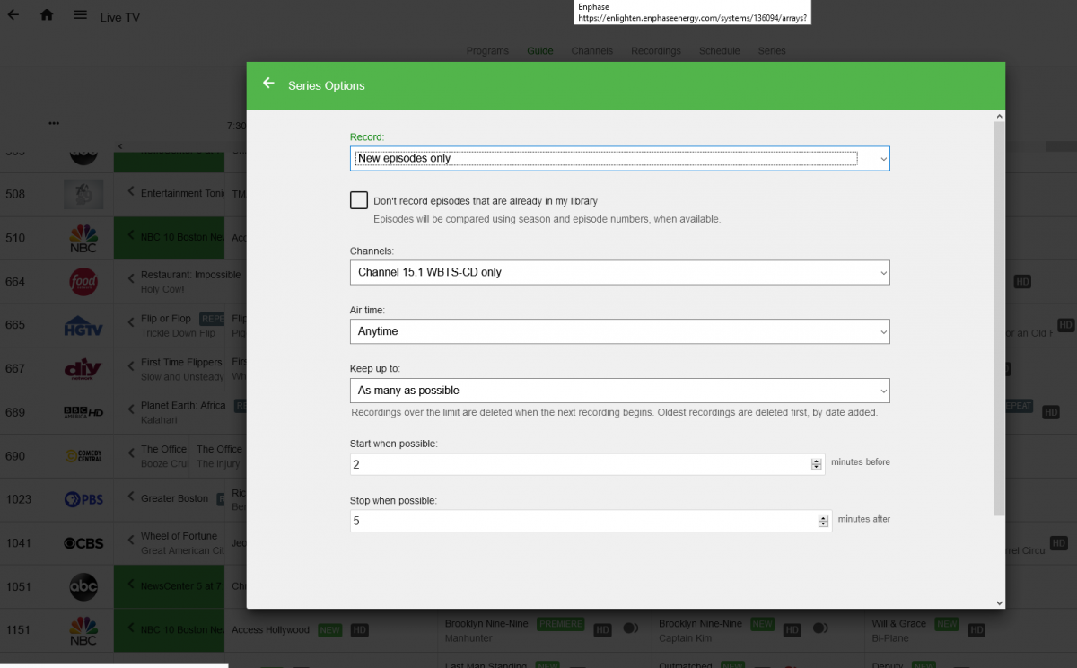

sailracer 9 Posted January 29, 2020 Author Posted January 29, 2020 I'm playing around with this a little more and see that on a new recording I have set up, it is changing the recording channel from the OTA tuner to the HD Homerun prime despite me selecting only the OTA channel. The attached screenshots show this.

ebr 16337 Posted January 30, 2020 Posted January 30, 2020 I'm playing around with this a little more and see that on a new recording I have set up, it is changing the recording channel from the OTA tuner to the HD Homerun prime despite me selecting only the OTA channel. The attached screenshots show this. "Only on this channel" means that actual broadcast channel - not that channel on that tuner. Emby pools your tuners and will select any available one with that channel. Does that explain that for you?
sailracer 9 Posted January 30, 2020 Author Posted January 30, 2020 "Only on this channel" means that actual broadcast channel - not that channel on that tuner. Emby pools your tuners and will select any available one with that channel. Does that explain that for you? That does answer that question. I'll suggest the ability to select the tuner as well would be a great future enhancement for the guide Thanks!
