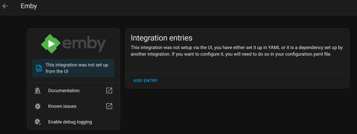

Sammy 791 Posted October 18, 2024 Posted October 18, 2024 Old thread. New post. I have recently migrated from Vera to HomeAssistant. I know @chefmade the Vera Plugin and from reading through here it looks like some preliminary work was done for HA. I don't find anything for Emby in HA Add-ons which is disheartening when seeing a Plex add-on in there. Any updates? I'm willing to test things.
Sammy 791 Posted October 19, 2024 Posted October 19, 2024 20 hours ago, Sammy said: Old thread. New post. I have recently migrated from Vera to HomeAssistant. I know @chefmade the Vera Plugin and from reading through here it looks like some preliminary work was done for HA. I don't find anything for Emby in HA Add-ons which is disheartening when seeing a Plex add-on in there. Any updates? I'm willing to test things. Okay, I managed to add the integration but it has no entities. I'd like to have it set up to dim or turn off the lights when starting a movie. Anyone doing this?
