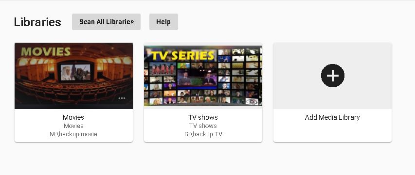

chrisrobbins1970 82 Posted January 23, 2020 Posted January 23, 2020 i have deleted from the server..reboot server.. but still there, however as can be seen NOT showing up int he libraries... ideas???
chrisrobbins1970 82 Posted January 23, 2020 Author Posted January 23, 2020 did that.. still not removing from the main page..also still shows on my Roku
ebr 16313 Posted January 23, 2020 Posted January 23, 2020 How about running a library scan? Exactly how did you delete that library?
chrisrobbins1970 82 Posted January 23, 2020 Author Posted January 23, 2020 deleted by going to LIBRARIES > REMOVE

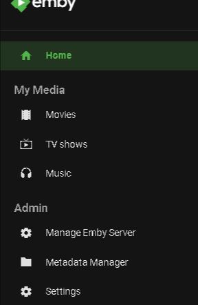

chrisrobbins1970 82 Posted January 23, 2020 Author Posted January 23, 2020 its also showing up in this pop-out...
ebr 16313 Posted January 23, 2020 Posted January 23, 2020 deleted by going to LIBRARIES > REMOVE Did anything interesting happen at that time? Anything hang up? Any sort of error message? Any confirmation that the delete occurred? Do you have the server log from when you did that delete?
chrisrobbins1970 82 Posted January 23, 2020 Author Posted January 23, 2020 did scan all lbraries.. no errors.. did get confirmation message.. my thinking is I have alot of music..maybe it will take a while to complete remove the metadata
ebr 16313 Posted January 23, 2020 Posted January 23, 2020 Something must have gone wrong with the removal of the library. If you can find the log from when you did that, it may tell us what.
chrisrobbins1970 82 Posted January 23, 2020 Author Posted January 23, 2020 ok.. which logs do you need..i see alot of them
ebr 16313 Posted January 23, 2020 Posted January 23, 2020 We need the server log (embyserver-xxxx) from the exact time that you did the library delete. Thanks.
chrisrobbins1970 82 Posted January 23, 2020 Author Posted January 23, 2020 paste the whole log here or zip it???
ebr 16313 Posted January 23, 2020 Posted January 23, 2020 Please attach it as a file. Zip it if it is too large.
pwhodges 2028 Posted January 23, 2020 Posted January 23, 2020 Click "More reply options" next to the "Post" button and the file dialogue becomes available. Note that after selecting a file you then have to add it as a separate operation. Paul
ebr 16313 Posted January 23, 2020 Posted January 23, 2020 Okay, was that the entire log file? Did you force close the server or shut down the machine or something shortly after removing that library?
chrisrobbins1970 82 Posted January 23, 2020 Author Posted January 23, 2020 maybe..i did a server restart
ebr 16313 Posted January 24, 2020 Posted January 24, 2020 Okay, so that must be what happened and now your database is inconsistent. I wonder if you re-added the library exactly as it was before, did a scan and let it finish and then removed the library again and made sure to let that process finish before killing the server, if it would fix it...
Luke 42216 Posted January 25, 2020 Posted January 25, 2020 This should be gone for the next release. I would just ignore it until then as it shouldn't be causing any harm. Thanks.
chrisrobbins1970 82 Posted January 25, 2020 Author Posted January 25, 2020 ok..strange thing here..waited over night and its now removed...
