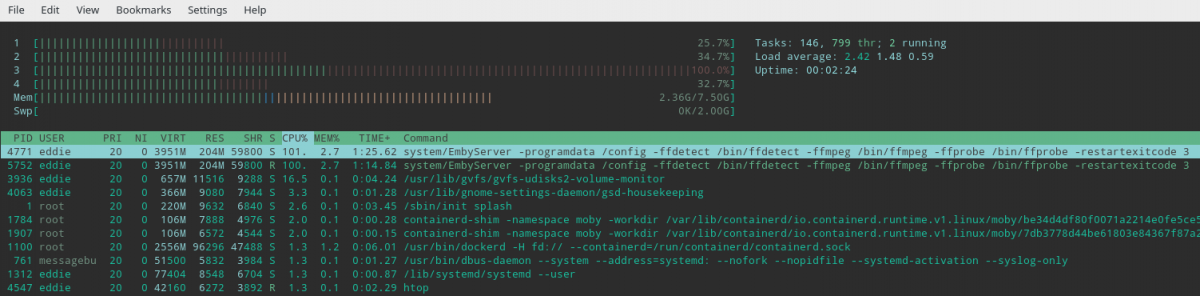

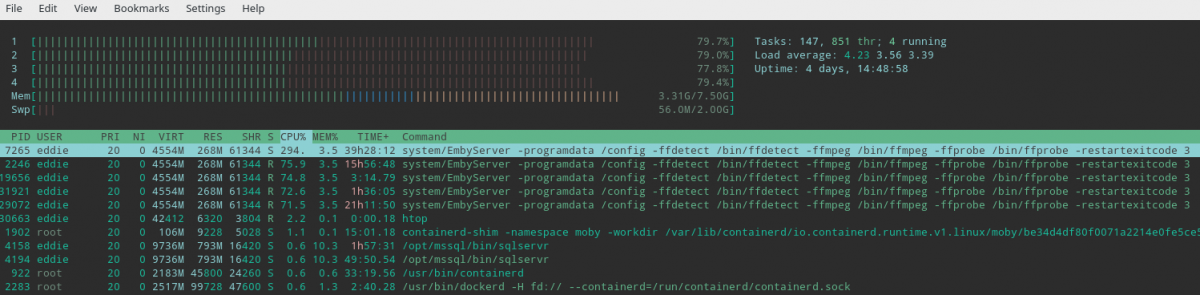

Eddie 12 Posted January 12, 2020 Posted January 12, 2020 (edited) Hello im running Kubuntu 18.04 Emby was running real quiet on my server with barely any CPU load even when people were using it I recently upgrade to 4.3.1.0 and now im noticing a process run at nearly or close to 100% and i wanted to know what it is system/embyserver -programdata /config -ffdetect /bin/ffdetec -ffmpeg /bin/ffmpeg -ffprobe /bin/ffprobe -restartexitcode3 I attached 2 pictures one with a long uptime and the other after a fresh update and restart and letting it sit for a few minutes without anyone logged in Thanks in Advance Edited January 15, 2020 by Eddie

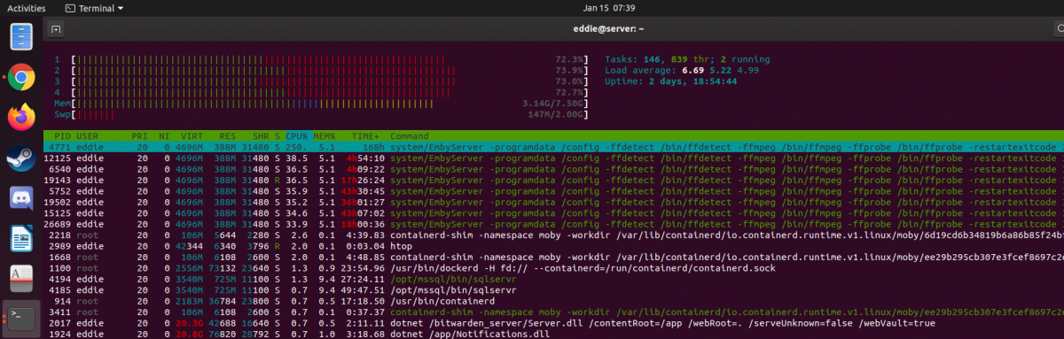

Eddie 12 Posted January 15, 2020 Author Posted January 15, 2020 (edited) As soon as I reboot the computer that process I took a screenshot of starts spiking no one is even logged into the computer except to me SSHing into it Edited January 15, 2020 by Eddie
