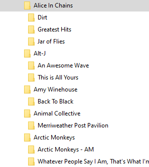

Frusta 0 Posted January 12, 2020 Author Posted January 12, 2020 hello, not running a vpn (the server uses a lan with tplink powerline) the identify works like a charm with movies and tv shows. that's my folder structure which i think is correct
