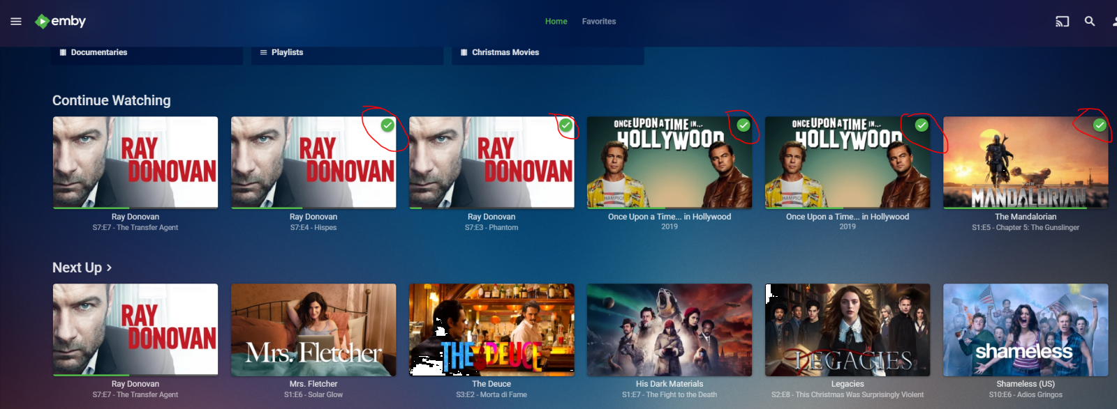

atrpm 3 Posted January 6, 2020 Posted January 6, 2020 Hello, I'm having an issue where emby is showing played content on the continue watching section... the issue started when I upgrade from the previous beta builds (before 4.3.1.0) to 4.3.1.0. I tried uninstalling/installing the trakt plugin but that is not the issue... play states are reported correctly in trakt. Here is an image...

atrpm 3 Posted January 6, 2020 Author Posted January 6, 2020 Yes that is not my case, I have only played this media once... let me be more specific. I just ran a few more test and I think the issue is related to the trakt plugin... here is an scenario: 1. Start playing some media on Emby. 2. Stop playing the media. 3. Resume and complete watching the media. 4. Run the Trakt tasks... sync library, import playstates (in that order). Even though I have only played the media once... it shows as played and pending at the same time. If I look at my trakt dashboard it shows 1 PLAY for the media and it shows completed, but Emby is getting confused somehow.
atrpm 3 Posted January 6, 2020 Author Posted January 6, 2020 Also, if I mark any of that media as played on Emby it get reset back to that weird state after the trakt import playstates task is ran.

BAlGaInTl 288 Posted January 6, 2020 Posted January 6, 2020 So I can confirm that I'm seeing the same thing and also use the Trakt plugin. Not a huge deal for me, but now I won't be able to unsee it. I use it to keep my production and testing servers watch status close to the same.
