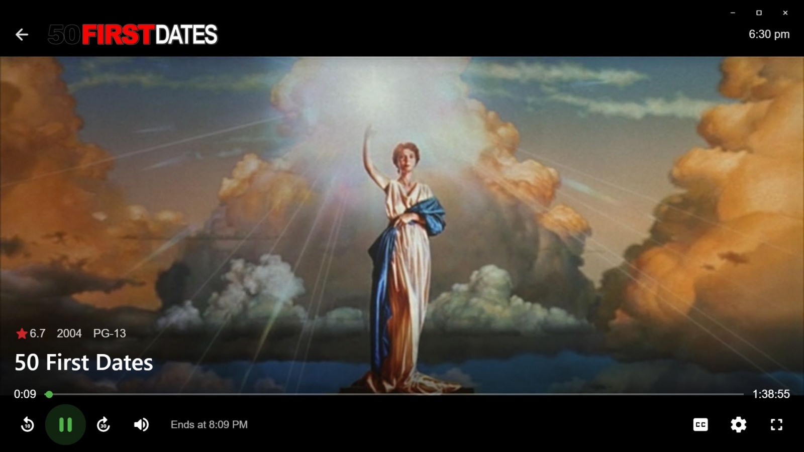

MikeB111 60 Posted January 8, 2020 Author Posted January 8, 2020 Anyone have any ideas on this one? If there is no fast-forward or rewind capability then I don't understand what thumbnails are for. The Emby server seems to think it has created thumbnails but I cannot find them in the directory that it indicated, but no errors are presented. In Emby Theater (latest version, 3.0.10, on Windows 10), here's what I see when I am watching a movie and move the mouse to show the video controls: So I have skip forward and skip back buttons but no other controls. I've seen YouTube video reviews of Emby that show additional controls so I'm confused as to why the interface is so sparse (maybe the videos I've seen are old and this is the new interface, but figured I'd ask)? Is this what I should be seeing or is something not set up correctly? Thanks in advance for any help!
Solution Happy2Play 9806 Posted January 8, 2020 Solution Posted January 8, 2020 Have you hovered along on the playback slider? 1
MikeB111 60 Posted January 8, 2020 Author Posted January 8, 2020 Thanks Happy2Play, now I feel kinda dumb. Yes, if I hover my mouse over the playback slider I see the thumbnails. Awesome! So one last question I guess. On my TV I control Emby Theater with a remote control, not a mouse. Is there any way to get a fast-forward and re-wind function with a remote control (or keyboard as I can map the remote to keys)? Honestly, it'd be useful even with a mouse for control, but especially with just a remote. According to this: https://github.com/MediaBrowser/Wiki/wiki/Keyboard-and-Remote-Support left and right arrow or shift-left shift-right should fast forward or rewind but these keys only do a skip forward and skip back function for me (same for the fast-forward and re-wind buttons on my MCE remote). Thanks, Mike
