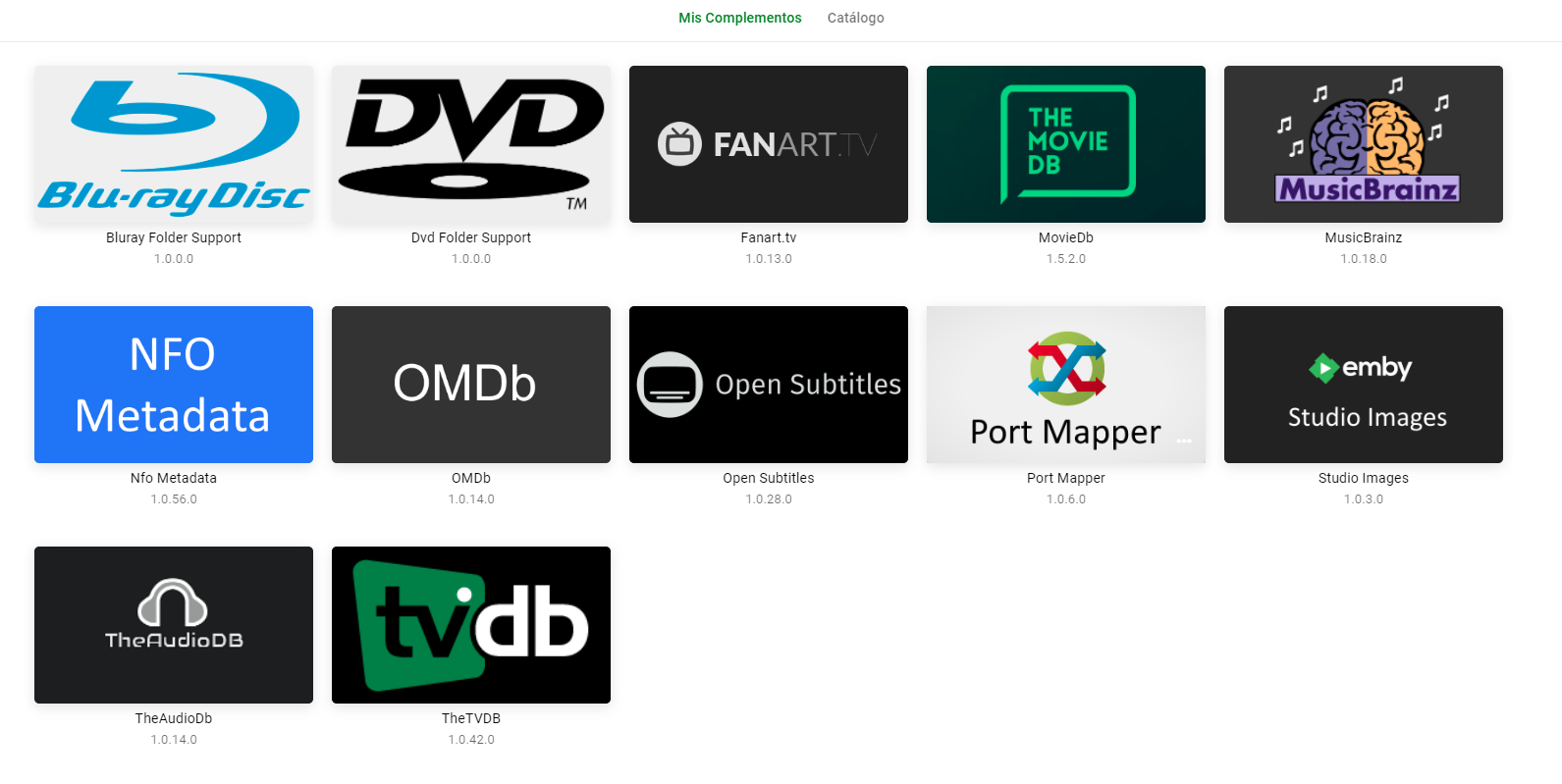

Luke 42243 Posted May 3, 2022 Posted May 3, 2022 You could also try removing the port mapper plugin, then restarting the server and see how that compares.
aea666 3 Posted May 3, 2022 Posted May 3, 2022 2 minutes ago, Luke said: You could also try removing the port mapper plugin, then restarting the server and see how that compares. These are the plugins that I have installed, which one should I uninstall?
aea666 3 Posted May 4, 2022 Posted May 4, 2022 Definitively, that was a silly question (I skim read the plugins). It seems that your suggestion works perfectly. Thanks a lot!
