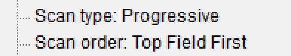

It's misidentified in the header as progressive.
5e0d4155c6ceb_Annotation20200101170302.j
