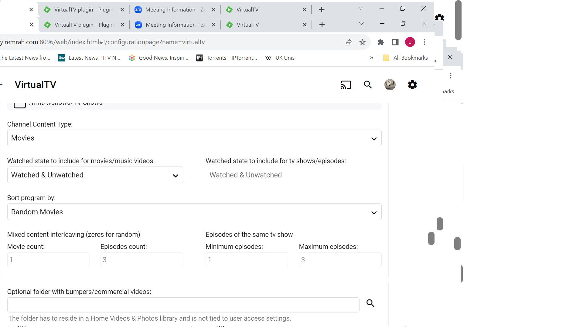

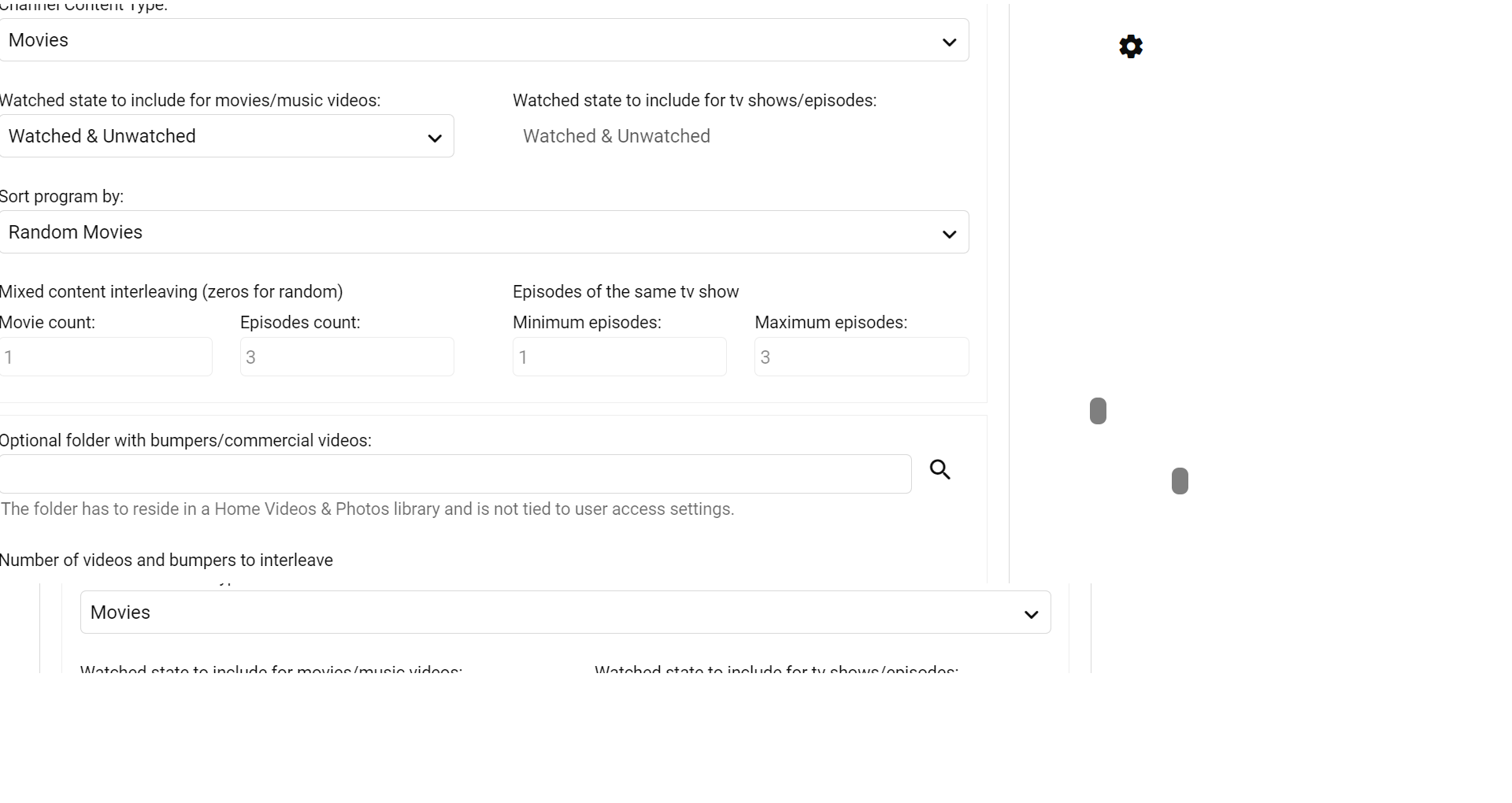

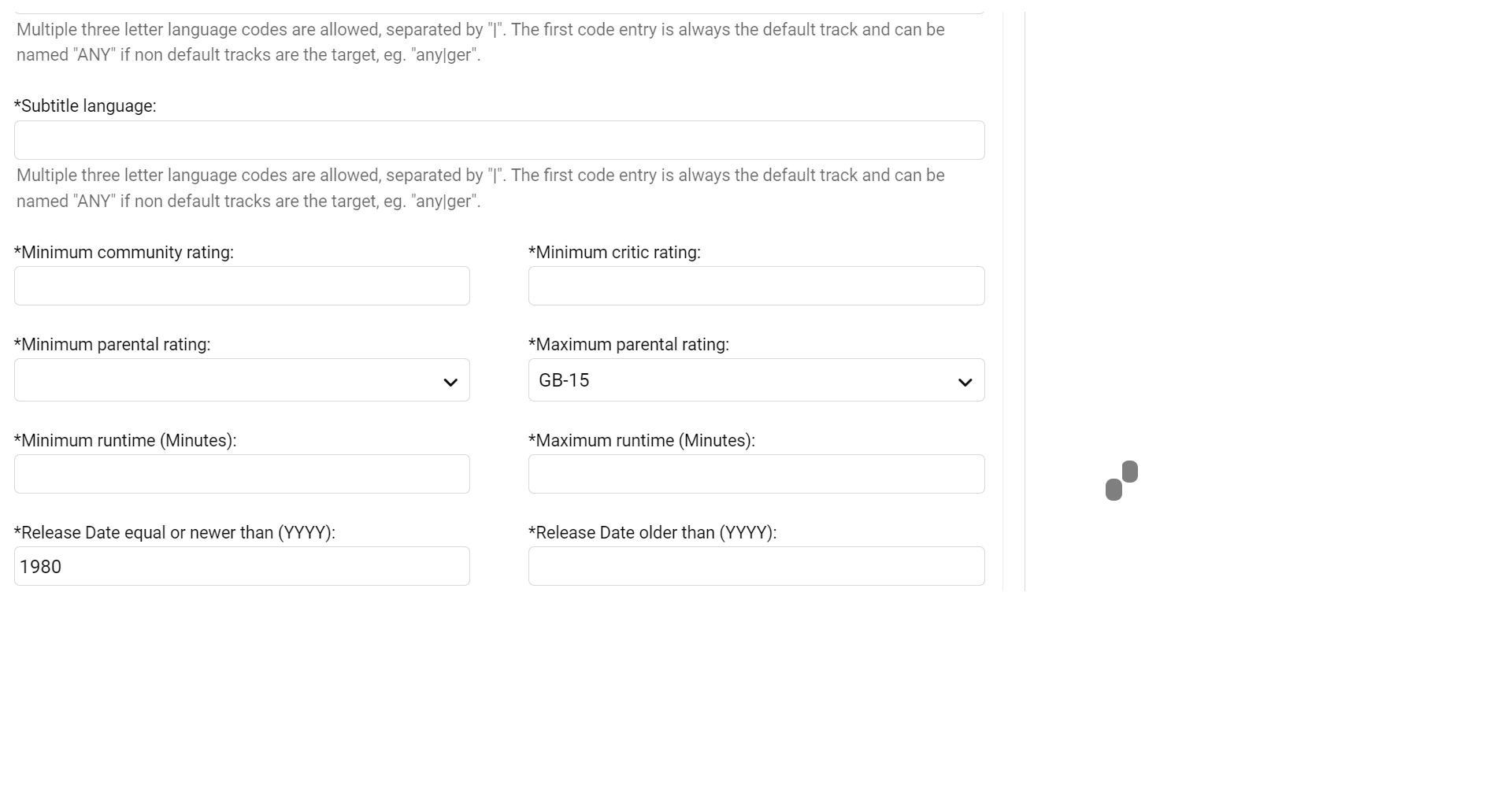

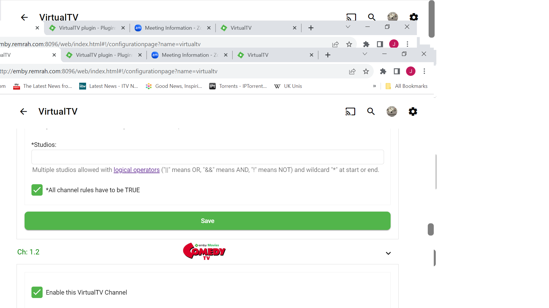

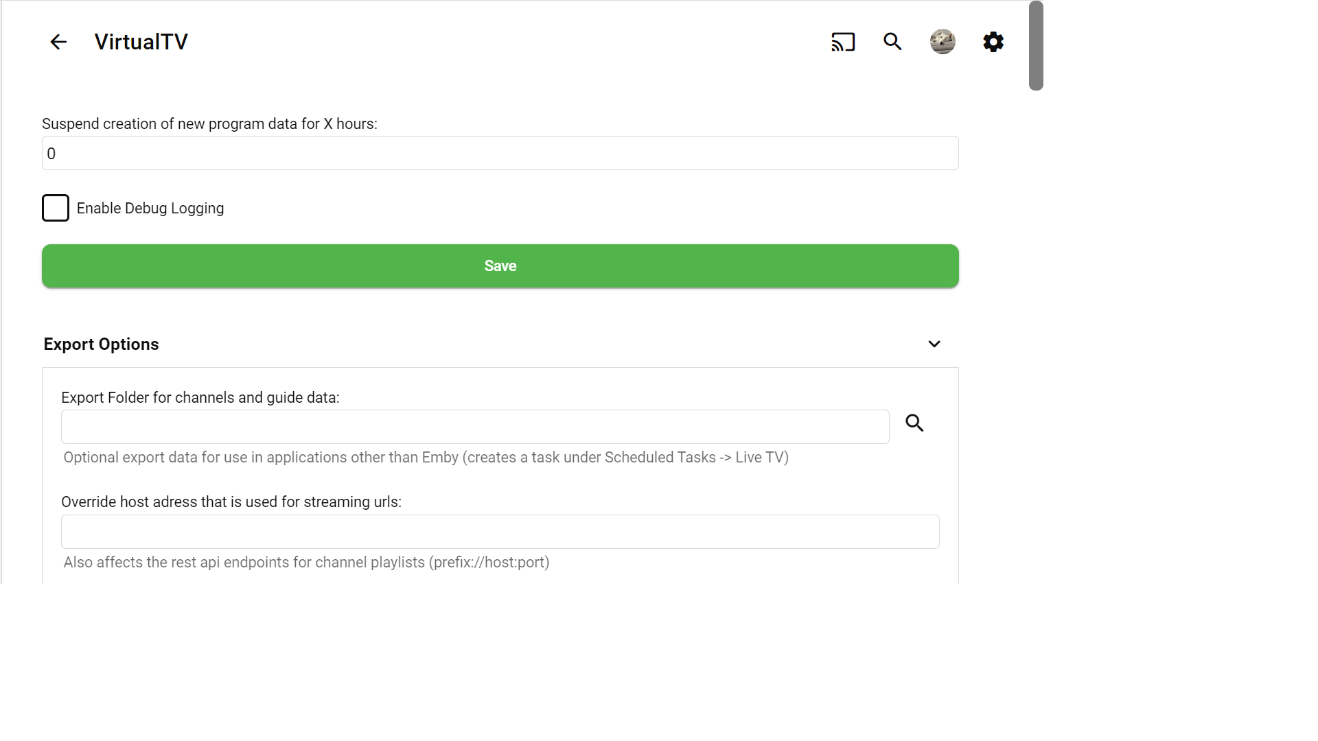

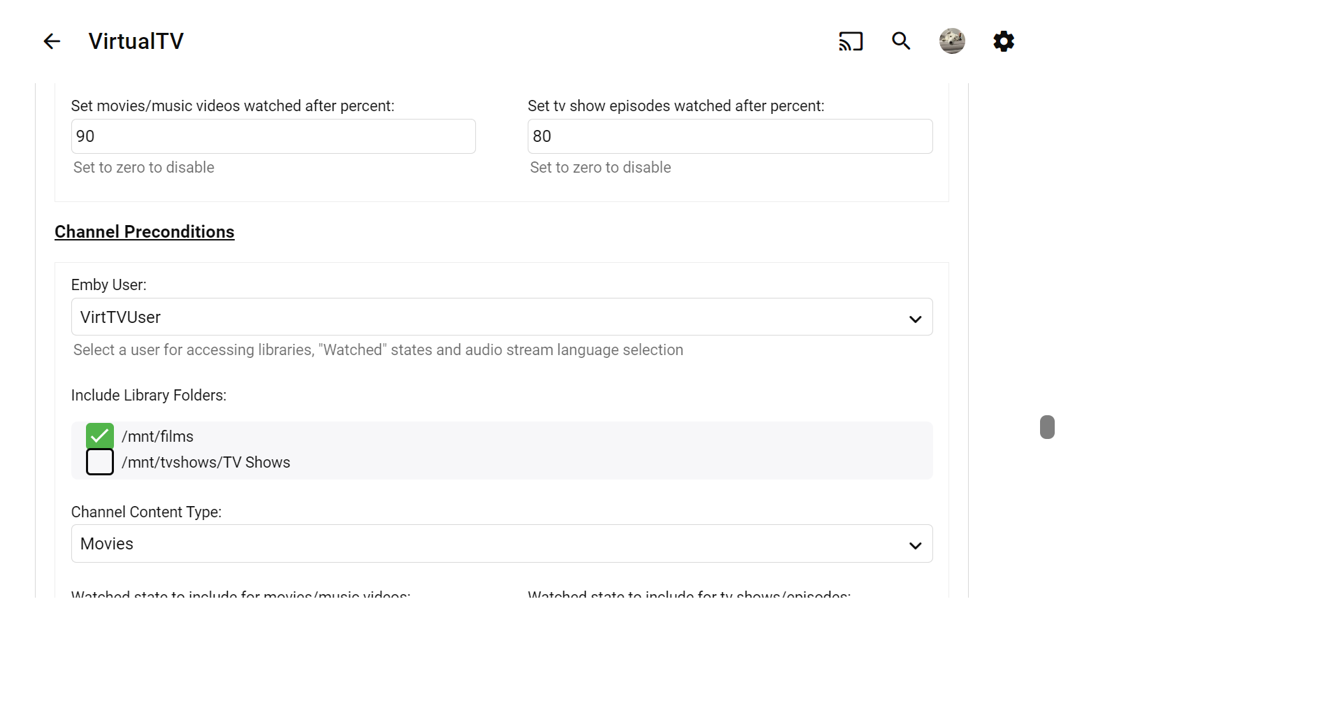

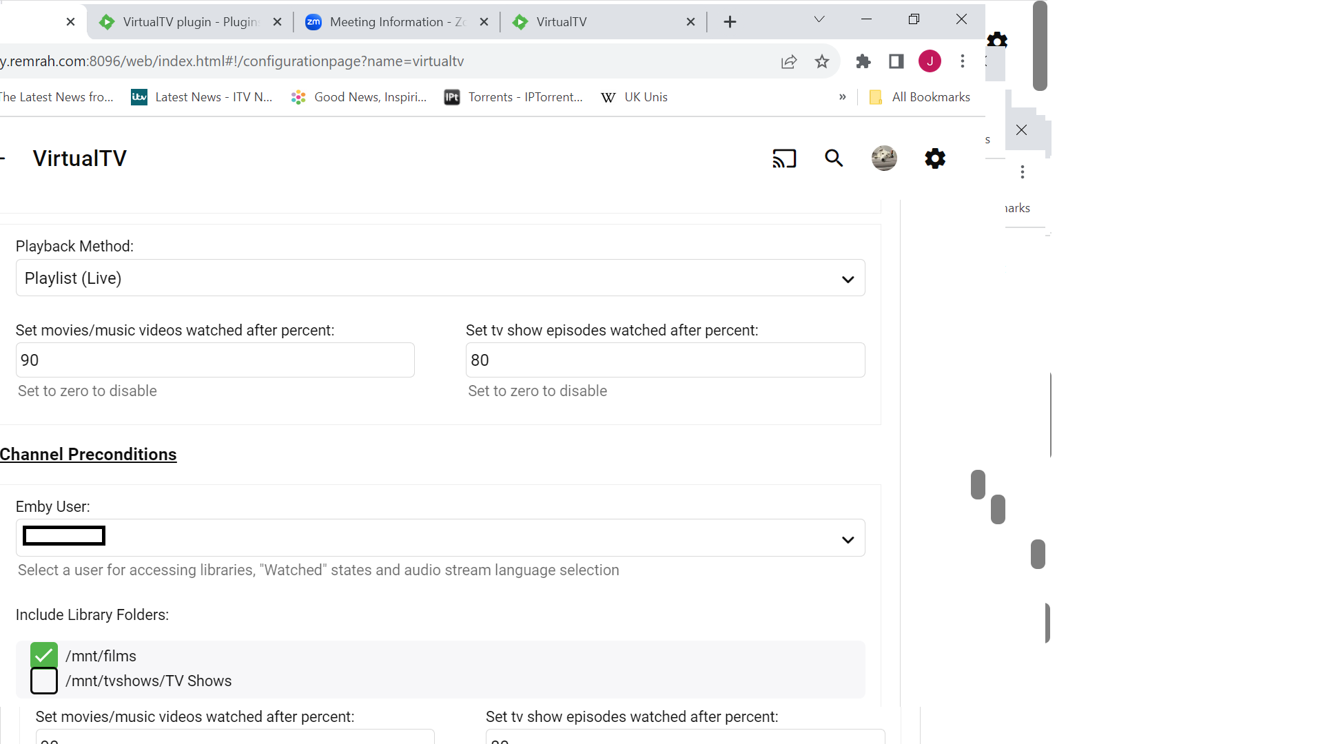

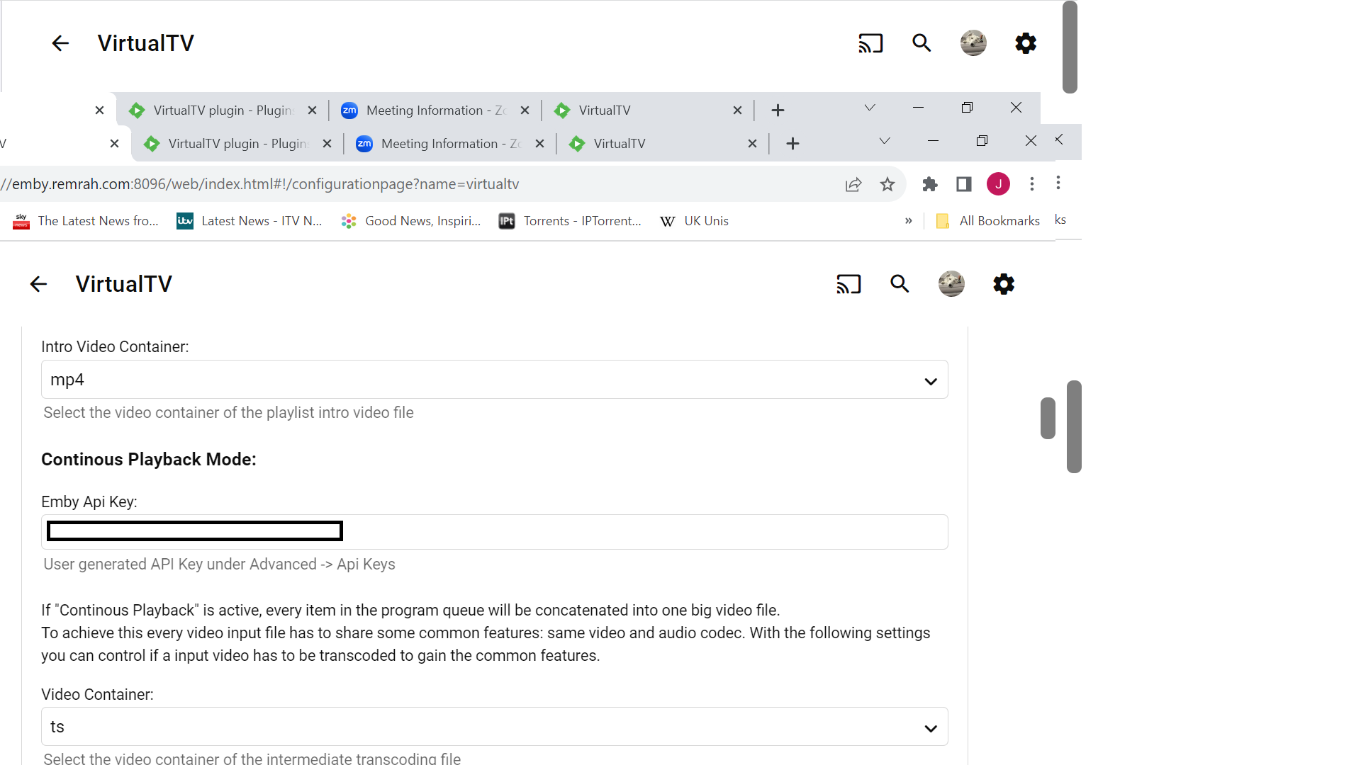

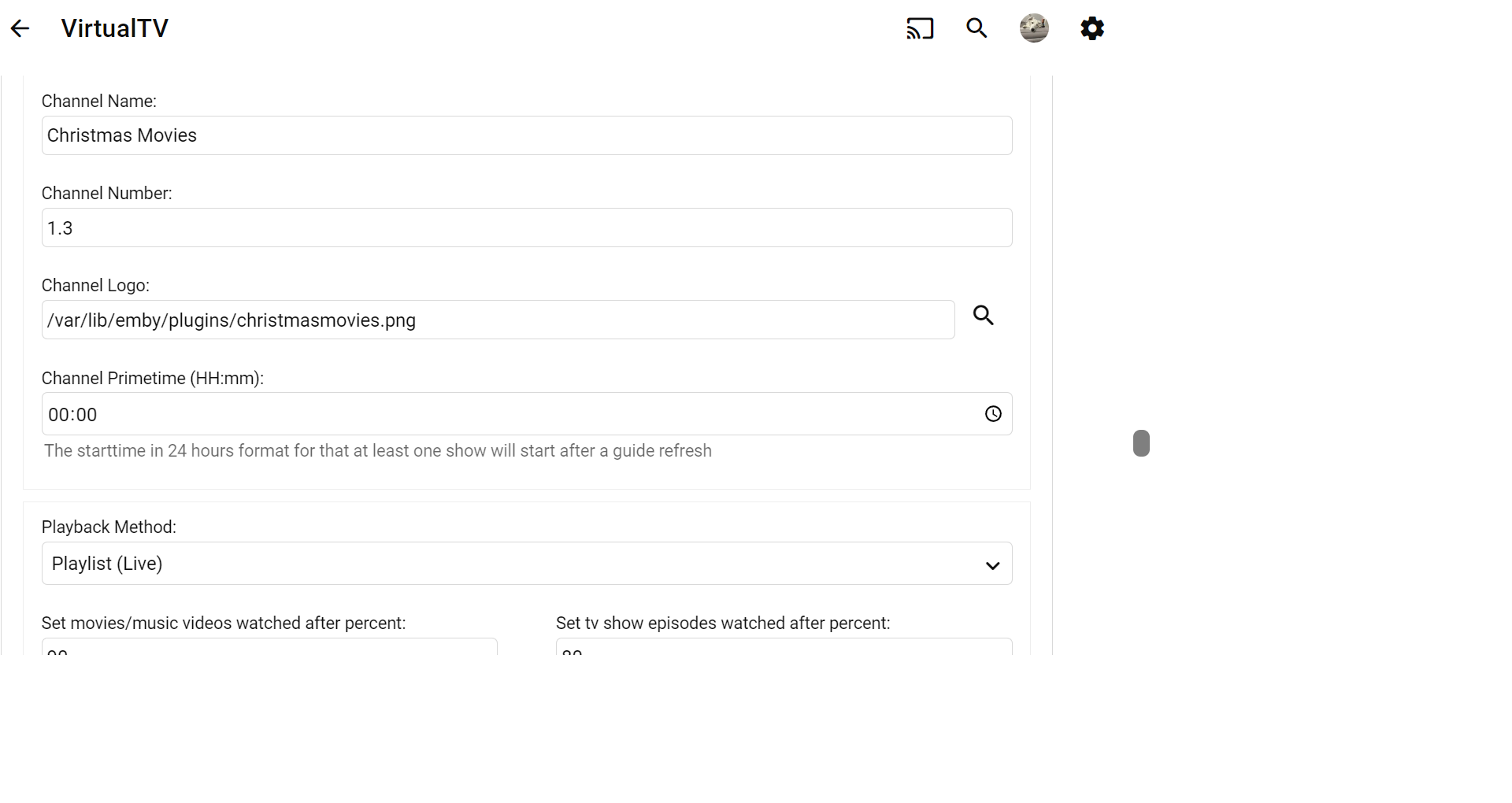

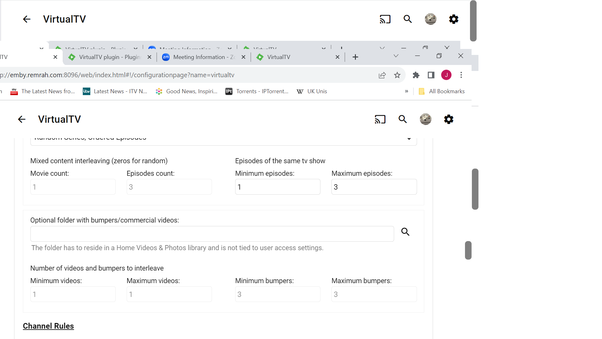

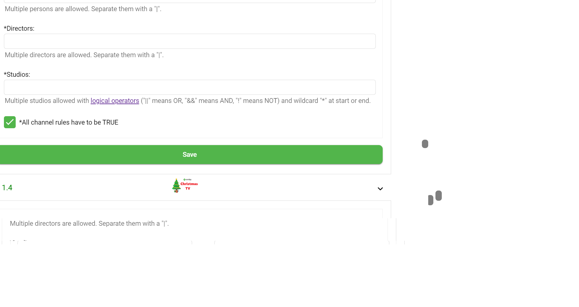

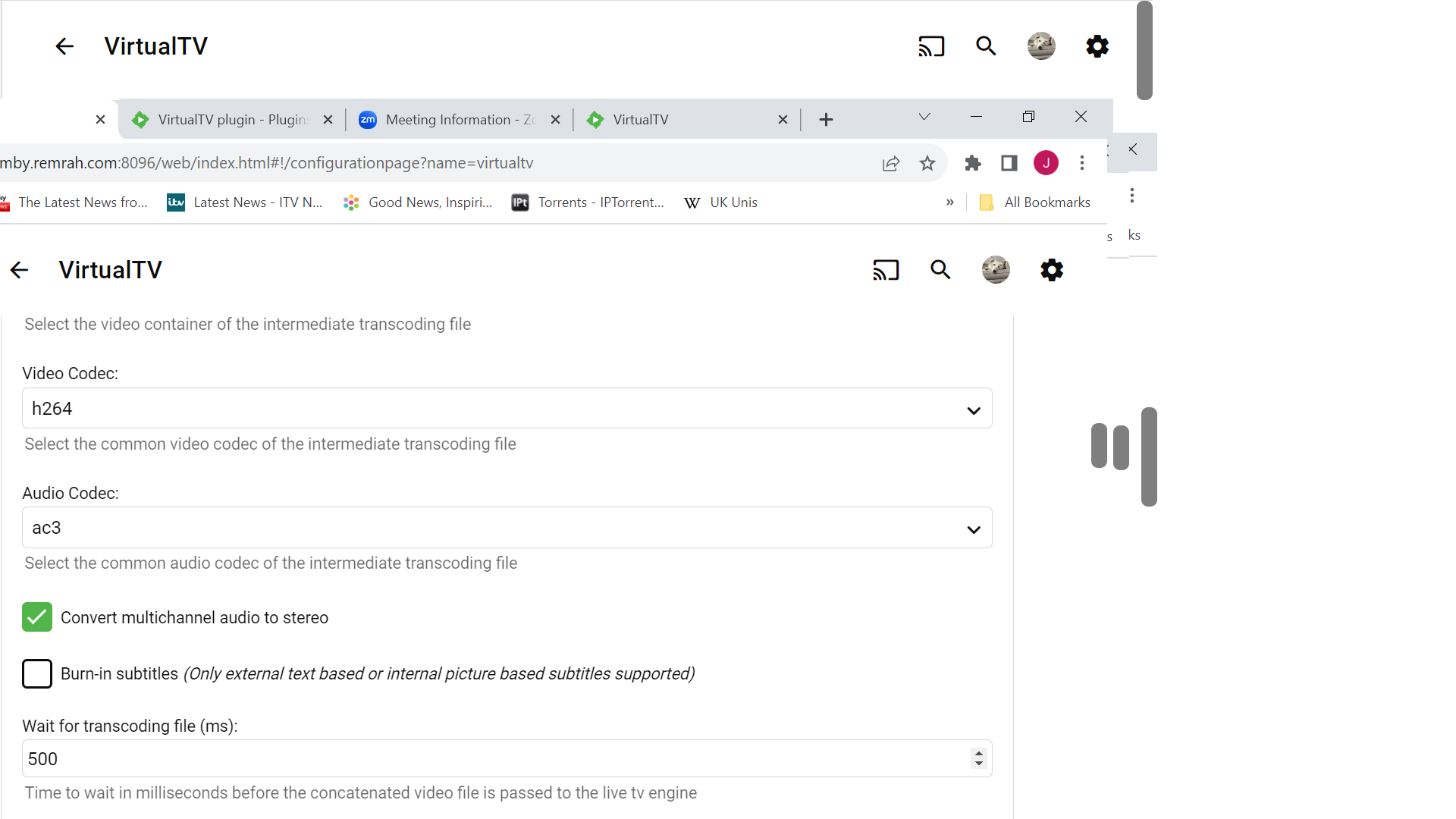

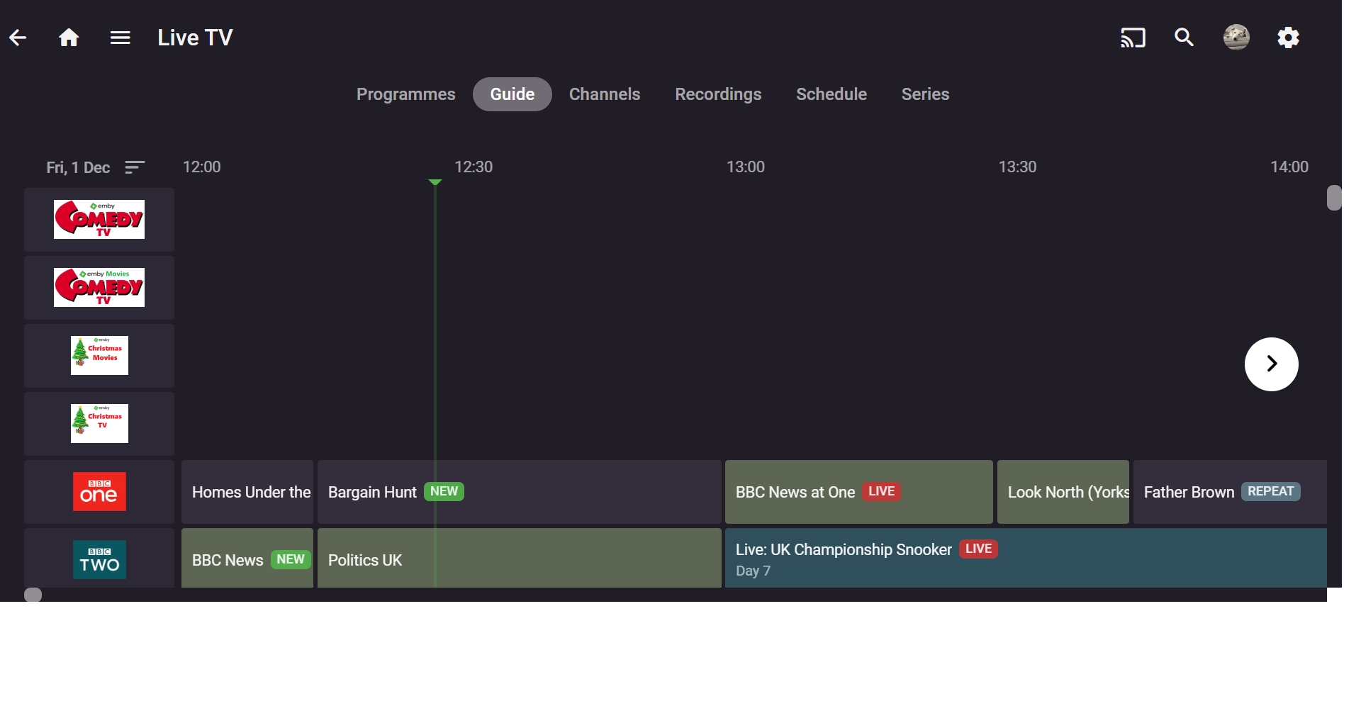

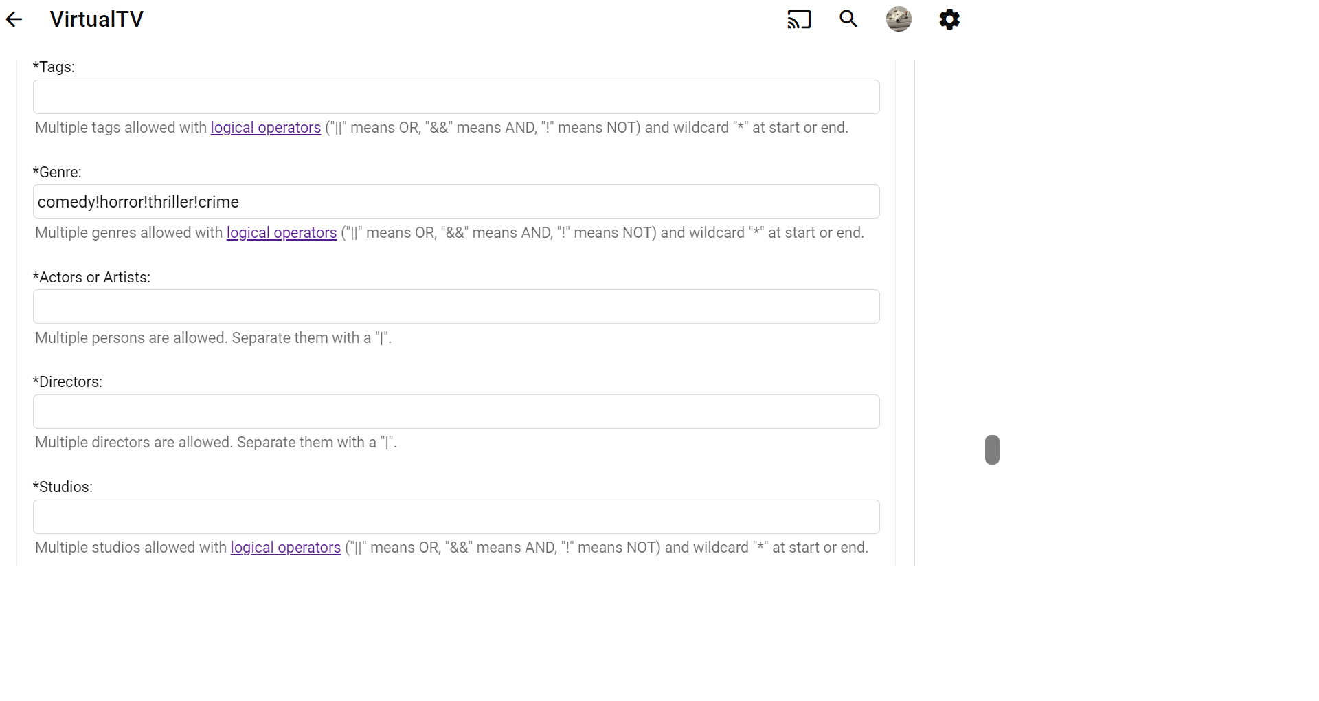

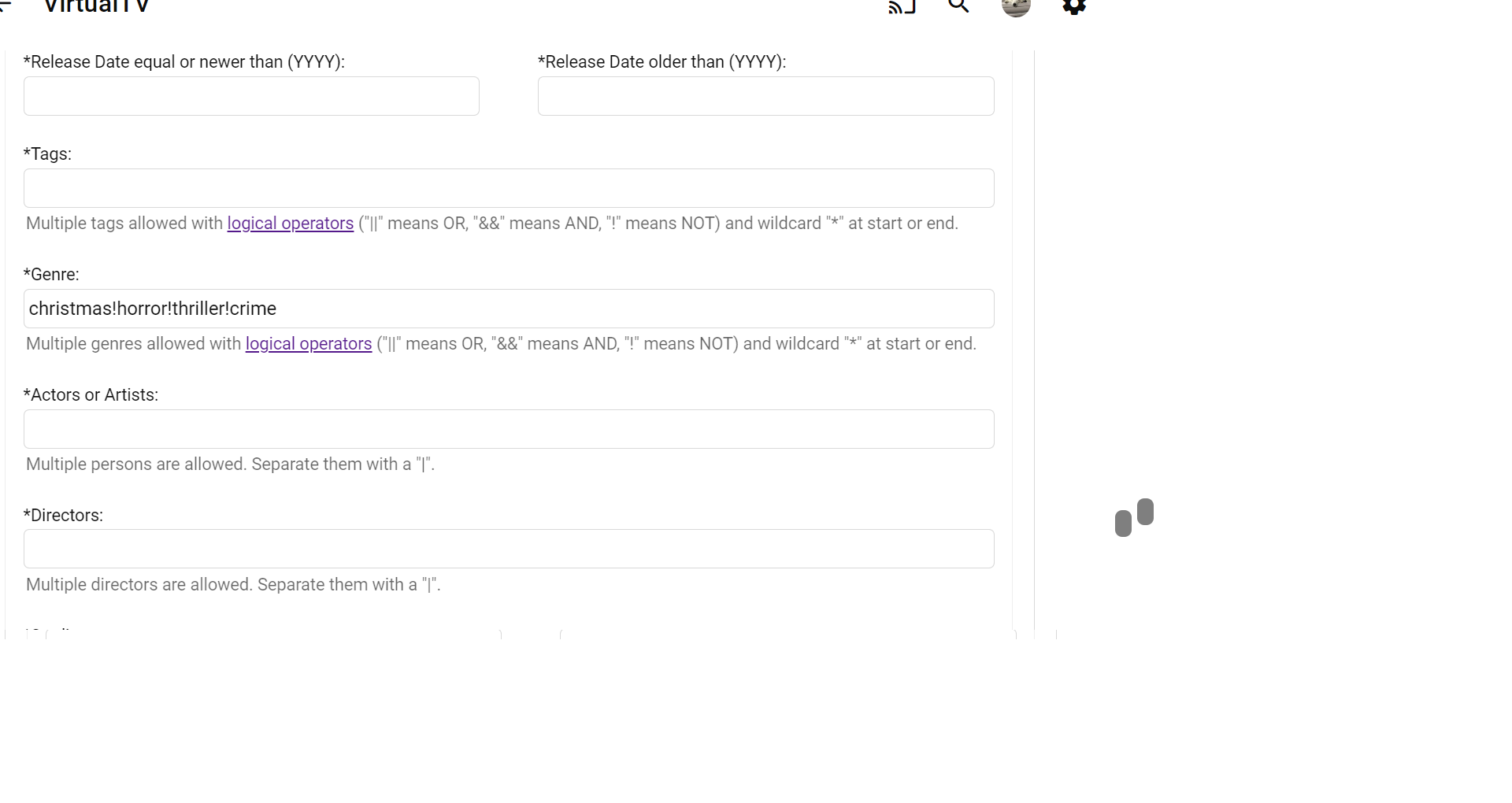

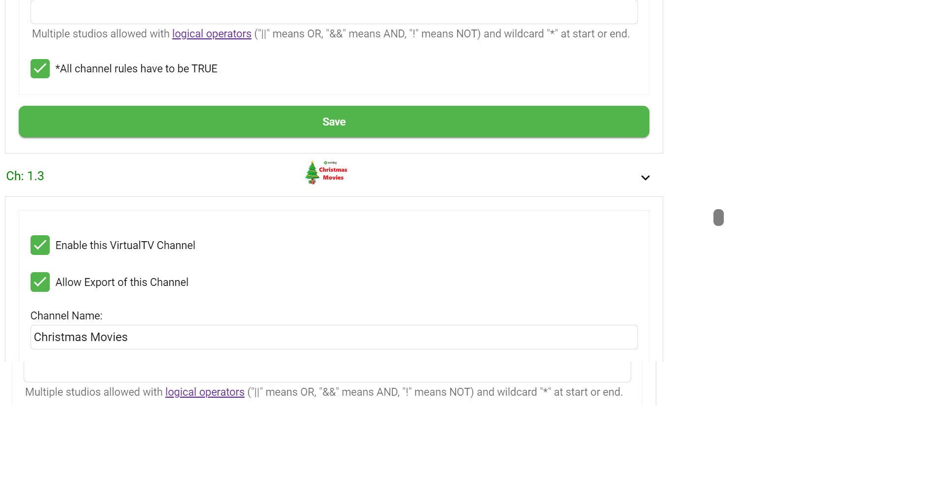

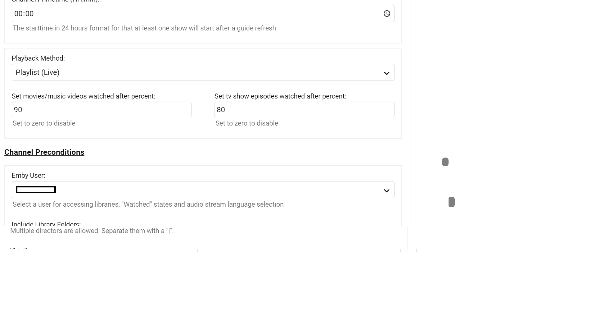

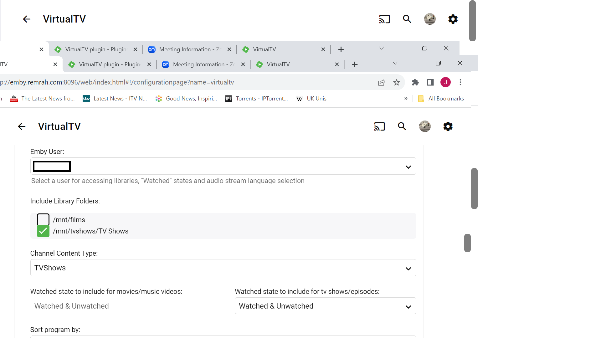

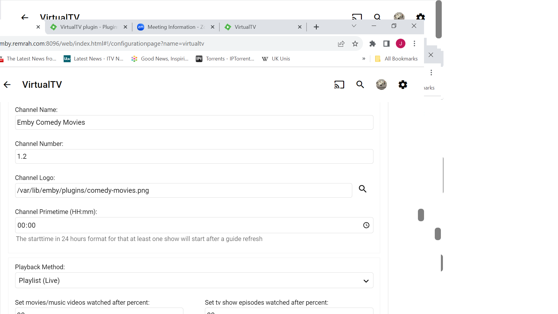

JuJuJurassic 50 Posted December 1, 2023 Posted December 1, 2023 (edited) Could I ask for a little help? I've been at this for days. I've set up virtual tv version VirtualTV.1.1.3.2_Emby.4.7.x.zip on Emby Version 4.7.14.0 . I'm running it on Ubuntu 20.04, and have copied VirtualTV.dll to root@emby:/var/lib/emby/plugins. I've set up 4 channels, Comedy TV, Comedy Movies, Christmas TV and Christmas Movies. I used the brilliant "Bulky" plugin to create the Christmas genre. When I play any of the channels I always get the same tv episodes. The movie channels don't play movies, just the same TV channels as the TV virtual channel. The TV guide is empty To save power, the Emby server is turned off at 1:30 am and on again between 4-6 pm. Things I've tried; I've forced the refresh of the "Live TV Refresh guide" Deleted and recreated the channels Looked through the emby logs. I can't find any errors relevant (I was setting up SSL, but have to finish that off, so its http which works fine for now" I've put some screenshots below of my system. V01 and V02 are what I see from the "live TV" side V1-39 are the setup of my Virtual TV. The screenshots seem to be in reverse order, look at them from the bottom up, that's my Virtual TV config. If you can help me I'd be grateful, I'd really like to get this working. Thanks embyserver.txt Edited December 1, 2023 by JuJuJurassic
pünktchen 1411 Posted December 1, 2023 Author Posted December 1, 2023 @JuJuJurassicYour genre conditions are wrong. It has to be Christmas && !Horror && !Thriller && !Crime. Similar for your Comedy channel.
JuJuJurassic 50 Posted December 1, 2023 Posted December 1, 2023 Brilliant pünktchen, thank you so much. I hope you have a great weekend
