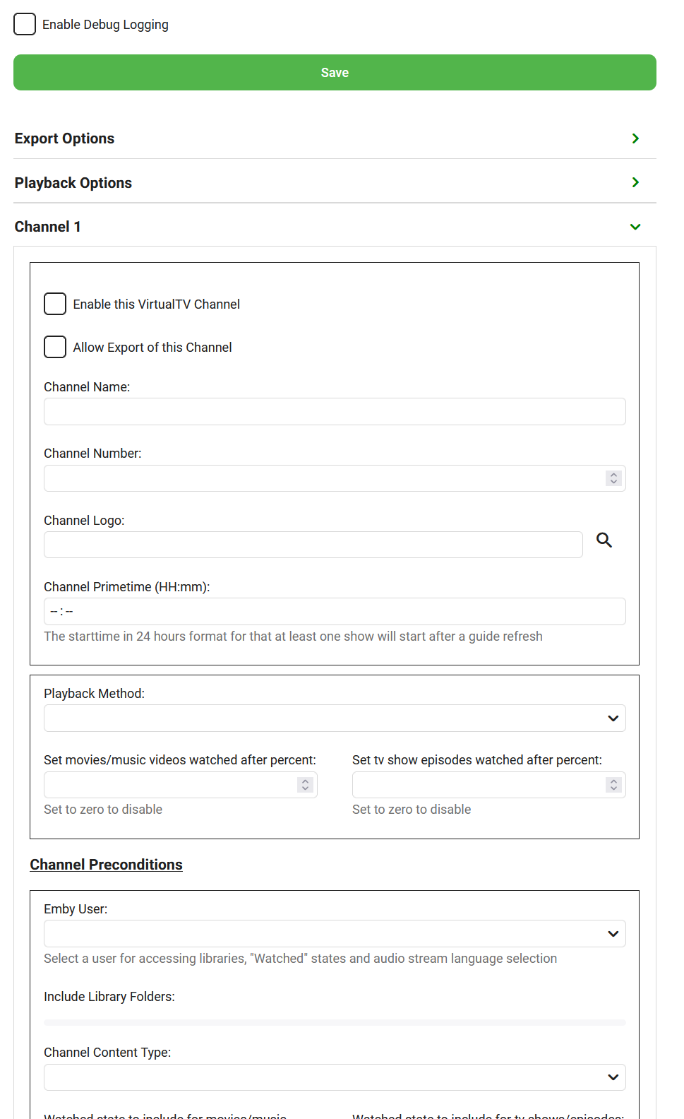

vislade 0 Posted October 21, 2023 Posted October 21, 2023 (edited) So I am just trying to make a genre specific channel, I've made channels with specific movies or shows and it works just fine, but when I try to just have a comedy channel when I put comedy in the Genres section when it builds the channel it just takes every show/movie from that folder instead of just the ones with comedy genre. I assume I am doing something wrong Edited October 21, 2023 by vislade

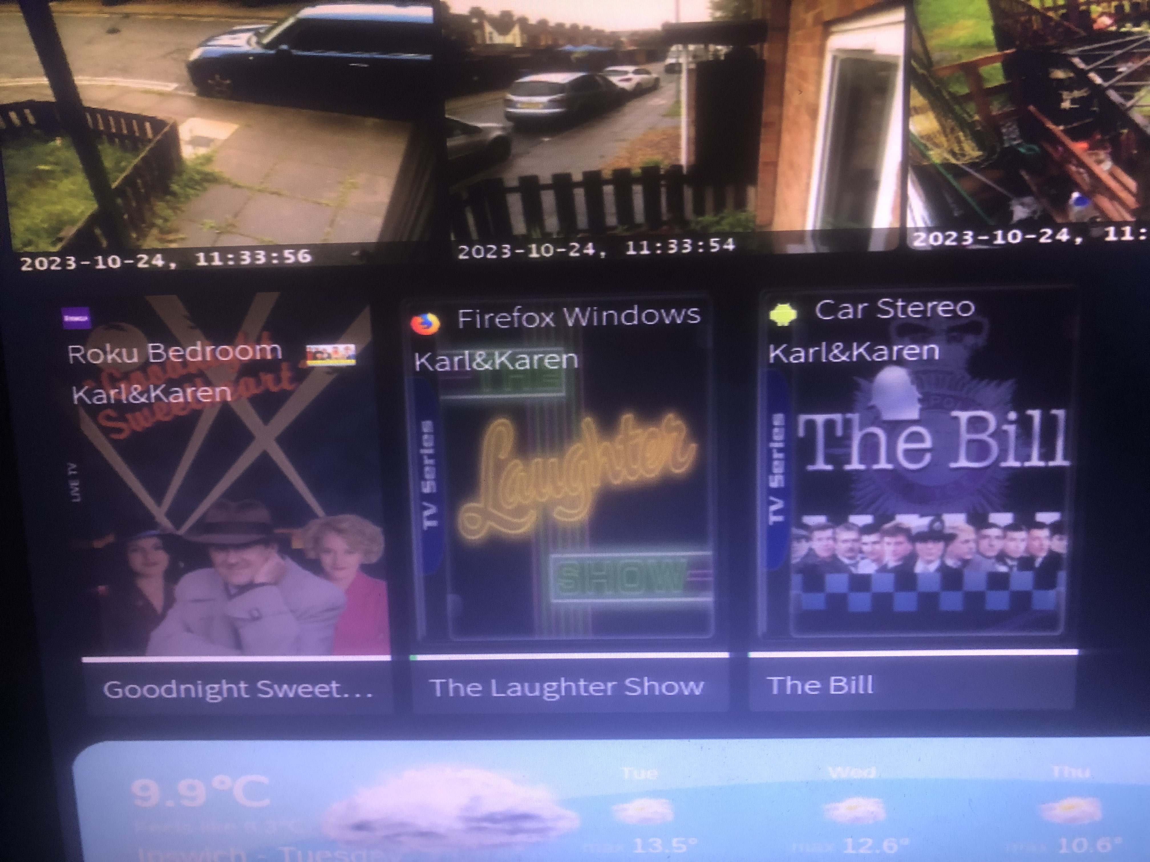

kjhedges 67 Posted October 24, 2023 Posted October 24, 2023 This question is for both Plugin Dev and Emby Devs. I use the http://xx.xx.xx.xx:8096/Sessions?api_key=xxxxxxxxxxxxxxxxx to gather current playing status, and with some coding display the content onto an information board that i have on a monitor. Now, the item on the Roku is a Virtual TV channel, the other 2 are normal emby play media. The VirtualTV item will display the item poster from the very first item that was in the channel list when playing starts and never updates to the new media item poster when the next tv episode or movie starts. Even when i point web browser to http://xx.xx.xx.xx:8096/Sessions?api_key=xxxxxxxxxxxxxxxxx it shows the current playing item as the first media item that was first played in the channel list.
mike3821 67 Posted October 25, 2023 Posted October 25, 2023 How can I use tags? I'm adding the tag name under the channel rules, but nothing ever populates after a refresh of the guide. The tag is for a Movie Collection of christmas movies.
hstamas 179 Posted October 25, 2023 Posted October 25, 2023 1 hour ago, mike3821 said: How can I use tags? I'm adding the tag name under the channel rules, but nothing ever populates after a refresh of the guide. The tag is for a Movie Collection of christmas movies. Try looking here @mike3821. I struggled with the tag syntax for awhile but @pünktchenspelled it out for me.
kjhedges 67 Posted October 27, 2023 Posted October 27, 2023 If I watch a VirtualTV Live channel from 1 program to the next, should the http://xx.xx.xx.xx:8096/Sessions?api_key=xxxxxxxxxxxxxxxxx data update when one program finishes and the next program starts?
pünktchen 1411 Posted October 27, 2023 Author Posted October 27, 2023 11 minutes ago, kjhedges said: If I watch a VirtualTV Live channel from 1 program to the next, should the http://xx.xx.xx.xx:8096/Sessions?api_key=xxxxxxxxxxxxxxxxx data update when one program finishes and the next program starts? It depends on the playback mode. Yes for Playlist, no for Continuous.
kjhedges 67 Posted October 27, 2023 Posted October 27, 2023 1 minute ago, pünktchen said: It depends on the playback mode. Yes for Playlist, no for Continuous. Thank you for response, I use continuous, so that explains why my posters are not updating. I shall have to create a channel poster relevant to the channel and display that instead of primary image.
pünktchen 1411 Posted October 27, 2023 Author Posted October 27, 2023 1 hour ago, kjhedges said: Thank you for response, I use continuous, so that explains why my posters are not updating. I shall have to create a channel poster relevant to the channel and display that instead of primary image. Yes, because as you've recognized, you are playing a tv channel not a program. 1
