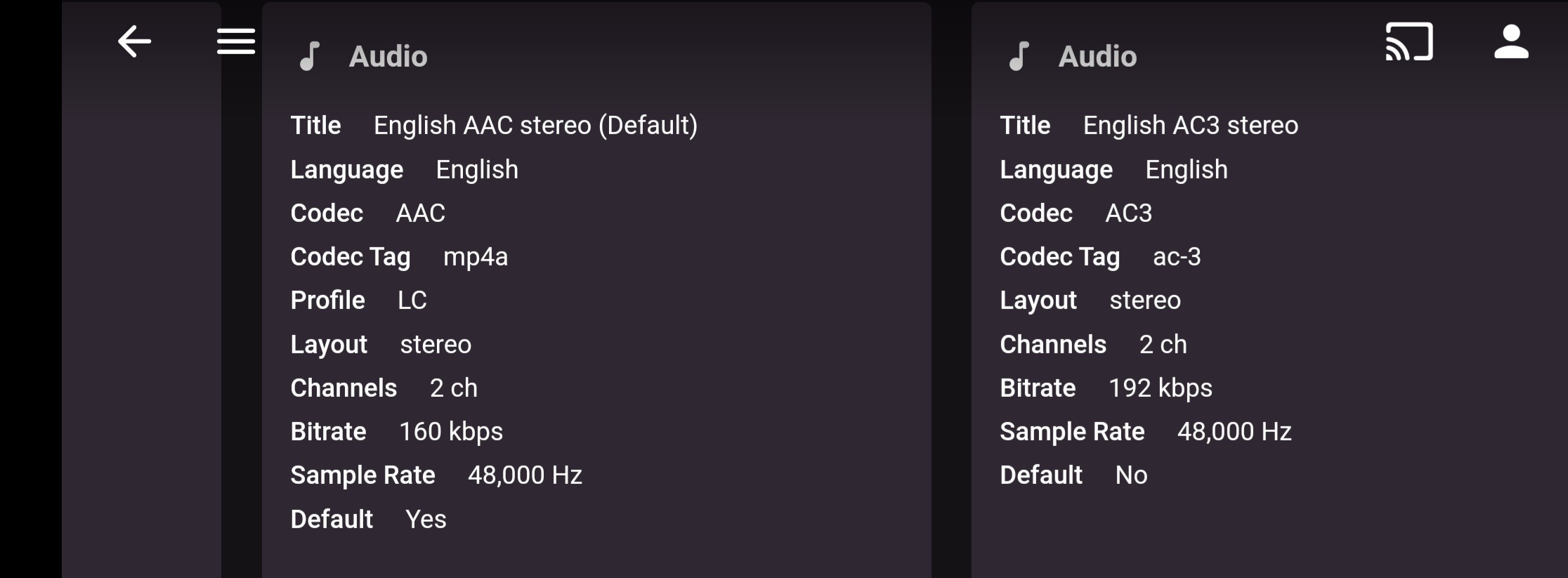

Ninko 78 Posted October 18, 2023 Posted October 18, 2023 7 hours ago, pünktchen said: Do both tracks have the same language tag? They do yes.
GrimReaper 4911 Posted October 18, 2023 Posted October 18, 2023 10 hours ago, Ninko said: I have my files set as stereo as the default track, but it looks as though the client is being sent the 5.1 track. Which client app?
Ninko 78 Posted October 18, 2023 Posted October 18, 2023 25 minutes ago, GrimReaper said: Which client app? Roku
GrimReaper 4911 Posted October 19, 2023 Posted October 19, 2023 On 10/18/2023 at 7:56 AM, Ninko said: Roku And have you enabled "Always play default audio track regardless of language" in Web app Playback settings, as Roku should inherit that?
Ninko 78 Posted October 19, 2023 Posted October 19, 2023 1 hour ago, GrimReaper said: And have you enabled "Always play default audio track regardless of language" in Web app Playback settings, as Roku should inherit that? I have, yes.
GrimReaper 4911 Posted October 19, 2023 Posted October 19, 2023 5 minutes ago, Ninko said: I have, yes. Then this: On 10/17/2023 at 9:21 PM, Ninko said: I have my files set as stereo as the default track, but it looks as though the client is being sent the 5.1 track. should not be occurring. Dose same happen on normal playback, outside of VirtualTV?
Ninko 78 Posted October 19, 2023 Posted October 19, 2023 Not according to stats for nerds no, outside of virtual TV it's using stereo, as it should.
GrimReaper 4911 Posted October 19, 2023 Posted October 19, 2023 4 minutes ago, Ninko said: Not according to stats for nerds no, outside of virtual TV it's using stereo, as it should. In that case wild guess would be faulty logic in either streams querying process plugin-side or decision making process server-side; possibly debug log might offer some insight, @pünktchen? Which playback mode you're using?
pünktchen 1411 Posted October 19, 2023 Author Posted October 19, 2023 23 minutes ago, GrimReaper said: Which playback mode you're using? That's a really important question!
Ninko 78 Posted October 19, 2023 Posted October 19, 2023 I'm using Continuous Playback (Live). Thanks
GrimReaper 4911 Posted October 19, 2023 Posted October 19, 2023 2 minutes ago, Ninko said: I'm using Continuous Playback (Live). Shouldn't "Convert multichannel audio to stereo" in plugin Playback Options take care of your issue for that mode?
Ninko 78 Posted October 19, 2023 Posted October 19, 2023 I've tried that, didn't appear to make any difference. Plus, what's the point of converting 5.1 to stereo when there's already a stereo track there.
pünktchen 1411 Posted October 19, 2023 Author Posted October 19, 2023 1 hour ago, Ninko said: I'm using Continuous Playback (Live). Thanks Then then audio settings have to be made for the user profile that you've choosen for the library selection in the plugin, not for the user who will play it in the apps. Provided that are different users!
pünktchen 1411 Posted October 19, 2023 Author Posted October 19, 2023 1 hour ago, Ninko said: I've tried that, didn't appear to make any difference. I will check that. 1
Ninko 78 Posted October 19, 2023 Posted October 19, 2023 34 minutes ago, pünktchen said: Then then audio settings have to be made for the user profile that you've choosen for the library selection in the plugin, not for the user who will play it in the apps. Provided that are different users! I've checked and the user selected in virtual TV settings has "Always play default audio track regardless of language" selected also.
Junglejim 385 Posted October 20, 2023 Posted October 20, 2023 22 hours ago, Ninko said: I've tried that, didn't appear to make any difference. Plus, what's the point of converting 5.1 to stereo when there's already a stereo track there. Are you sure the stereo track is default for said video? From memory the live playback mode will transcode (that's why I use archive), maybe the transcode process could be the problem? Just a guess..
Ninko 78 Posted October 20, 2023 Posted October 20, 2023 I'm sure the stereo track is default yes. I've just tried changing it to archive, but it still does the same thing. Is there any information or screenshots I can give that may help? Thanks
pünktchen 1411 Posted October 20, 2023 Author Posted October 20, 2023 10 minutes ago, Ninko said: Is there any information or screenshots I can give that may help? MediaInfo screenshot.
Junglejim 385 Posted October 20, 2023 Posted October 20, 2023 12 minutes ago, Ninko said: I'm sure the stereo track is default yes. I've just tried changing it to archive, but it still does the same thing. Is there any information or screenshots I can give that may help? Thanks A screenshot with Mkvtoolnix could help, that's if it's a mkv container.. I can't remember the equivalent for mp4. As @pünktchenmentioned MediaInfo would have some useful info..
pünktchen 1411 Posted October 20, 2023 Author Posted October 20, 2023 @NinkoEither change the view in MediaInfo to Tree or post the media item details from within Emby. We can't see what is the default audio track.
