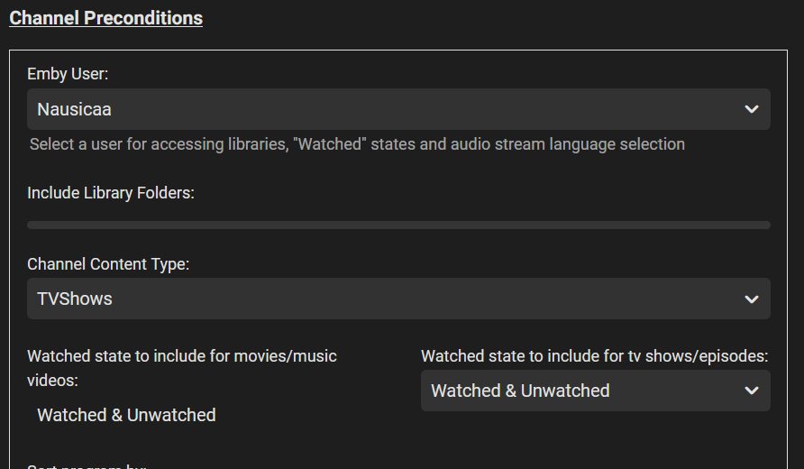

jiggity 35 Posted July 28, 2023 Posted July 28, 2023 (edited) 46 minutes ago, pünktchen said: 1 hour ago, pünktchen said: No, i'm talking about this setting: I tried with that setting enabled, and I still only get the 2.5 days worth of content. Thanks for showing me that setting 46 minutes ago, pünktchen said: I've checked that again. It should already be possible with the sort option "Random Series, Ordered Episodes" even if there's only one show for the channel. That setting does allow for the majority of the episodes to play in list order, but it breaks the insertion of specials in the proper place. With it set that way it plays specials, then seasons 1-7. It still only generates the 2.5 days worth of content and no repeating. I have the number of days in the Live TV setting manually set to 7. I can show you how I have this channel set up with screens if that would help. I really appreciate your help with this, I understand this is a bit of an edge case request. Edited July 28, 2023 by jiggity added one too mnay quotes, couldn't fully remove one of them
pünktchen 1411 Posted July 28, 2023 Author Posted July 28, 2023 12 minutes ago, jiggity said: That setting does allow for the majority of the episodes to play in list order, but it breaks the insertion of specials in the proper place. With it set that way it plays specials, then seasons 1-7. Hah, you never talked about specials! 17 minutes ago, jiggity said: It still only generates the 2.5 days worth of content and no repeating. I have the number of days in the Live TV setting manually set to 7. And of course you did execute the refresh guide task after that?! 18 minutes ago, jiggity said: I can show you how I have this channel set up with screens if that would help. Maybe. It will not hurt.
jiggity 35 Posted July 28, 2023 Posted July 28, 2023 48 minutes ago, pünktchen said: Hah, you never talked about specials! And of course you did execute the refresh guide task after that?! Maybe. It will not hurt. Yes, my bad I did not mention specials. Sorry. I did execute the refresh after changing any setting to see if there was any change Here come some pictures:
pünktchen 1411 Posted July 29, 2023 Author Posted July 29, 2023 3 hours ago, jiggity said: I did execute the refresh after changing any setting to see if there was any change Here come some pictures Exactly those settings are working fine for me. Please restart Emby and refresh the guide once more.
