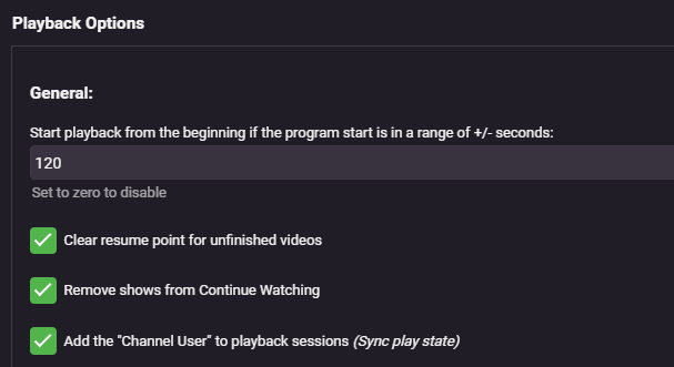

ITGuy1024 18 Posted July 26, 2023 Posted July 26, 2023 New question - is there any other way to remove the shows played with the plugin from Continue Watching? I have this box checked but it isn't working. 1
pünktchen 1411 Posted July 26, 2023 Author Posted July 26, 2023 1 hour ago, ITGuy1024 said: New question - is there any other way to remove the shows played with the plugin from Continue Watching? I have this box checked but it isn't working. What are your channel settings for "Set ... watched after percent"?
jiggity 35 Posted July 26, 2023 Posted July 26, 2023 Hi, Love the plug in, but it freezes up doing the refresh guide often, with very little to no info in the log, and I have the debug option enabled This is the last entry before refresh freezes at 15% 2023-07-26 15:48:52.650 Info VirtualTV: TVService > GetPrograms: Channel: Drama, ChannelId: VirtualTV8, Returning 391 Movies 2023-07-26 15:48:52.742 Info SqliteItemRepository: Removing 390 old programs from channel 1131611 Drama 2023-07-26 15:48:53.295 Info VirtualTV: TVService > GetPrograms: Channel: Music, ChannelId: VirtualTV9, Querying Library for MixedContent After that there are no more virtual tv log entries. the next log entry is 2023-07-26 15:48:54.754 Info Server: http/1.1 POST http://host1:8096/emby/Sessions/Playing/Progress?X-Emby-Client=Emby Theater&X-Emby-Device-Name=clientname&X-Emby-Device-Id=clientname&X-Emby-Client-Version=3.0.20&X-Emby-Language=en-us&reqformat=json. UserAgent: Mozilla/5.0 (Windows NT 10.0; Win64; x64) AppleWebKit/537.36 (KHTML, like Gecko) EmbyTheater/3.0.20 Chrome/87.0.4280.141 Electron/11.5.0 Safari/537.36 with just client info following Any help is appreciated
ITGuy1024 18 Posted July 26, 2023 Posted July 26, 2023 8 hours ago, pünktchen said: What are your channel settings for "Set ... watched after percent"? 80
pünktchen 1411 Posted July 27, 2023 Author Posted July 27, 2023 8 hours ago, jiggity said: 2023-07-26 15:48:53.295 Info VirtualTV: TVService > GetPrograms: Channel: Music, ChannelId: VirtualTV9, Querying Library for MixedContent You have music videos or music concerts in a mixed content library? How are they organized, as movies or tv shows? 1
pünktchen 1411 Posted July 27, 2023 Author Posted July 27, 2023 7 hours ago, ITGuy1024 said: 80 With that and the other settings it should remove your videos from Continue Watching. Are you on Emby beta server? There are several other threads about problems with Continue Watching and the beta server.
ITGuy1024 18 Posted July 27, 2023 Posted July 27, 2023 5 hours ago, pünktchen said: With that and the other settings it should remove your videos from Continue Watching. Are you on Emby beta server? There are several other threads about problems with Continue Watching and the beta server. Nah I don't run the betas.
pünktchen 1411 Posted July 27, 2023 Author Posted July 27, 2023 1 hour ago, ITGuy1024 said: Nah I don't run the betas. Then as usual: enable debug logging, replicate the problem and pm me the log.
