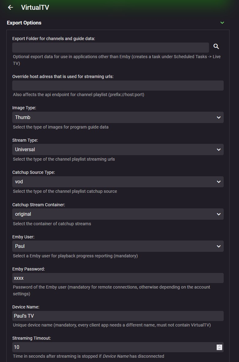

Ninko 78 Posted May 8, 2023 Posted May 8, 2023 @pünktchenCould you explain the export options please? Thanks
pünktchen 1411 Posted May 8, 2023 Author Posted May 8, 2023 26 minutes ago, Ninko said: @pünktchenCould you explain the export options please? Thanks Which ones exactly?
Ninko 78 Posted May 8, 2023 Posted May 8, 2023 Override host address that is used for streaming URLs? Stream type? Catchup source type? Catchup stream container? Emby user? Emby password? Device name? Token?

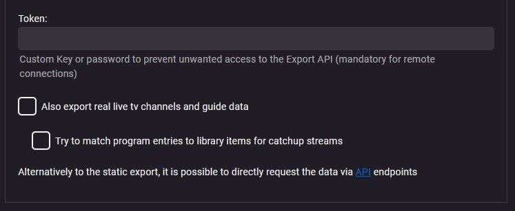

pünktchen 1411 Posted May 8, 2023 Author Posted May 8, 2023 C'mon, that are nearly all options. Are you kidding me? Stream type: EmbyCon and EmbyNextGen is for Kodi only Catchup source type: If you don't know what it is, then it's of no interest for you Emby user and password: Should be self explanatory. It's used for playback progress reporting Device name: VLC, Tivimate or whatever. A device with this name is created in Emby's device list. The Emby user has to be granted to use this device. Token: Just some additional custom security string (password like) to protect the web api endpoints
Ninko 78 Posted May 9, 2023 Posted May 9, 2023 7 hours ago, pünktchen said: C'mon, that are nearly all options. Are you kidding me? Stream type: EmbyCon and EmbyNextGen is for Kodi only Catchup source type: If you don't know what it is, then it's of no interest for you Emby user and password: Should be self explanatory. It's used for playback progress reporting Device name: VLC, Tivimate or whatever. A device with this name is created in Emby's device list. The Emby user has to be granted to use this device. Token: Just some additional custom security string (password like) to protect the web api endpoints That's not really the attitude as a plugin developer is it? I'm trying to make a plugin that YOU made work at the end of the day. Maybe you should try to help the users of YOUR plugin rather then just assuming they know everything about YOUR plugin!
pünktchen 1411 Posted May 9, 2023 Author Posted May 9, 2023 Don't be so oversensitive! Didn't i help you anyway? Btw. me the plugin developer, i've written the plugin mainly for myself, not for others. If others find it usefull - great. If not, it doesn't matter either.
Ninko 78 Posted May 9, 2023 Posted May 9, 2023 I'm not being oversensitive, you've basically just called me stupid just because I wasn't sure what all the options did and if they could help with my problem!
pünktchen 1411 Posted May 9, 2023 Author Posted May 9, 2023 12 minutes ago, Ninko said: I wasn't sure what all the options did and if they could help with my problem I do not even know what are trying to achive now. Yesterday it was a problem with browsers and Roku. How can the export option help you there? If you tell me what you want to do now, maybe i can tell you if it's possible at all.
Ninko 78 Posted May 9, 2023 Posted May 9, 2023 I wasn't sure if any of those options would fix the problem with Roku, as many of them mentions "remote connections". From what you're saying, they have nothing to do with it, but I don't know unless I ask, as I didn't make the plugin.
pünktchen 1411 Posted May 9, 2023 Author Posted May 9, 2023 1 hour ago, Ninko said: I wasn't sure if any of those options would fix the problem with Roku, as many of them mentions "remote connections". From what you're saying, they have nothing to do with it Correct. The export are options are for using the data in non Emby apps. The only thing that currently will work for Roku remote connections, is Continous Playback mode. Unfortunately it will often require transcoding of the videos and you cannot set this playback mode only for Roku devices.

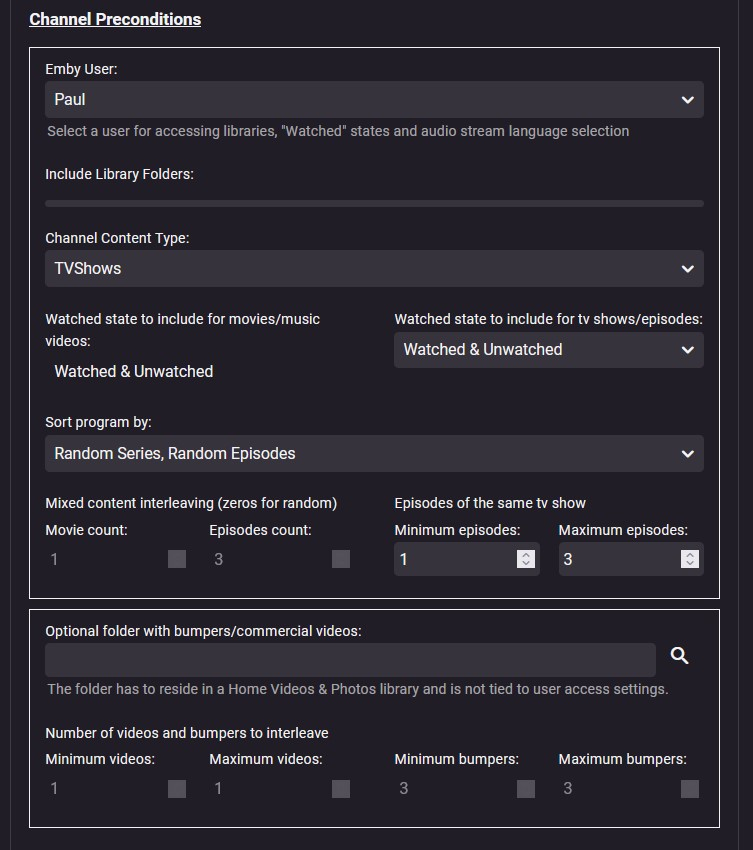

jordy 284 Posted July 17, 2023 Posted July 17, 2023 Hi, Just trying to get this plugin to work on my Windows 11 machine running EmbyServer Beta 4.8.0.39 I cannot get a channel to populate. I'm not sure but it may be that I don't see any library folders in the "Channel Preconditions" section. Can you please advise what if anything I need to change to make it work Debugging Does not show any errors - just says...: 2023-07-17 13:20:43.733 Info VirtualTV: TVService > GetPrograms: Channel: Paul's TV, ChannelId: VirtualTV0, Querying Library for TVShows 2023-07-17 13:20:43.758 Info VirtualTV: TVService > GetLibraryItems: No TVShow Items match the Channel Conditions 2023-07-17 13:20:43.758 Info VirtualTV: TVService > GetPrograms: Channel: Paul's TV, ChannelId: VirtualTV0, Returning 0 TVShows 2023-07-17 13:20:43.758 Debug LiveTvManager: Channel Paul's TV has 0 programs
