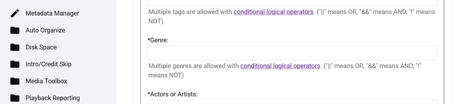

sirmiketr 5 Posted February 26, 2023 Posted February 26, 2023 Hiya, I was wondering if you could help me with the Genre filtering, i'm trying to filter out any animation/family for a specific channel. I've been trying this way but I still get the genres: !Animation || !Comedy What would be the most optimal way to filter out multiple genres?
pünktchen 1411 Posted February 27, 2023 Author Posted February 27, 2023 On 2/26/2023 at 6:59 PM, sirmiketr said: I've been trying this way but I still get the genres: !Animation || !Comedy That's the correct syntax. Make sure you have "*All channel rules have to be TRUE" enabled.
