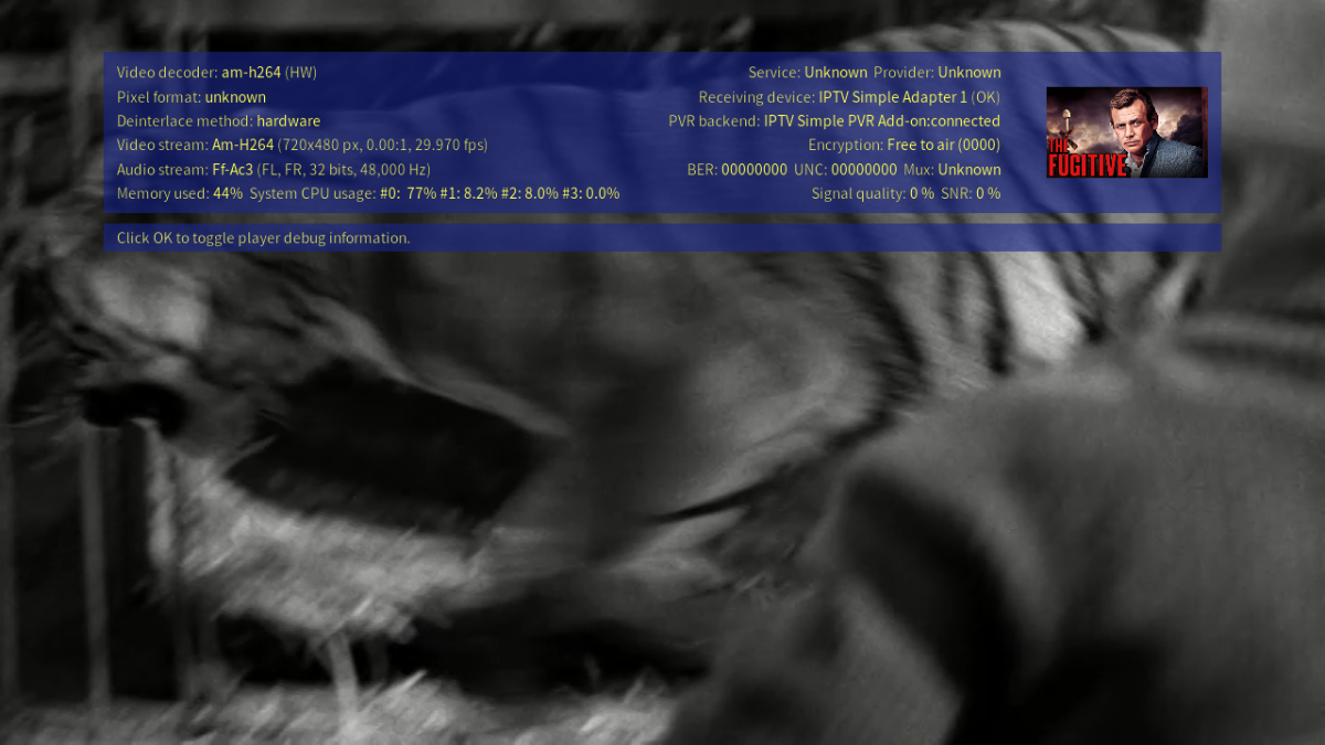

tuvx 15 Posted January 11, 2021 Posted January 11, 2021 On 11/8/2020 at 9:41 AM, rayw said: Thanks for the info, I'll await your update and then set my channels up properly. Having moved from Kodi to Emby I was really missing PseudoTV, but your plugin here looks fantastic from what I have used of it. Very easy to set up and a lovely enhancement to my setup. Thanks for your work. I would love to know how you got this to work in Kodi. When I try to open a virtual channel (in Kodi) I get a spinner for a few seconds then nothing; live tv channels work fine.
pünktchen 1411 Posted January 11, 2021 Author Posted January 11, 2021 59 minutes ago, tuvx said: I would love to know how you got this to work in Kodi. When I try to open a virtual channel (in Kodi) I get a spinner for a few seconds then nothing; live tv channels work fine. I'm using the IPTV Simple pvr addon in Kodi. You can import guide and channels there with the url's that are explained under the Export section of the plugin config.
tuvx 15 Posted January 11, 2021 Posted January 11, 2021 Ok, I will give it a shot. I was able to get them playing by switching to continuous mode, but all videos stutter (I checked the server and there is barely any GPU or CPU usage).
tuvx 15 Posted January 11, 2021 Posted January 11, 2021 1 hour ago, pünktchen said: I'm using the IPTV Simple pvr addon in Kodi. You can import guide and channels there with the url's that are explained under the Export section of the plugin config. Thank you for the tip, it worked. Any idea why 480p content stutters? I have tried Playlist and Continuous Playback (Live) without success.
pünktchen 1411 Posted January 11, 2021 Author Posted January 11, 2021 Playlist only works with Emby apps, it will fallback to Continous Mode with the Export feature. Why your channels do stutter, i don't know. I have many 480p tv shows and they run butter smooth. What video codec have your files?
tuvx 15 Posted January 11, 2021 Posted January 11, 2021 (edited) 6 hours ago, pünktchen said: What video codec have your files? A couple examples of problem videos which are unwatchable (will play choppy for a bit, then smooth, then I'll get a "Buffering" message, more choppy, etc). When playing the same video normally there are no issues. Title480p MPEG2VIDEO CodecMPEG2VIDEO ProfileMain Level8 Resolution720x480 Aspect Ratio279:157 InterlacedNo Framerate29.97 Bitrate5,202 kbps Bit Depth8 bit Pixel Formatyuv420p Reference Frames1 Title480i MPEG2VIDEO CodecMPEG2VIDEO ProfileMain Level8 Resolution720x480 Aspect Ratio4:3 InterlacedYes Framerate29.97 Bitrate4,698 kbps Bit Depth8 bit Pixel Formatyuv420p Reference Frames1 Edited January 11, 2021 by tuvx
tuvx 15 Posted January 11, 2021 Posted January 11, 2021 Here is a screen shot while playing a problematic video.
tuvx 15 Posted January 11, 2021 Posted January 11, 2021 This is playing the same video normally (not through Live TV:
tuvx 15 Posted January 11, 2021 Posted January 11, 2021 Well, that was a simple fix. I changed the setting for Accelerate h264 on for only HD and up. This is a great plugin, and glad someone took the initiative to create! 1
