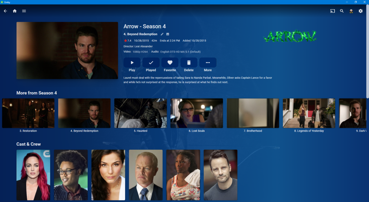

Emby Tower 34 Posted October 12, 2020 Posted October 12, 2020 (edited) 10 hours ago, pünktchen said: @Emby Tower Sort by PremiereDate is working fine here, so make sure all your single episodes really have a release date and not only a release year. I've installed the TimeMovies Plugins and the tasks runs every 15 minutes. I just checked it and all episodes have the correct release date. I don't know what's wrong (see screenshots)! Edited October 12, 2020 by Emby Tower

pünktchen 1411 Posted October 12, 2020 Author Posted October 12, 2020 (edited) @Emby Tower please try this one: Edited October 12, 2020 by pünktchen Removed attachment 1

Emby Tower 34 Posted October 12, 2020 Posted October 12, 2020 (edited) 31 minutes ago, pünktchen said: @Emby Tower please try this one: VirtualTV_0.9.0.5_Test.zip 91.72 kB · 1 download Thanks a lot, way much better now! There is still a problem, but I don't know if your plugin can solve this: My test channel, the Arrowverse, have some crossover episodes (like "Crisis on Earth-X), and the release dates are the same. And they aren't sorted correctly. Is it possible that the plugin detects episodes with the same title and sort them via their numbers? Thanks a lot! Edited October 12, 2020 by Emby Tower

pünktchen 1411 Posted October 12, 2020 Author Posted October 12, 2020 (edited) @Emby Tower another one: Edited October 12, 2020 by pünktchen Removed attachment 1
Emby Tower 34 Posted October 12, 2020 Posted October 12, 2020 2 minutes ago, pünktchen said: @Emby Tower another one: VirtualTV_0.9.0.5_Test.zip 91.8 kB · 0 downloads Thank you so much, works like a charm! Your plugin is a very big improvement for me...
