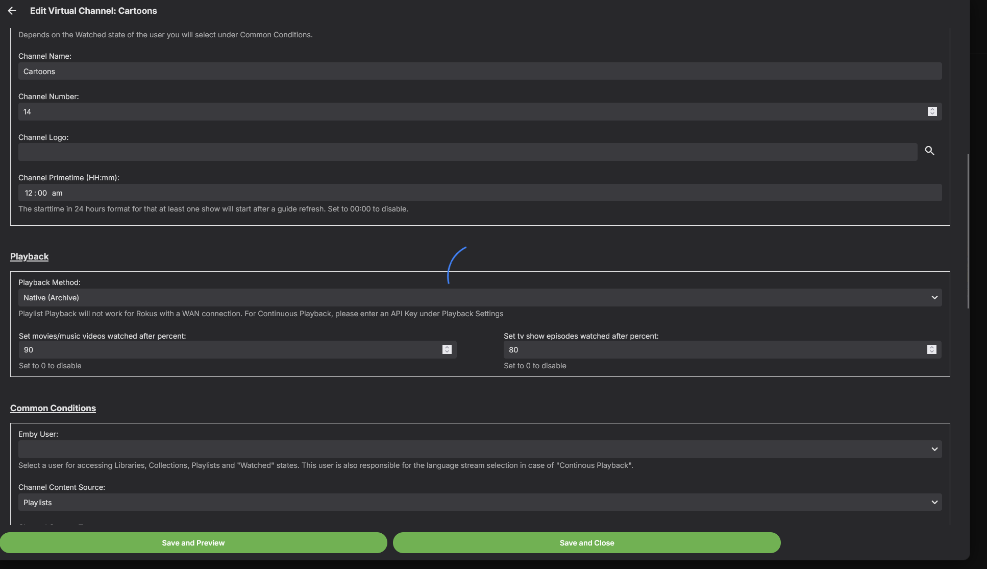

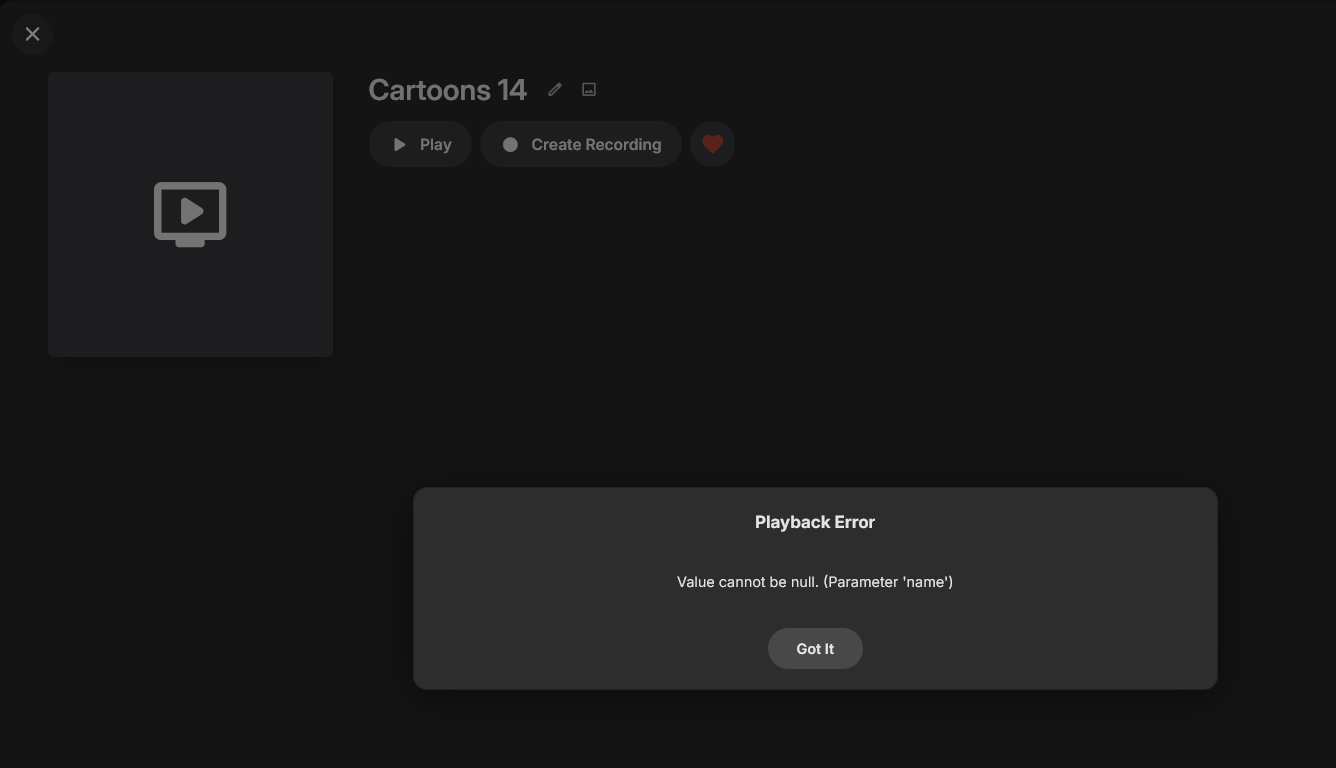

strichmo 21 Posted November 11, 2025 Posted November 11, 2025 I've just tried to set it up with a playlist and I get the following error:
pünktchen 1409 Posted November 11, 2025 Author Posted November 11, 2025 1 hour ago, strichmo said: I've just tried to set it up with a playlist and I get the following error: Your channel doesn't have any program data. Without that it will not work. Does the program preview in the channel config give you any results?
strichmo 21 Posted November 11, 2025 Posted November 11, 2025 3 hours ago, pünktchen said: Your channel doesn't have any program data. Without that it will not work. Does the program preview in the channel config give you any results? It just sits there loading forever:
pünktchen 1409 Posted November 11, 2025 Author Posted November 11, 2025 52 minutes ago, strichmo said: It just sits there loading forever: You did not select an Emby User under Common Conditions!
strichmo 21 Posted November 11, 2025 Posted November 11, 2025 24 minutes ago, pünktchen said: You did not select an Emby User under Common Conditions! I will give that a go. But you should set it as required then. And is it safe to use an admin user there? And can't we have watched state based on what user the client is?

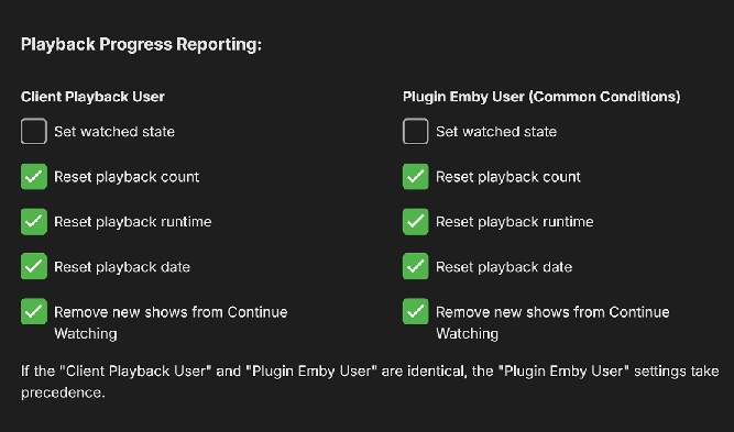

Rumbah 8 Posted November 15, 2025 Posted November 15, 2025 If I watch a random series episode on the TV channel and I stop in the middle of it, it appears in the continue watching area. Is there an option that no matter what I watch on the TV channel, it should not change any status?
podonnell 47 Posted November 16, 2025 Posted November 16, 2025 I'm using a Playlist (Live) method to display content. One thing I'd really like is to prevent the client watching from having their watched and continue watching status changed. Essentially I'd like someone to be able to 'tune in' to a channel but not have every piece of content appear in continue watching. Is there a way to set it so that clients who tune in do not have any watch status applied? Thanks!
pünktchen 1409 Posted November 16, 2025 Author Posted November 16, 2025 On 11/11/2025 at 9:19 PM, strichmo said: And is it safe to use an admin user there? That's okay, but keep in mind that the users who will be playing the channel will also need access to the Emby library that will provide the videos. On 11/11/2025 at 9:19 PM, strichmo said: And can't we have watched state based on what user the client is? If you mean the same channel will be used by different users but the watched state should be respected for each of them, then you have to duplicate the channel, enable the channels only for one selected user (General) and set that same user for accessing libraries (Common Conditions).
pünktchen 1409 Posted November 16, 2025 Author Posted November 16, 2025 On 11/12/2025 at 6:09 PM, graytinc said: Does this work on STRM files? If they are already probed by Emby for Media Info, then yes. The plugin needs the video runtime to work.
pünktchen 1409 Posted November 16, 2025 Author Posted November 16, 2025 8 hours ago, Rumbah said: If I watch a random series episode on the TV channel and I stop in the middle of it, it appears in the continue watching area. Is there an option that no matter what I watch on the TV channel, it should not change any status? Options to control this are under Playback Settings. But the plugin will not remove shows from Continue Watching if the show was already in that list prior to the channel playback.
pünktchen 1409 Posted November 16, 2025 Author Posted November 16, 2025 3 hours ago, podonnell said: I'm using a Playlist (Live) method to display content. One thing I'd really like is to prevent the client watching from having their watched and continue watching status changed. Essentially I'd like someone to be able to 'tune in' to a channel but not have every piece of content appear in continue watching. Is there a way to set it so that clients who tune in do not have any watch status applied? Thanks! Options to control this are under Playback Settings.
Rumbah 8 Posted November 16, 2025 Posted November 16, 2025 7 hours ago, pünktchen said: Options to control this are under Playback Settings. But the plugin will not remove shows from Continue Watching if the show was already in that list prior to the channel playback. I'm sorry but I don't really understand the settings. These are the blank settings: I do want to change nothing for the viewer if they watch the channel, what do I have to set? Leave the watched state blank und tick all the rest for the Emby User and Client playback user?
pünktchen 1409 Posted November 16, 2025 Author Posted November 16, 2025 1 hour ago, Rumbah said: I do want to change nothing for the viewer if they watch the channel, what do I have to set? Leave the watched state blank und tick all the rest for the Emby User and Client playback user? Yes.

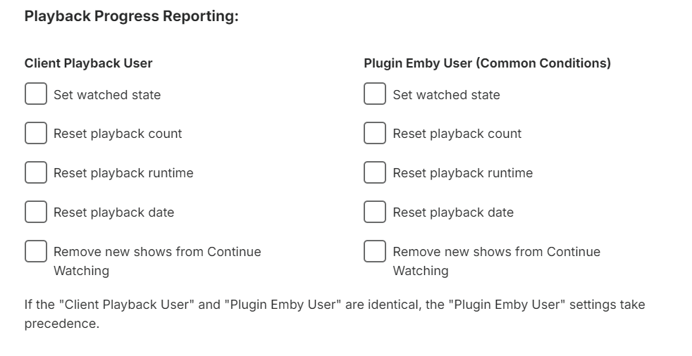

podonnell 47 Posted November 16, 2025 Posted November 16, 2025 (edited) 13 hours ago, pünktchen said: Options to control this are under Playback Settings. Ah, I think I misunderstood how these worked initially. Would this be correct for preventing any impact on the user? I'd like to have no changes to their library playback status: I don't mind what happens to the user running the playlist content -- it's a dummy account -- but any user who 'tunes in' I'd like to have no impact. Thanks! Edited November 16, 2025 by podonnell
pünktchen 1409 Posted November 16, 2025 Author Posted November 16, 2025 2 hours ago, podonnell said: Would this be correct for preventing any impact on the user? Same answer as for the post above yours: Yes. 1
