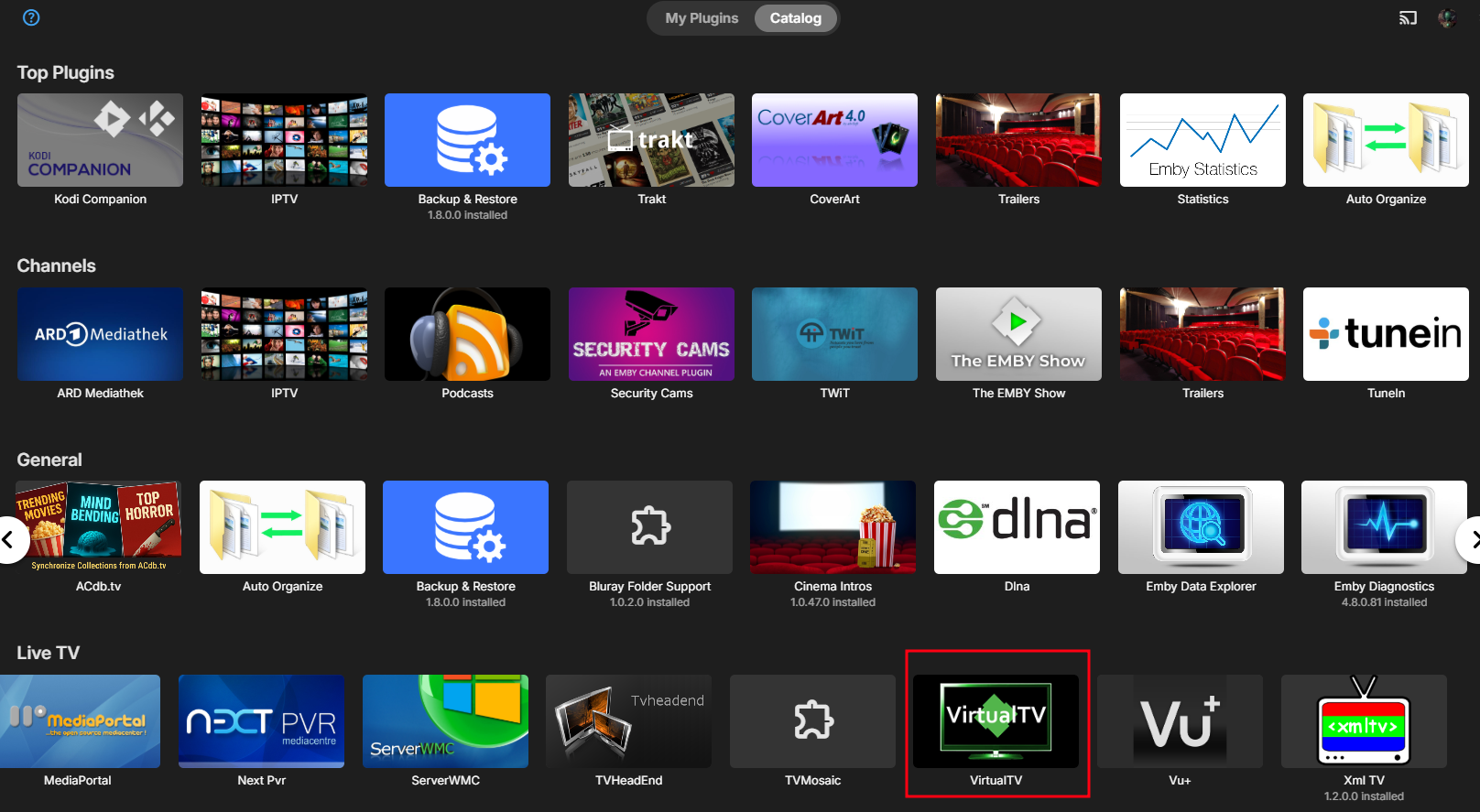

Lyfesaver 135 Posted September 4, 2025 Posted September 4, 2025 Would anyone happen to know why this plugin is not being listed in my catalog? Thanks for any input anyone might be able to offer.
Neminem 1625 Posted September 4, 2025 Posted September 4, 2025 Did you look at first post, and then look in catalog for the picture ?
Lyfesaver 135 Posted September 4, 2025 Posted September 4, 2025 Thank you, I was just coming back to say I had been blind... looked past it a good 2 or 3 times. Ty Neminem

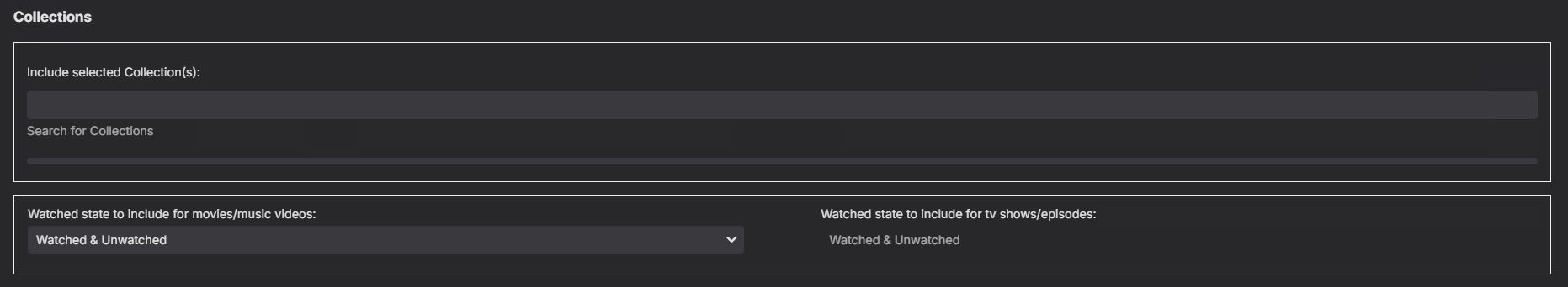

Lyfesaver 135 Posted September 5, 2025 Posted September 5, 2025 So, from my understanding... If I want a channel that is nothing but sports movies that are based on a true story (Miracle, Remember the Titans, Invincible, A League of Their Own, etc) or music (Amadeus, Bohemian Rhapsody, Walk the Line, etc) then I need to comb thru my entire collection and add the Sport and Music genres, yes? There is not an easier way that I am not seeing? Also, I am unable to use collections as a source as it ignores whatever I put in the box for the collection name I am on 4.9.x if that matters
harikiran 0 Posted September 5, 2025 Posted September 5, 2025 Hello, Is it possible to add (Random Movie Chapters) from a Movies library in Virtual TV plugin. So that that users can watch random movies clips which could give an idea what to watch next instead of playing whole movies playlist.
pünktchen 1411 Posted September 5, 2025 Author Posted September 5, 2025 7 hours ago, Lyfesaver said: I am on 4.9.x if that matters Yes that matters a lot. Which version exactly?
Lyfesaver 135 Posted September 5, 2025 Posted September 5, 2025 7 minutes ago, pünktchen said: Yes that matters a lot. Which version exactly? 4.9.1.25
