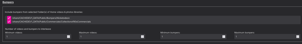

xvertigox 1 Posted January 13, 2025 Posted January 13, 2025 I just have to say THANK YOU for this plugin! I've only just switched to Emby from Plex after many years and throughout that time I've mentioned to my gf how much I want to be able to make my own TV channels that run constantly and this is absolutely perfect. I'll be sure to add feedback to this thread as I continue to use VirtualTV. On a tangentially related note - does anyone have a good source for bumpers or commercials? I'm using archive.org and it's great however there are many instances where multiple bumpers are contained in one file which isn't ideal. ffmpeg would be an option and I should def get some experience with it but if anyone has any other sources I'm all ears. 1
xvertigox 1 Posted January 13, 2025 Posted January 13, 2025 Sorry for the double post, but I can't seem to edit my previous post. When setting bumpers and videos there are options for min/max numbers for videos as well as bumpers - what's the distinction? Is it length? I don't see any other reference to these in the settings so I'm unsure.
pünktchen 1409 Posted January 13, 2025 Author Posted January 13, 2025 22 minutes ago, xvertigox said: Sorry for the double post, but I can't seem to edit my previous post. When setting bumpers and videos there are options for min/max numbers for videos as well as bumpers - what's the distinction? Is it length? I don't see any other reference to these in the settings so I'm unsure. Videos are the normal library items that build the program. In other words, how many tv programs should be played before the set number of bumpers are played. 1

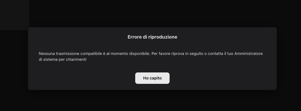

Carmine1988 0 Posted January 20, 2025 Posted January 20, 2025 After configuring Virtual TV, this message appears. How can I bypass it to make the plugin work correctly? this message No compatible transmission is currently available. Please try again later or contact your system administrator for assistance.
pünktchen 1409 Posted January 21, 2025 Author Posted January 21, 2025 5 hours ago, Carmine1988 said: After configuring Virtual TV, this message appears. How can I bypass it to make the plugin work correctly? It's not really visible from your screenshot, but do you have guide data?
Carmine1988 0 Posted January 21, 2025 Posted January 21, 2025 12 hours ago, pünktchen said: It's not really visible from your screenshot, but do you have guide data? hi...yes i have guide date
pünktchen 1409 Posted January 21, 2025 Author Posted January 21, 2025 Then the usual questions: What playback mode? What client? Can you send me the log file with debug logging enabled in Emby and the plugin?

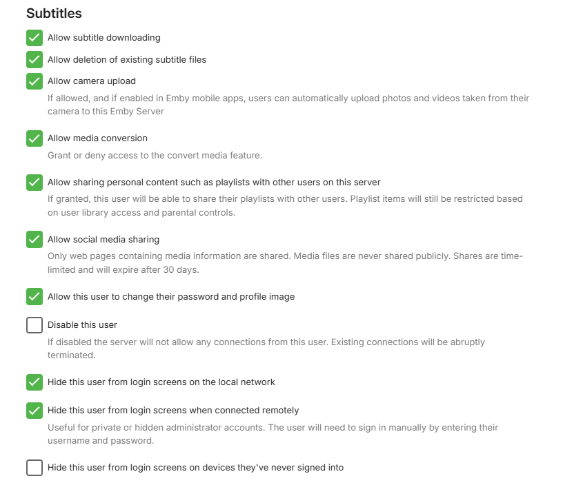

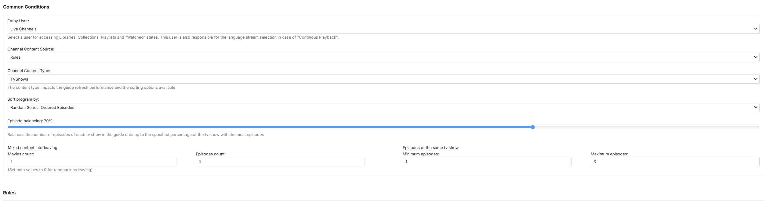

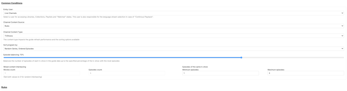

Misinthe 46 Posted January 24, 2025 Posted January 24, 2025 6 hours ago, pünktchen said: It should only list users with Live TV access in their profile settings. One last question for now if you don't mind. How can I enable subtitles? I've checked the Burn-in subtitles (Only external text based or internal picture based subtitles supported) under General Playback Settings but it didn't do anything. I tried to set it on the TV but the remote won't really do anything except Pause and Play.
pünktchen 1409 Posted January 24, 2025 Author Posted January 24, 2025 1 hour ago, Misinthe said: One last question for now if you don't mind. How can I enable subtitles? I've checked the Burn-in subtitles (Only external text based or internal picture based subtitles supported) under General Playback Settings but it didn't do anything. I tried to set it on the TV but the remote won't really do anything except Pause and Play. This should be dependant on the subtitle settings of the Emby user that you've chosen under "Common Conditions" of the channel settings. If you think it should work with that users subtitle settings, please post a screenshot of that subtitle settings so i can try to reproduce it.
Misinthe 46 Posted January 24, 2025 Posted January 24, 2025 13 hours ago, pünktchen said: This should be dependant on the subtitle settings of the Emby user that you've chosen under "Common Conditions" of the channel settings. If you think it should work with that users subtitle settings, please post a screenshot of that subtitle settings so i can try to reproduce it. Here's the User Subtitle Settings and the VirtualTV Common Settings.
pünktchen 1409 Posted January 25, 2025 Author Posted January 25, 2025 (edited) 9 hours ago, Misinthe said: Here's the User Subtitle Settings I was talking about the subtitle settings that are under the app settings. They are not app dependent but tied to the user who is logged into the app. So please use your user "Live Channels" to log into Emby in any browser of your choice and then go to the app settings (gear icon). Edited January 25, 2025 by pünktchen
