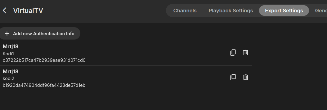

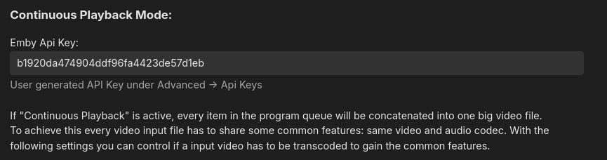

mrtj18 4 Posted December 13, 2024 Posted December 13, 2024 Hello all, I have been having issues getting this plugin to work correctly. 1. I can set up a tv show to play, put in my api information. Set it to continuous play. attempt to play the channel and i always get the error 90 % of the time "No compatible streams are currently available. Please try again later or contact your system administrator for details." error. After a reboot of Emby Server or a force reset of the TV guide the error still happens. 2. If I am able to get a channel to work once or twice. How can this be viewable on kodi? do we use this? for tv http://{ip or hostname}:{port}/emby/VirtualTV/Channels?StreamType=EmbyNextGen&RealLiveTv=true and for epg: http://{ip or hostname}:{port}/emby/VirtualTV/Guide?StreamType=EmbyNextGen&RealLiveTv=true with the kodi iptv simple plugin? Logs attached embyserver(2).txt
pünktchen 1411 Posted December 15, 2024 Author Posted December 15, 2024 On 12/13/2024 at 4:26 AM, mrtj18 said: 1. I can set up a tv show to play, put in my api information. Set it to continuous play. attempt to play the channel and i always get the error 90 % of the time "No compatible streams are currently available. Please try again later or contact your system administrator for details." error. After a reboot of Emby Server or a force reset of the TV guide the error still happens. Why do you want to use "Continuous Playback"? Anyway, i would need a new log with the plugins debug logging enabled after you have fixed the errors from your second question. Right now your log file is to big to find any useful information. Also please attach any ffmpeg or virtualtv log files that correspond to the time of your streaming errors. On 12/13/2024 at 4:26 AM, mrtj18 said: 2. If I am able to get a channel to work once or twice. How can this be viewable on kodi? do we use this? for tv http://{ip or hostname}:{port}/emby/VirtualTV/Channels?StreamType=EmbyNextGen&RealLiveTv=true and for epg: http://{ip or hostname}:{port}/emby/VirtualTV/Guide?StreamType=EmbyNextGen&RealLiveTv=true with the kodi iptv simple plugin? You are missing the "Token" parameter! You get a token from the authentication info of the plugins export settings.
mrtj18 4 Posted December 15, 2024 Posted December 15, 2024 Quote Why do you want to use "Continuous Playback"? Anyway, i would need a new log with the plugins debug logging enabled after you have fixed the errors from your second question. Right now your log file is to big to find any useful information. Also please attach any ffmpeg or virtualtv log files that correspond to the time of your streaming errors I only selected that, because I thought its the default and best to use. What playback method should I select? Quote You are missing the "Token" parameter! You get a token from the authentication info of the plugins export settings. I created one, and placed it in the following place. Yet I continue to see the same error in the logs as well... Am I missing something here? embyserver(3).txt
pünktchen 1411 Posted December 15, 2024 Author Posted December 15, 2024 2 hours ago, mrtj18 said: What playback method should I select? Playlist Playback unless you have Roku devices. 2 hours ago, mrtj18 said: I created one, and placed it in the following place. Yet I continue to see the same error in the logs as well... Am I missing something here? You have to append "&Token=" to your request urls. 1
