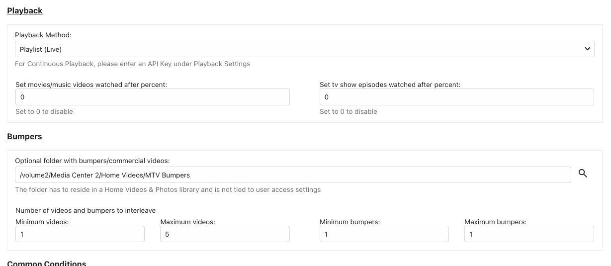

petera209 0 Posted August 1, 2024 Posted August 1, 2024 (edited) Firstly, I want to say that this plugin is amazing and has completely changed how I watch TV. Everyone I know is envious of our homemade "cable tv". So, thank you so much for the hard work. I have a quick question about Bumpers. I have tried to add them in to a couple of my channels but they don't ever seem to appear. I created a channel of all old music videos and have a folder full of random MTV promos to give it the feel of old MTV. I took a screenshot of my bumper settings. Can you tell me if I am doing something wrong. Thank you in advance for your help! Edited August 1, 2024 by petera209
pünktchen 1411 Posted August 1, 2024 Author Posted August 1, 2024 @petera209I can only guess here, but probably the user(s) who is playing the channel does not have access to the Home Videos library. I know, the description says it's not needed. But unfortunately that's not true anymore. It has changed with some of the 4.8 versions of Emby and i don't have any solution yet.
