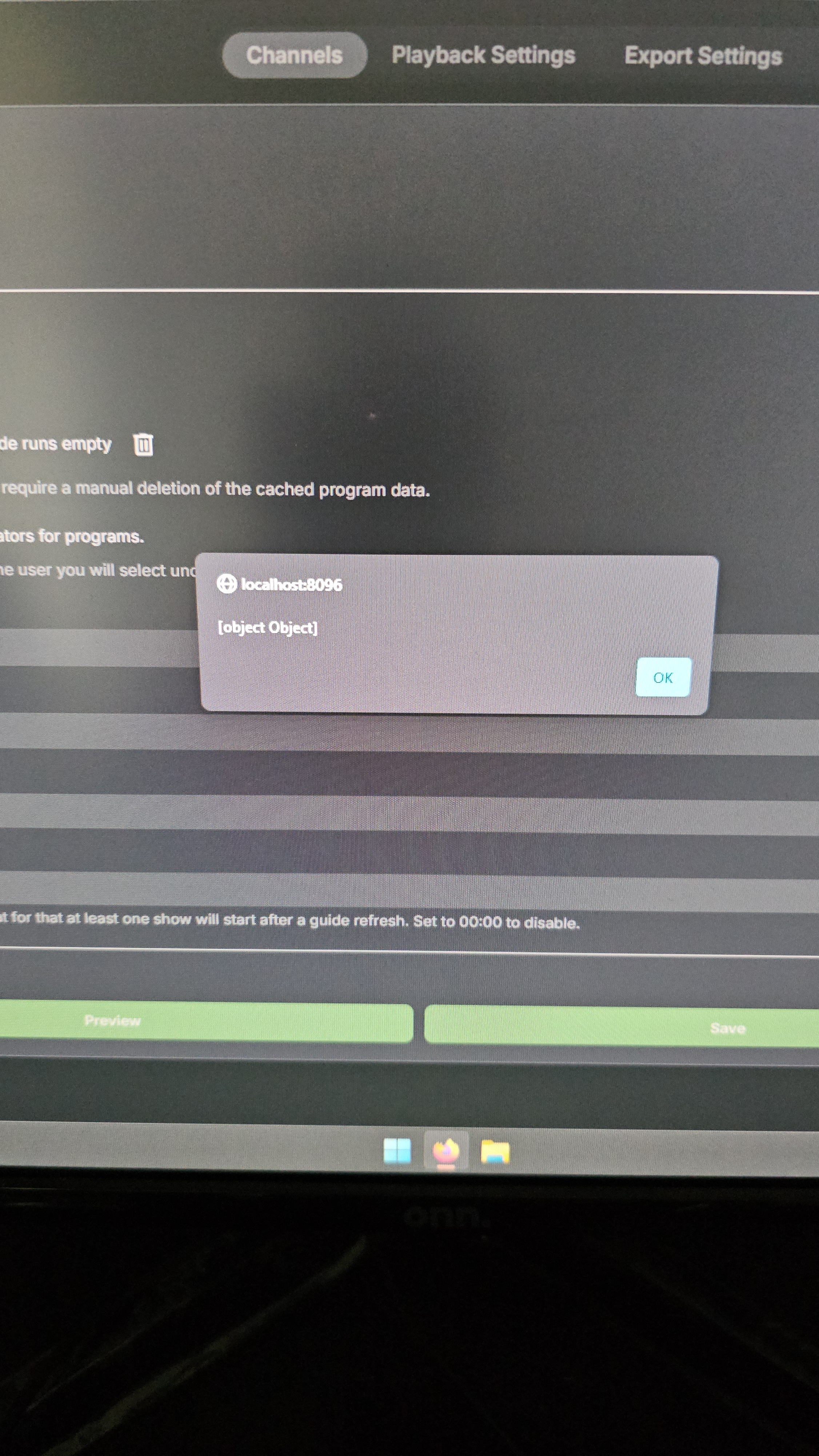

  4. Scroll up to Channel Content Type and change to MixedContent
  5. Press Preview
    This Preview does not work and the loading spinner spins forever.

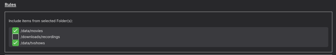

Here is the problem and the bug. You always have to select library folders as a source!
Without any folder selection, the plugin should never return anything. But currently it does, that's the bug.
Okay I will try again with the user and folders selected. The Preview button should correctly return the list yes? Just want to be sure I don't have to regenerate the guide each time to verify.

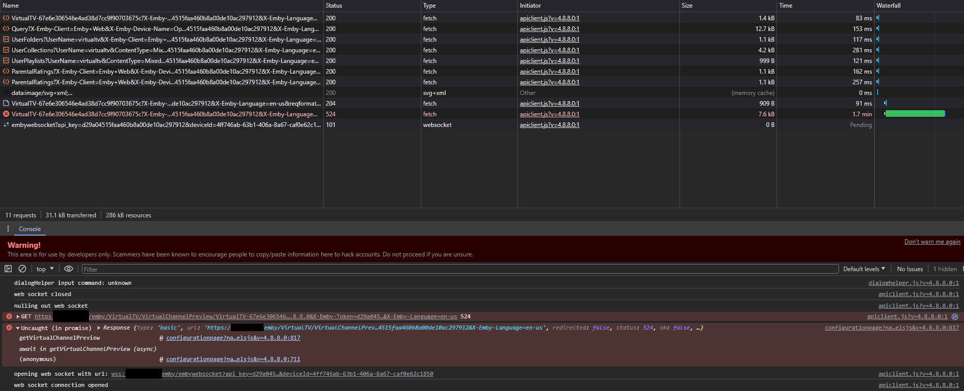

I simply click on the channel from the list and press Preview. The loading spinner spins endlessly and I see this in the console:
Changing to content type Movies the Preview query will work without issue and returns items within 5-10 seconds. MixedContent and TVShows both fail.
A bit more debugging. I found the getVirtualChannelPreview function and captured the virtualChannel object data that is being sent to the server just to see if there was an issue with that:
That is very slow. Either your server is not really powerfull or your database/library is really big. In any case, you should only select the folders that you really want to use as a source for a specific channel, not all folders.
I see. So there is some type of limitation based on library size? I assumed it was just making a query to the Emby API with the filters from virtual TV and returning the first X items. I will try limiting the folders more to see if I get different results, but the bulk of my library is only in two folders anyways S:\TV and S:\Movies. According to Emby it's about 6000 movies and 100000 episodes
pünktchen
It's these 100.000 episodes that are making trouble. The plugin will check every tv show and every episode against your genre rule. I know, genres at the episode level is really unusual, but if somebody has that, then the plugin can make use of it. What you could try is to limit the query by using  additional conditions like "release date".

Would anyone know why I am getting this error when I go to make a virtual channel?

pünktchen
When does this happen? Right after adding a new channel or when you try to save the channel? In the latter case, you've probably missed a field that must not be empty, like channel name. You could also try another browser to get a meaningful error message.
n0tanks87
It's when I save the channel. I filled out all of the boxes that I thought applied. Even added a logo. I tried Firefox and Chrome. Both give the same error. I did get passed the error only to get met with no guide data no matter how I refreshed it. Even force refresh. I must be doing something stupid on my part.
