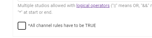

JuJuJurassic 50 Posted January 9, 2024 Posted January 9, 2024 Hi Junglejim, The "wished for" result of the channel would be to play random episodes of the star trek series I have on the server, but not the animated series. I may want to ensure Star Trek Voyager isn't played - Never liked that one much. Thanks and have a good evening

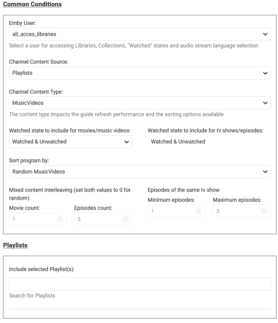

TZTZoro 26 Posted January 10, 2024 Posted January 10, 2024 Collections/playlists dont seem to be working, my playlists are set to collaborative

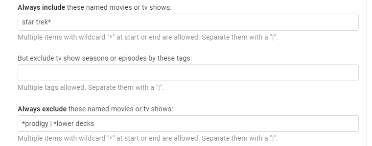

Dibbes 515 Posted January 10, 2024 Posted January 10, 2024 6 hours ago, JuJuJurassic said: Hi Junglejim, The "wished for" result of the channel would be to play random episodes of the star trek series I have on the server, but not the animated series. I may want to ensure Star Trek Voyager isn't played - Never liked that one much. Thanks and have a good evening Try this: Uncheck the box at the end:
ellisd4 78 Posted January 10, 2024 Posted January 10, 2024 46 minutes ago, Dibbes said: Try this: Uncheck the box at the end: I just tag episodes I do not want included… don’t know why you couldn’t do that with the animated series and then use the tag as an exclusion.
Dibbes 515 Posted January 10, 2024 Posted January 10, 2024 1 minute ago, ellisd4 said: I just tag episodes I do not want included… don’t know why you couldn’t do that with the animated series and then use the tag as an exclusion. Yup, that would be another way of doing it, personally I found this solution to be easier

pünktchen 1411 Posted January 10, 2024 Author Posted January 10, 2024 1 hour ago, TZTZoro said: Collections/playlists dont seem to be working, my playlists are set to collaborative Thanks. It's an update problem of the selection fields. It will be fixed in the next version that will be coming soon. For now just change the user once more after you have selected Playlists as source and MusicVideos as type. Btw. I have not forgotten your other problem with the playback start...
TZTZoro 26 Posted January 10, 2024 Posted January 10, 2024 11 hours ago, pünktchen said: Thanks. It's an update problem of the selection fields. It will be fixed in the next version that will be coming soon. For now just change the user once more after you have selected Playlists as source and MusicVideos as type. Btw. I have not forgotten your other problem with the playback start... Unfortunately that doesnt solve it for me, i change the user to all the users on my server and the playlist section doesnt change, i'll wait for the next release and try the new version, thank you That is awesome, no haste, it isnt as big of an issue for the music videos, i havent seen it with mixed content channels (yet)
