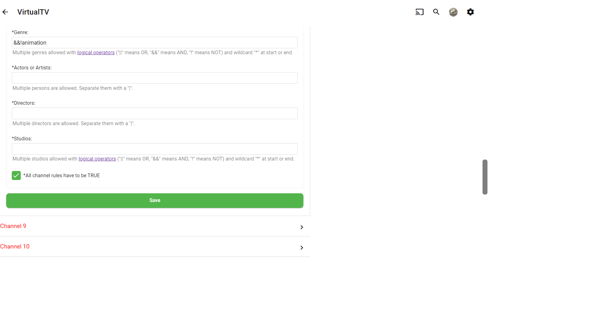

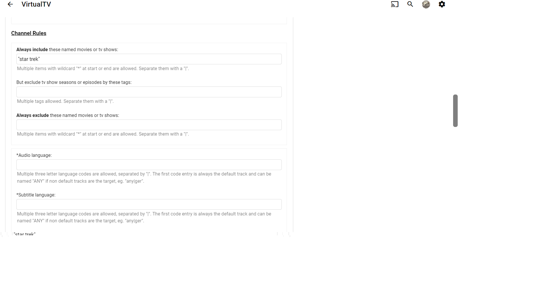

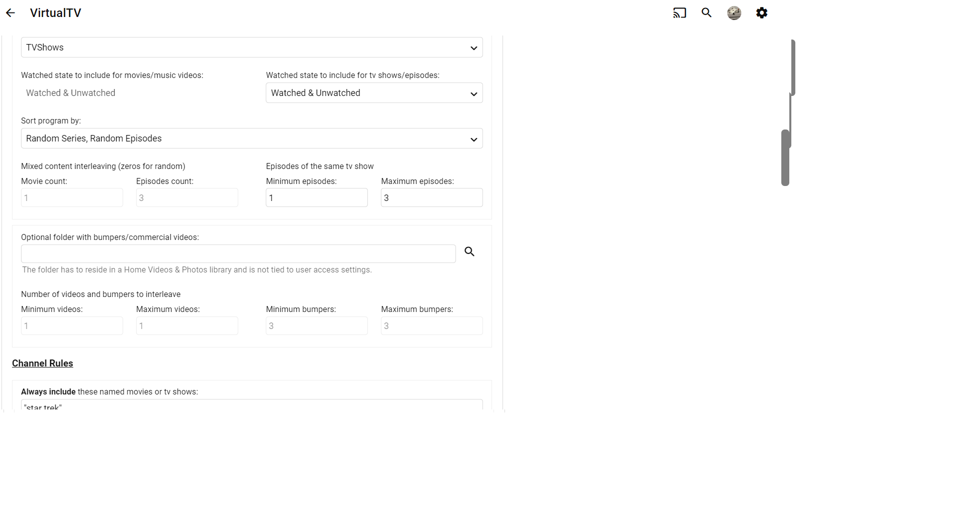

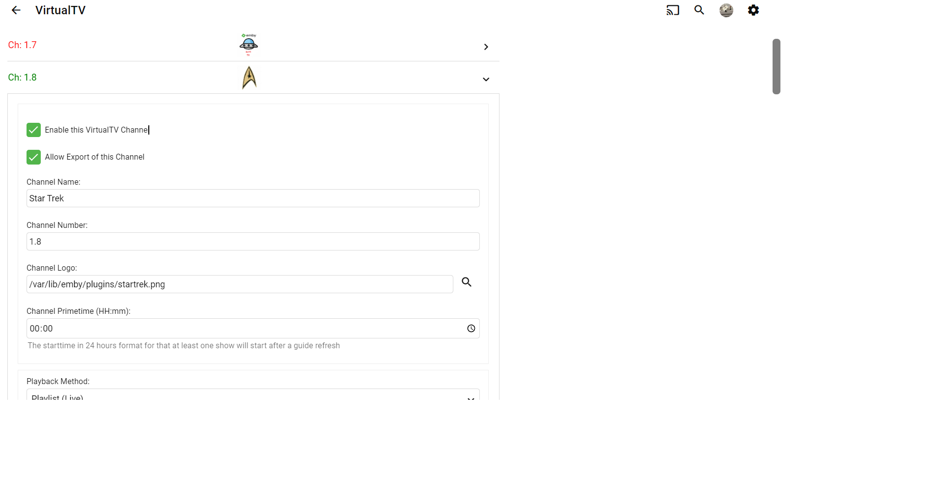

JuJuJurassic 50 Posted January 4, 2024 Posted January 4, 2024 (edited) I'm having a similar problem, I've disabled the TV channels, but the Sci-Fi ones are still there, the Christmas ones have gone. Why some and not all? I'm also having problems creating a star trek channel. I've asked it not to show animation, but it's pulling any show, not just Star Trek. I've attached the screenshots. I tried entering star Trek instead of "star trek" but it didn't work. What have I done wrong? Thanks Edited January 4, 2024 by JuJuJurassic
pünktchen 1411 Posted January 4, 2024 Author Posted January 4, 2024 38 minutes ago, JuJuJurassic said: I'm having a similar problem, I've disabled the TV channels, but the Sci-Fi ones are still there, the Christmas ones have gone. Why some and not all? I can't tell you without a log. 39 minutes ago, JuJuJurassic said: I'm also having problems creating a star trek channel. I've asked it not to show animation, but it's pulling any show, not just Star Trek. I've attached the screenshots. I tried entering star Trek instead of "star trek" but it didn't work. Always Include: Star Trek (without quotes) Genre: !Animation (without && before it)
pünktchen 1411 Posted January 5, 2024 Author Posted January 5, 2024 @JuJuJurassici had another look at your post and i think my answer wasn't correct. But before i give you another wrong tip, you should explain me what should be the outcome of the Star Trek channel. As far as i know, there's only one tv show that is exactly named Star Trek and that is not an animated series. So there's no need at all to exclude the Animation genre.
