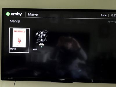

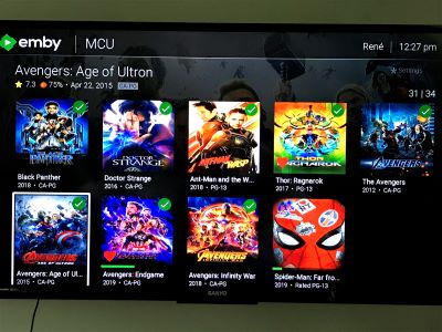

rene.teniere 17 Posted December 23, 2019 Posted December 23, 2019 I have the scenario of a mixed media library added from a main folder named Marvel. There are two subfolders named MCU and Marvel, each with media within. In both the emby and emby beta apps for Roku, the artwork is the proper size ratio for the first line, then the rest of the artwork below is squished down. I do not seem to have issues with other mixes media libraries with no subfolders, but the same issue persists with similar subfolder situations.

rene.teniere 17 Posted December 23, 2019 Author Posted December 23, 2019 I noticed that the issue isn’t consistent between release and beta... See attached fies.
ebr 16335 Posted December 23, 2019 Posted December 23, 2019 Hi. When you use folder browsing we don't have the same information about items that we do when using our specified library types. I don't think the issue has anything to do with the placement of these items (2nd row) but, rather, just what, exactly they are. When you click on one of those items, where do you end up? What are they? More folders?
rene.teniere 17 Posted December 23, 2019 Author Posted December 23, 2019 They are movies. In the release version, one of the screens that is affected in the beta version is fine. There definitely is an issue between the two. I am always expecting the same artwork size ratio no matter what the media type. I will add another screenshot to show the difference.

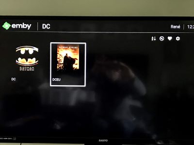

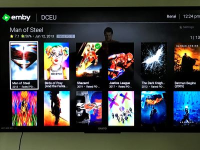

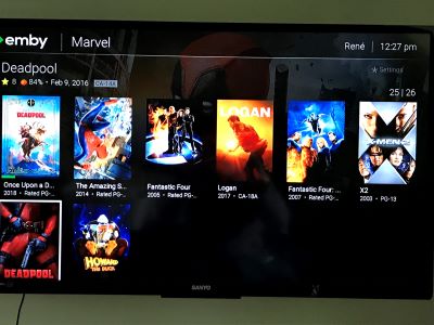

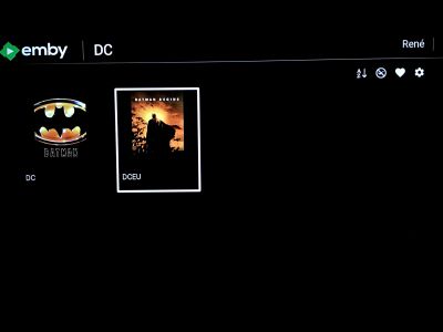

rene.teniere 17 Posted December 23, 2019 Author Posted December 23, 2019 Examples from the current release: Example in the Marvel folder: Proper ratio but bottom is cut off Example in the MCU folder: Examples from the Beta version: Example in the Marvel folder: Example from the MCU folder: I have both a streaming stick and streaming stick+ that exhibit the same results.
rene.teniere 17 Posted December 23, 2019 Author Posted December 23, 2019 Image # from top to bottom. 7, 11, 13, 14. I have stacked them 1-7 for release and beta respectively. All screenshots were taken at the same positions so you can see the differences between the two, I.e. compare image #4 and image #11. #4 is the same screen as #11 only #4 is the release version and #11 is beta.
rene.teniere 17 Posted December 23, 2019 Author Posted December 23, 2019 Aspect ratio is not maintained after line 1

rene.teniere 17 Posted December 25, 2019 Author Posted December 25, 2019 (edited) I re arranged the items. Seems like it happens to items that have a sub-folder or after items without media in it, I.e. the folder with the movie in it has a subfolder called Trailers. That is one of the affected folders and everything after that gets messed up. I can sort by name ascending and descending and the results change. With the DCEU example screenshot above, A-Z is messed up (like in the screenshot), but after switching to Z-A everything looks fine. Strange thing is putting it back to A-Z everything is fine until I back-out of the DCEU folder. When I go back in the DCEU folder, it is messed up again. I have also found that the sorting is strange if I have folders within a category for movies not yet released without media inside. I would have thought the behaviour would be a-z for all contents. It seems to separate folders a-z and then folders with movies a-z afterwards. Is this expected behaviour?For you to test, create a main mixed media library called DC (like I have above) with folders:—-->DC————>Movie1 (only artwork)————>Movie2 (only artwork)————>Movie3 (with media and artwork)————>Movie4 (with media and artwork)——————>Other (nothing inside)————>Movie5 (with media and artwork)——>DCEU————>Movie1 (with media and artwork)————>Movie2 (with media and artwork)——————>Other (nothing inside)————>Movie3 (with media and artwork)————>Movie4 (only artwork)The example above is similar to what I have. I would like to note that I do not have any issues with aspect ratios on either the web or apple app versions. Edited December 25, 2019 by rene.teniere

ebr 16335 Posted December 25, 2019 Posted December 25, 2019 Right, that's why I asked what those items were. To Emby, the way you are browsing, those are folders, not movies and that's why they are displaying differently. We'll see if we can improve it.
rene.teniere 17 Posted December 27, 2019 Author Posted December 27, 2019 I think the issue I am having is that it hits a folder, displays differently, then all movies afterwards are not displayed as they should be. I don’t mind if folders are treated a specific way, it is only when it is not displayed correctly when it is a legit folder. I am a tad OCD so it probably bothers me more than most...
