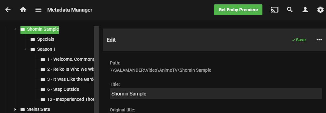

Turosian 5 Posted December 23, 2019 Posted December 23, 2019 I have a show, Shomin Sample, which is set up with a very standard naming convention. Season 1 has 12 episodes and there are six specials I have. Naming is very standard: Shomin Sample Season 1 Shomin Sample - S01E01 [bD][720p-AAC][29C256FC].mkv ... Shomin Sample - S01E12 [bD][720p-AAC][59653165].mkv Specials 01 - Shomin Sample - SP 01 [bD][720p-AAC][bC80CB8E].mkv ... 06 - Shomin Sample - SP 06 [bD][720p-AAC][8D1754D0].mkv Nothing special about this series. I've named dozens of them exactly the same. However, when the scraper runs, it only detects episodes 1, 2, 3, 6, 12 in Season 1, and none of the Specials. I am using "thetvdb.com" as the top Series Metadata Downloader and Episode Metadata Downloader, with AniDB as the top Season Metadata Downloader. I was wondering if there might be some corruption in here, so I made a copy of the "Shomin Sample" folder on my media server and then used the Metadata Manager to delete the series. Once that was done and a refresh had finished on that library, I added the copy back and let it be found again...same problem. Not sure what else to do. Suggestions?

Turosian 5 Posted December 23, 2019 Author Posted December 23, 2019 (edited) I'm determining that by what the client sees. Web/Roku/Android clients all see only 5 episodes in season 1 and none in specials. Same with Metadata Manager. I've attached a screenshot from Metadata Manager. Edited December 23, 2019 by Turosian

Solution ebr 16313 Posted December 23, 2019 Solution Posted December 23, 2019 The problem is the name, no? As it contains the word "sample"... 1
Turosian 5 Posted December 23, 2019 Author Posted December 23, 2019 That was the issue, apparently. Renaming from "Shomin Sample" to "SS" allowed all files to be recognized. Still doesn't 100% explain why 5 of the files *were* recognized even with the "Sample" keyword though. Here's the full contents of the directories (before renaming) for analysis in case anyone still cares now that it is working for me: Shomin Sample Season 1 Shomin Sample - S01E01 [bD][720p-AAC][29C256FC].mkv Shomin Sample - S01E02 [bD][720p-AAC][22764915].mkv Shomin Sample - S01E03 [bD][720p-AAC][33211DF9].mkv Shomin Sample - S01E04 [bD][720p-AAC][9F565876].mkv Shomin Sample - S01E05 [bD][720p-AAC][A7D4C17F].mkv Shomin Sample - S01E06 [bD][720p-AAC][5759C02C].mkv Shomin Sample - S01E07 [bD][720p-AAC][F0D1D40D].mkv Shomin Sample - S01E08 [bD][720p-AAC][6095C22F].mkv Shomin Sample - S01E09 [bD][720p-AAC][26822CBA].mkv Shomin Sample - S01E10 [bD][720p-AAC][b0539102].mkv Shomin Sample - S01E11 [bD][720p-AAC][0F2D0CAA].mkv Shomin Sample - S01E12 [bD][720p-AAC][59653165].mkv Specials 01 - Shomin Sample - SP 01 [bD][720p-AAC][bC80CB8E].mkv 02 - Shomin Sample - SP 02 [bD][720p-AAC][6DDE39B5].mkv 03 - Shomin Sample - SP 03 [bD][720p-AAC][318FC530].mkv 04 - Shomin Sample - SP 04 [bD][720p-AAC][DF4EC1AD].mkv 05 - Shomin Sample - SP 05 [bD][720p-AAC][3B548844].mkv 06 - Shomin Sample - SP 06 [bD][720p-AAC][8D1754D0].mkv

Luke 42216 Posted December 23, 2019 Posted December 23, 2019 Are any of those episode files really small? That's why they're being ignored. The system will ignore files over a certain size containing the word sample in the file name.
Turosian 5 Posted December 24, 2019 Author Posted December 24, 2019 The specials are between 34,150 KB and 79,298 KB. The actual episodes are between 261,079 KB and 380,062 KB, but the 5 which were recognized were the 5 largest, with the smallest recognized being 320,142 KB and the largest not recognized being 293,582 KB, so maybe the line is between those two?
Happy2Play 9806 Posted December 24, 2019 Posted December 24, 2019 (edited) Each library options.xml has "SampleIgnoreSize", so it looks like 300MB.. <SampleIgnoreSize>314572800</SampleIgnoreSize> Seem to me it should be around 30 to 40MB for samples though. Edited December 24, 2019 by Happy2Play
