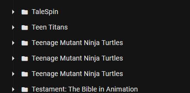

Bigmixer 1 Posted December 21, 2019 Author Posted December 21, 2019 (edited) More strange things happening. Certain shows (maybe movies too) aren't showing up. Even when I remove the library and rebuild. They show up during the rebuild and then vanish. For instance Teen Titans Go! is on disk 3 under TVShows in Unraid: But in Emby, it is missing in both Metadata Manager and Library: Any ideas? Teen Titans Go! isn't the only issue. I have re-scanned the library and even removed the library and rebuilt. Edited December 21, 2019 by Bigmixer
Luke 42246 Posted December 21, 2019 Posted December 21, 2019 What's underneath those folders? Are there season folders or episode files?
Bigmixer 1 Posted December 21, 2019 Author Posted December 21, 2019 Thanks again for all the help. Unraid level 1: Level 2:

Bigmixer 1 Posted December 22, 2019 Author Posted December 22, 2019 Found it. Several Series went under an odd series called One Piece. I went into that series and identified them as what they really were by the path. The series that went missing because of this: Full House - path TV/Full House The Blacklist - Path: TV/The Blacklist Power Puff Girls - Path: TV/Power Puff Girls Westworld - Path: TV/Westworld
Luke 42246 Posted December 26, 2019 Posted December 26, 2019 @@Bigmixer, that's quite strange, but it's possible they got the wrong TVDB Id and got merged together as One Piece. There is a library option for your TV library to merge them together. If you disable this and then run a library scan, that will separate them again. Please let us know if this helps. Thanks.
Bigmixer 1 Posted December 26, 2019 Author Posted December 26, 2019 I appreciate it. I was able to manually separate the series.
