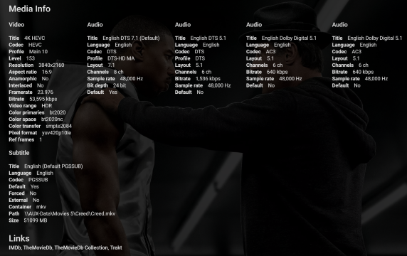

ebr 16338 Posted January 2, 2020 Posted January 2, 2020 Okay, at least I got the last switch in that log. This item is reporting a video bitrate of 122Mb/s... Is that correct..?
ebr 16338 Posted January 2, 2020 Posted January 2, 2020 How do I determine the bitrate? Look at the media info at the bottom of the detail page in the web app. This item appears to have an extremely high bitrate - beyond the specs for even a Shield.
tuvx 15 Posted January 2, 2020 Author Posted January 2, 2020 Seems to be ~53mb/s. Are you suggesting that the Fire Stick 4K is not capable of playing 4K HDR videos (on a 1080p TV)? Although changing the Quality to a lower setting (40 mb/s) to allow watching, it displays a washed out picture. I have seen posts on this issue before, but I am watching these on a non-4K TV so there is no HDR setting.
ebr 16338 Posted January 2, 2020 Posted January 2, 2020 I think the value reported there is an average. The player is reporting seeing a much higher rate at at least one point: 01-02 11:55:43.427 16060 17351 I MediaCodecLogger: tv.emby.embyatv.HW.video.hevc.bitrateInKbps = 122921 Are you suggesting that the Fire Stick 4K is not capable of playing 4K HDR videos (on a 1080p TV)? "4K HDR Videos" is a very general statement. The device is capable of playing those but only up to certain specs. The max bitrate the device is published to support in HEVC is 35Mb/s. What is the origin of this file?
