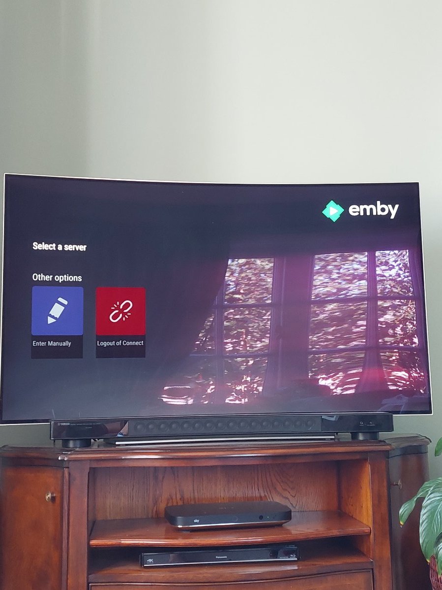

CHERYLHAYES 0 Posted July 16, 2021 Posted July 16, 2021 I have this same issue with the app on my firestick any clues on how to get it working
Carlo 4561 Posted July 16, 2021 Posted July 16, 2021 2 hours ago, CHERYLHAYES said: I have this same issue with the app on my firestick any clues on how to get it working Hi, is your server already setup for remote use? Is it using SSL or non secured ports? Is the TV in the above picture on the same LAN as the server or is it remote?
