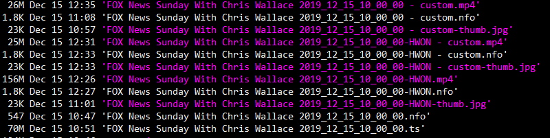

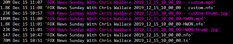

tdiguy 99 Posted December 15, 2019 Posted December 15, 2019 I finally sat down and came up with a comparison showing conversion file sizes, for hevc 4mbps with hardware acceleration on and with it off. Its really weird that the one with hardware acceleration on is even larger than the original file that is stored as .ts format and the same content with hw acceleration off is significantly smaller than the .ts file. Log files attached. emby-hw-off.txt emby-hwon.txt
PenkethBoy 2068 Posted December 15, 2019 Posted December 15, 2019 with HW On - the bitrate of the ts file is "only" 2.5mbps - so you are increasing the bitrate to 4mpbs - which will increase the file size.... with HW off - the output bitrate is significantly lower than - in the sub 1mbps range - are you sure you set that one to 4mbps? either way the final file size is dependant (mostly) on the output bitrate when using the same input file for comparison - which you can see in your logs Also the encoder via software (cpu) is always smaller than a HW encode although significantly slower
tdiguy 99 Posted December 15, 2019 Author Posted December 15, 2019 (edited) with HW On - the bitrate of the ts file is "only" 2.5mbps - so you are increasing the bitrate to 4mpbs - which will increase the file size.... with HW off - the output bitrate is significantly lower than - in the sub 1mbps range - are you sure you set that one to 4mbps? either way the final file size is dependant (mostly) on the output bitrate when using the same input file for comparison - which you can see in your logs Also the encoder via software (cpu) is always smaller than a HW encode although significantly slower The only setting difference between the 2 files is turning hardware acceleration on or off. There isnt a option to have the bitrate lower than 1.5 in emby. Is it normally expected that the difference in file sizes would be so noticeable between using hardware acceleration or software? I will run another round and keep the setting on keep original for bitrate to see how that lands. Edited December 15, 2019 by tdiguy
PenkethBoy 2068 Posted December 15, 2019 Posted December 15, 2019 the 2.5mbps is the bitrate of the TS file you recorded - i.e the source bitrate - nothing to do with Emby other than its getting it as the starting point Maybe Emby using software encoding is not honoring the final output you are setting at 4mbps for the cpu - and thats why its below 1mbps in the converted file
tdiguy 99 Posted December 15, 2019 Author Posted December 15, 2019 Here is a comparison with the bitrate left at original and turning hardware acceleration on and off. emby-HWOFF.txt emby-hwon.txt
tdiguy 99 Posted December 15, 2019 Author Posted December 15, 2019 Looks like leaving the setting for keep original is the trick for this. With hardware acceleration on and bitrate at original it is a significantly smaller file. Previous comparison is still very odd to me on how that worked out.
Happy2Play 9811 Posted December 15, 2019 Posted December 15, 2019 (edited) But you can not compare HWOFF conversion to h264 and HWON conversion to h265. HWON 12:22:07.316 Stream mapping:12:22:07.316 Stream #0:0 (mpeg2video) -> deinterlace_vaapi (graph 0)12:22:07.316 deinterlace_vaapi (graph 0) -> Stream #0:0 (hevc_vaapi)12:22:07.316 Stream #0:1 -> #0:1 (ac3 (native) -> aac (native))12:22:07.316 Stream #0:2 -> #0:2 (ac3 (native) -> aac (native)) HWOFF 12:31:58.697 Stream mapping:12:31:58.697 Stream #0:0 (mpeg2video) -> yadif (graph 0)12:31:58.697 yadif (graph 0) -> Stream #0:0 (libx264)12:31:58.697 Stream #0:1 -> #0:1 (ac3 (native) -> aac (native))12:31:58.697 Stream #0:2 -> #0:2 (ac3 (native) -> aac (native)) from logs in post 5. Edited December 15, 2019 by Happy2Play
Happy2Play 9811 Posted December 15, 2019 Posted December 15, 2019 Logs from post 1 ON looks like it achieved 4mb bitrate 10:55:55.722 10:55:55.728 frame= 6784 fps= 30 q=-0.0 Lsize= 110869kB time=00:03:46.29 bitrate=4013.6kbits/s dup=175 drop=0 throttle=off speed= 1x 10:55:55.728 video:94645kB audio:15942kB subtitle:0kB other streams:0kB global headers:0kB muxing overhead: 0.255392% OFF looks like software only achieved 734kb bitrate 11:07:01.765 11:07:01.769 frame= 6784 fps= 30 q=-0.0 Lsize= 20295kB time=00:03:46.25 bitrate= 734.8kbits/s dup=174 drop=0 throttle=off speed=0.995x 11:07:01.769 video:4047kB audio:15942kB subtitle:0kB other streams:0kB global headers:2kB muxing overhead: 1.529747%
tdiguy 99 Posted December 15, 2019 Author Posted December 15, 2019 (edited) But you can not compare HWOFF conversion to h264 and HWON conversion to h265. HWON 12:22:07.316 Stream mapping: 12:22:07.316 Stream #0:0 (mpeg2video) -> deinterlace_vaapi (graph 0) 12:22:07.316 deinterlace_vaapi (graph 0) -> Stream #0:0 (hevc_vaapi) 12:22:07.316 Stream #0:1 -> #0:1 (ac3 (native) -> aac (native)) 12:22:07.316 Stream #0:2 -> #0:2 (ac3 (native) -> aac (native)) HWOFF 12:31:58.697 Stream mapping: 12:31:58.697 Stream #0:0 (mpeg2video) -> yadif (graph 0) 12:31:58.697 yadif (graph 0) -> Stream #0:0 (libx264) 12:31:58.697 Stream #0:1 -> #0:1 (ac3 (native) -> aac (native)) 12:31:58.697 Stream #0:2 -> #0:2 (ac3 (native) -> aac (native)) from logs in post 5. Odd, they should both be hevc that was the setting used anyway. Looking at the log i wonder if i did screw that up though. Either way leaving bitrate at original seems like it resolved what i thought was an issue, who knew broadcast tv was such low bitrate. Edited December 15, 2019 by tdiguy

Luke 42239 Posted December 15, 2019 Posted December 15, 2019 Logs from post 1 ON looks like it achieved 4mb bitrate 10:55:55.722 10:55:55.728 frame= 6784 fps= 30 q=-0.0 Lsize= 110869kB time=00:03:46.29 bitrate=4013.6kbits/s dup=175 drop=0 throttle=off speed= 1x 10:55:55.728 video:94645kB audio:15942kB subtitle:0kB other streams:0kB global headers:0kB muxing overhead: 0.255392% OFF looks like software only achieved 734kb bitrate 11:07:01.765 11:07:01.769 frame= 6784 fps= 30 q=-0.0 Lsize= 20295kB time=00:03:46.25 bitrate= 734.8kbits/s dup=174 drop=0 throttle=off speed=0.995x 11:07:01.769 video:4047kB audio:15942kB subtitle:0kB other streams:0kB global headers:2kB muxing overhead: 1.529747% With hwa ON, the hwa encoder is doing a better job of staying close to the max requested quality. The software encoder at times will drop to lower bitrates. This is the reason for the difference.
