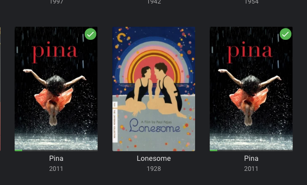

Bigmack3000 108 Posted December 17, 2019 Author Posted December 17, 2019 Ok so i got the 3d file to work with my TV, but for some reason Emby is separating the 2d and 3d versions even though they are both housed inside the same folder: Is this standard for 3d releases? Should I put 3d versions in their own folder? They are currently named "Pina (2011)" and "Pina (2011).3D.MVC". Also, will Emby convert successfully compress a 3d file?
samuelqwe 317 Posted December 17, 2019 Posted December 17, 2019 (edited) Ok so i got the 3d file to work with my TV, but for some reason Emby is separating the 2d and 3d versions even though they are both housed inside the same folder: Is this standard for 3d releases? Should I put 3d versions in their own folder? They are currently named "Pina (2011)" and "Pina (2011).3D.MVC". Also, will Emby convert successfully compress a 3d file? Firstly, did you take a look at the page Luke linked above? It shows you how to name them when you have both a 2D and 3D movie in the same folder. And secondly, does the name of the folder match the name of the video files (minus the file type and version name)? I believe that for Emby to recognize them as separate versions of the same movie, you have to have the folder with the same name as the video files too. It was that way, last I checked, for proper multi version naming. Edited December 17, 2019 by samuelqwe
Bigmack3000 108 Posted December 17, 2019 Author Posted December 17, 2019 Yea, I copied this filename suggestion from that page "moviename (year).3d.hsbs.mkv". But I guess the "." doesn't work when you have a 2d file as well, so I'll "-" example. The folder is labeled "Pina (2011)" so I don't think that's the problem.
Luke 42217 Posted December 17, 2019 Posted December 17, 2019 What is the folder name and what are the file names within it?
Bigmack3000 108 Posted December 18, 2019 Author Posted December 18, 2019 I kept the 2d as "Pina (2011).mkv", but changing the 3d to "Pina (2011) - dc.mvc.mkv" instead of the "." fixed it. They are now both housed in one spot. The only question left is if the emby convert can compress a 3d file. If this is unknown, I'll try to test it overnight.
