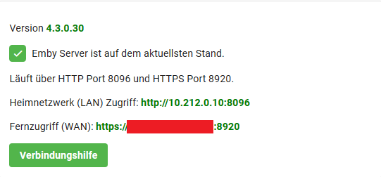

varmandra 3 Posted December 14, 2019 Author Posted December 14, 2019 yes I went through that, see picture. HTTP works fine, external WAN adress works like expected, Auto Port Mapping don´t work like expected. HTTPS don´t work and that my problem BdT Varmandra
Q-Droid 1011 Posted December 14, 2019 Posted December 14, 2019 Yeah, don't rely on the Auto Port Mapping and make sure the router port forwarding is setup. It looks like your external domain field is empty, it should match the CN of your cert. It also looks like you have no password for your certificate. I can't tell if you cleared those fields to post the image. When done you should see the In-Home and Remote URLs on the Dashboard.

varmandra 3 Posted December 15, 2019 Author Posted December 15, 2019 Finally I find where my problem comes from, the test version I used here everything is done like described in the how-to got to sslforfree.com create a certificate, then use SSL Converter to create a pfx, with this and a restart it works. Fine, but I am not a friend of send someone my complete certificate files! So I get back to the beginning get a certificate with certbot, and create the pfx on my own with "openssl pkcs12 -inkey privkey.pem -in fullchain.pem -export -out emby.pfx" and this pfx don’t work, on the dashboard it only shows the 8096 connection (doesn’t matter how many restarts I do). (With the working pfx it shows for LAN 8096 and for WAN 8920). When I use the certificate from certbot and use it with SSL Converter, I get a working pfx, so something muss go wrong when I create the pfx file. BdT Varmandra
