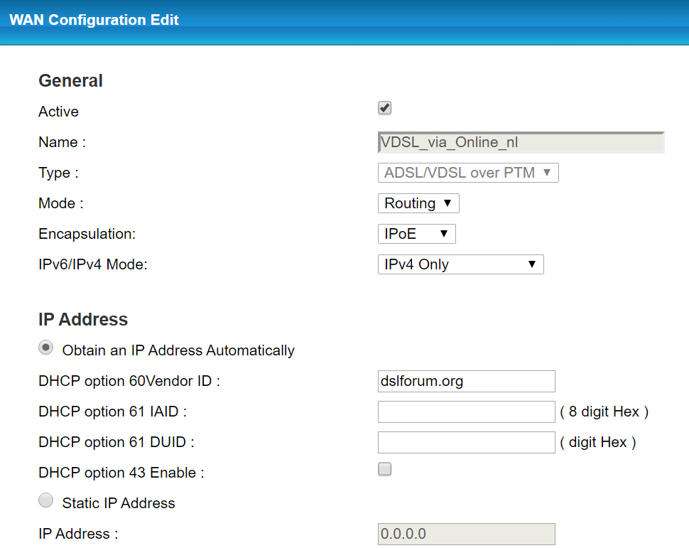

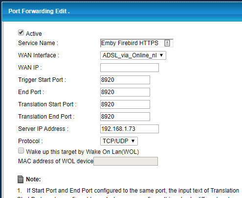

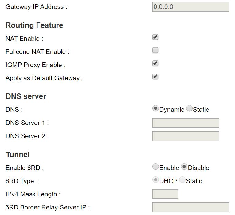

MyMediaAtHome 2 Posted December 10, 2019 Posted December 10, 2019 Locally on my LAN and WiFi access is flawless and speedy. Remote access doesn't work unless I switch on DMZ. I've read in another topic on this forum that bridge mode is the solution. Not for me because then internet is totally gone. Attached all the info you need (I hope) The blank WAN IP's now have my 82.xxx.xxx.xxx address in it. When everything works I'll try blank because I often use a VPN with varying IPs.

Luke 42217 Posted December 10, 2019 Posted December 10, 2019 Well you have to let the traffic through somehow. If you're not going to use the DMZ, then your other option is port forwarding.

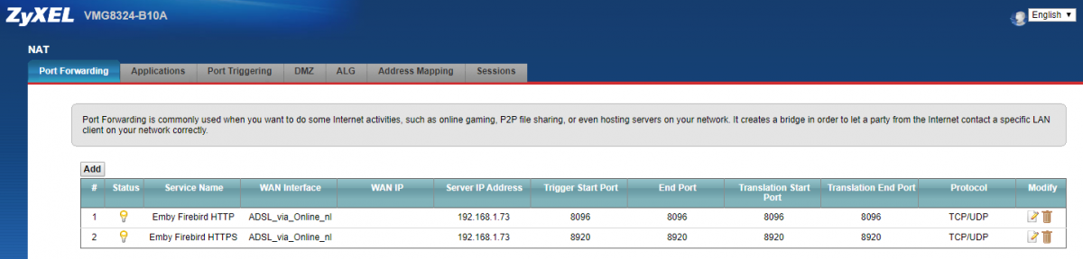

MyMediaAtHome 2 Posted December 10, 2019 Author Posted December 10, 2019 I know and that's shown in the first picture in the first post.
MyMediaAtHome 2 Posted December 10, 2019 Author Posted December 10, 2019 Yep, it's off. See attached picture. I really hope I can get this working. Yesterday I became a lifetime Embrio Emby user :-)

Solution MyMediaAtHome 2 Posted December 12, 2019 Author Solution Posted December 12, 2019 SUCCESS! Give me the dombo award..... My modem is used on 8 types of networks and defaults all rules to ADSL. Setting it to VDSL was like magic... 1
