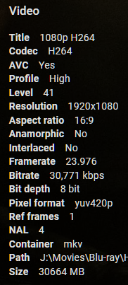

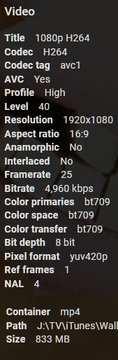

tomnjerry74 97 Posted December 9, 2019 Author Posted December 9, 2019 (edited) On 12/8/2019 at 8:32 PM, Luke said: The stutter example is being direct played. The vast majority of the time if you're direct playing and there's a stutter, it means the bitrate is too high for the connection. Try lowering the in-app quality setting so that it transcodes and see how that compares. Okay, I disabled hardware acceleration and the issue with the VC1 video was solved. Does that mean I really just can't use hardware acceleration? And as for the stuttering issue, here's an example of what I mean: This video plays perfectly at 1080p 60mbps: And this is the video that is stuttering at 1080p 60mbps: Edited December 27, 2020 by tomnjerry74

Luke 42217 Posted December 9, 2019 Posted December 9, 2019 Okay, I disabled hardware acceleration and the issue with the VC1 video was solved. Does that mean I really just can't use hardware acceleration? And as for the stuttering issue, here's an example of what I mean: This video plays perfectly at 1080p 60mbps: And this is the video that is stuttering at 1080p 60mbps: Strange. Where did that video come from?
tomnjerry74 97 Posted December 9, 2019 Author Posted December 9, 2019 Strange. Where did that video come from? The one with the problem came from iTunes.
tomnjerry74 97 Posted December 9, 2019 Author Posted December 9, 2019 (edited) Strange. Where did that video come from? Could it possibly be the weird framerate? I think it might be the only video I have that is 25. I have other videos from the same source that play perfectly too. If you would like I can remux a small clip from the video for you. Edited December 9, 2019 by tomnjerry74
Luke 42217 Posted December 9, 2019 Posted December 9, 2019 It could be, and yes you can do that, but make sure to test with the remux first to make sure it has the same problem. thanks.
tomnjerry74 97 Posted December 9, 2019 Author Posted December 9, 2019 (edited) It could be, and yes you can do that, but make sure to test with the remux first to make sure it has the same problem. thanks. I remuxed some short clips from the video into mkvs and they direct play without any problem on the same device. I used mkvtoolnix. Edited December 10, 2019 by tomnjerry74

tomnjerry74 97 Posted December 10, 2019 Author Posted December 10, 2019 It could be, and yes you can do that, but make sure to test with the remux first to make sure it has the same problem. thanks. I ended up remuxing my stuttering videos to mkvs and now they all play perfectly.
cptlores 41 Posted December 11, 2019 Posted December 11, 2019 Notice the problematic video has 25fps (PAL). This is the same experience I also have. Lot's of playback issues with PAL content. Especially if it is interlaced (50hz) video.
