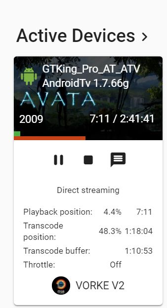

clarkss12 304 Posted December 18, 2019 Author Posted December 18, 2019 (edited) Are you still not seeing transcoding info on the server dashboard? Amazing, absolutely amazing. No transcoding. It is showing direct stream, and that is with subtitles enabled.......... BTW, love this new interface............ Was going to make a YouTube video showing this enhancement.. Edit: Right now, the only videos that transcode, are my VC-1 encoded BlueRay rips. The stats on the screen show "Unsupported Video", but that has always shown that message... But transcoding reason does not show up under the server dashboard.... Edited December 18, 2019 by clarkss12
clarkss12 304 Posted December 18, 2019 Author Posted December 18, 2019 (edited) Now, this is really strange. I was testing different videos, to see if any were transcoding. I went back to Avatar and stated playing it, now it shows transcoding. I did not touch any settings, including the subtitle selection........ I don't see anything on the server dashboard showing what is causing the transcoding. It is definitely the subtitles that are causing the transcoding. I change to SRT subs, and it stops transcoding. Edited December 18, 2019 by clarkss12
