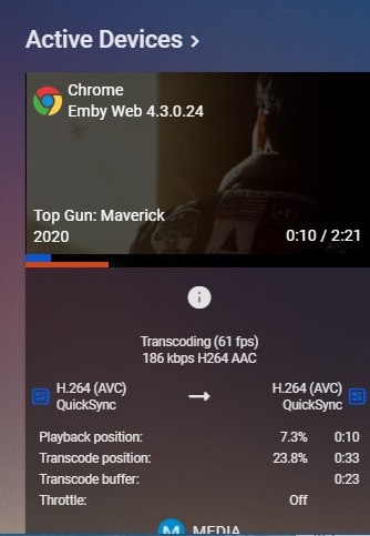

intranetsnob 0 Posted December 1, 2019 Posted December 1, 2019 Hi there, How do you know if your container is being transcoded on the WEB UI (dashboard) using GPU instead of CPU. also, how do you enable GPU transcode Thank you.
Happy2Play 9814 Posted December 1, 2019 Posted December 1, 2019 What do you see on the Dashboard Active Devices? As you can see in my test it is using GPU for decoding and encode, otherwise it would show software for both. What is Dashboard-Transcoding "Enable hardware acceleration when available" set to?

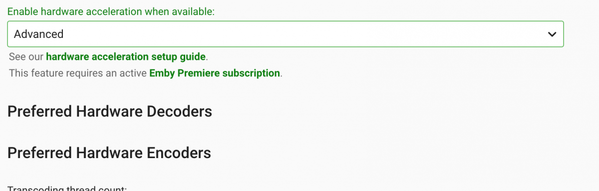

intranetsnob 0 Posted December 1, 2019 Author Posted December 1, 2019 Hi, See attached what mine shows. Definitely nothing like yours plus no blue icon on the side either. + screenshot attached for dashboard settings.
Happy2Play 9814 Posted December 1, 2019 Posted December 1, 2019 Hi, See attached what mine shows. Definitely nothing like yours plus no blue icon on the side either. + screenshot attached for dashboard settings. Have you looked through the Wiki for Linux? If you have the devs will probably need the hardware_detection and maybe server log. https://github.com/MediaBrowser/Wiki/wiki/Hardware-Acceleration-on-Linux
intranetsnob 0 Posted December 1, 2019 Author Posted December 1, 2019 Thanks, I will look through it again. Was there anything you did on the dashboard to enable your GPU?
Happy2Play 9814 Posted December 1, 2019 Posted December 1, 2019 I am on Windows, but I only enabled transcoding to yes via the dashboard. Selecting Advanced allows further tweaking, but since you don't see any decoders or encoders it is more then likely one of the requirements via that wiki page.
