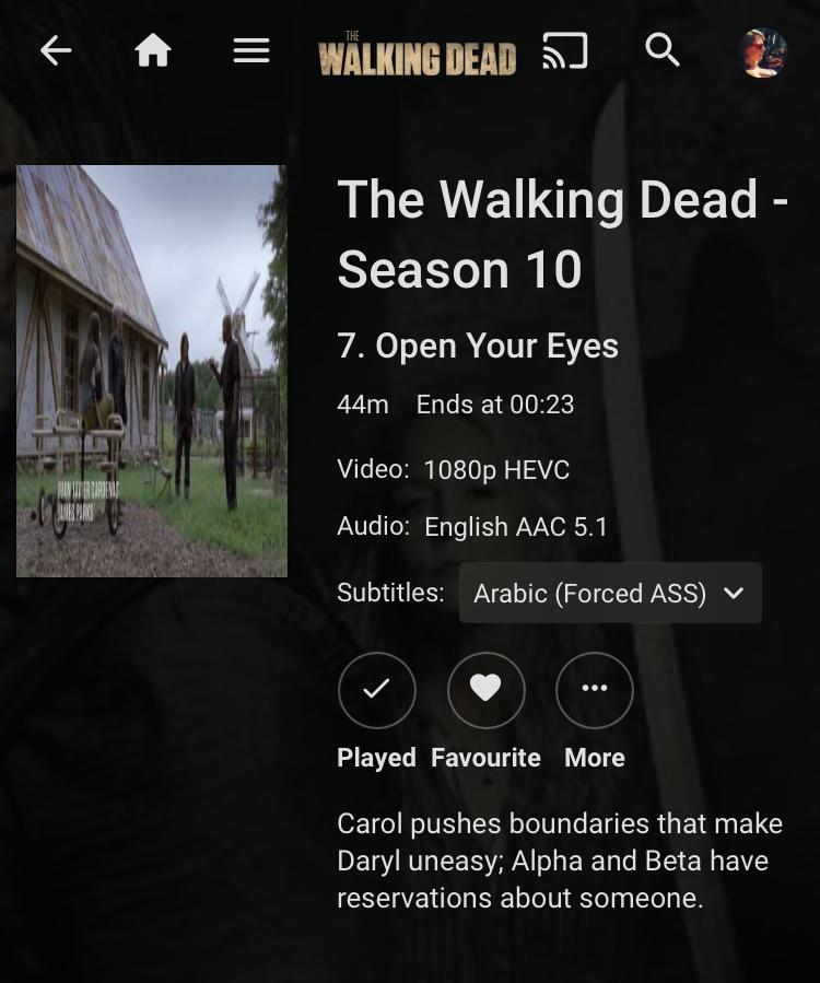

iD7eeM 1 Posted November 29, 2019 Author Posted November 29, 2019 What happens when you try to play on the smart phone? I can't even try, see for yourself.
Luke 42217 Posted November 29, 2019 Posted November 29, 2019 OK that's strange. Can you try turning to landscape orientation?
iD7eeM 1 Posted November 29, 2019 Author Posted November 29, 2019 OK that's strange. Can you try turning to landscape orientation? Ok, the play button appeared when turning to landscape, so the web app works on the computer & smart phone just fine but what about the PS4? I need a fix for that!
