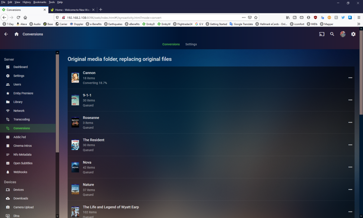

Luke 42216 Posted November 27, 2019 Posted November 27, 2019 No it won't, not if you delete your conversion jobs. Please show a screenshot of what the conversions screen looks like. Thanks.

Robert X. Gonzalez 4 Posted December 29, 2019 Author Posted December 29, 2019 Luke, Over the weekend I decided nuke my computer profile. System run great but when I checked the profile size found it to be over 2.5Gigs. As such, thought this would give a nice clean start to Emby while I was at it. Once Emby was installed with initial configuration, I used the backup plugin to configure it. I still had to do some final configuration such as user ID and PW for certain plugins. When I clicked on a library, in this case CANNON to auto convert, Emby went in and rechecked all episodes,; 18 items in this case. A closer inspection of the other TV Series/Libraries show Emby already preparing to go through the library again and convert. All items in Emby have been converted. There are no .TS files. I had to delete the others as it was bogging down my system. What I did a few weeks ago, is do one TV Series at a time and this way minimize impact on system performance. Any ideas? Also, when I went back to recording a TV series and checking the box "don't record episodes already in my library", Emby will still record SOME of the TV Series and not others. In the past, I let it do a complete scan, then one at a time added the TV Series I wanted to record automatically. In most cases this worked and if the episode was in my library, then it would show as grayed out. Sometimes I had to rerun the scan. Other times I would go to each TV series library; e.g., CANNON and delete everything except the .mp4 or mkv files and did a scan. Then would add the TV Series checking the do not record if in my library box. However, in some TV Series, this does not work. It will either GRAY out those I have or will want to record all of them in my series (that are airing). If I need to put in a separate ticket, let me know. Any suggestions to fix will help. I like to record old TV series, but sometimes, missed one, the station skipped it or some other aberration to include power failures causes episodes not to record. ffmpeg-remux-1d295f5e-b468-4fe7-96e6-95d7e4defc78_1.txt embyserver.txt
