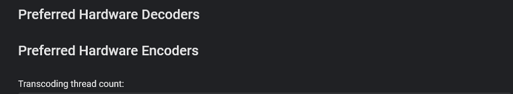

mholin 23 Posted November 23, 2019 Posted November 23, 2019 I've to report the same issue. with server 4.2.xx I was able to use my GTX1050 for both decoding and encoding (h264). now with server 4.3.0.26 there are no "preferred hardware-encoders" listed. With 4.3 I had the hope that now even h265 encoding would be offered. do you need some more information? bye Michael

mholin 23 Posted November 25, 2019 Author Posted November 25, 2019 I found this: "Level": 16, "Category": 0, "Message": "Driver does not support the required nvenc API version. Required: 9.0 Found: 8.1" }, { "Level": 16, "Category": 0, "Message": "The minimum required Nvidia driver for nvenc is 390.77 or newer" }, I will check this. anyway here is my hardware dection log from today. https://drive.google.com/open?id=1gvwtmtHL1YwLWzJogBlu_nFLjYrOdVM2 this is 170 KB, cannot insert this as plain text here.

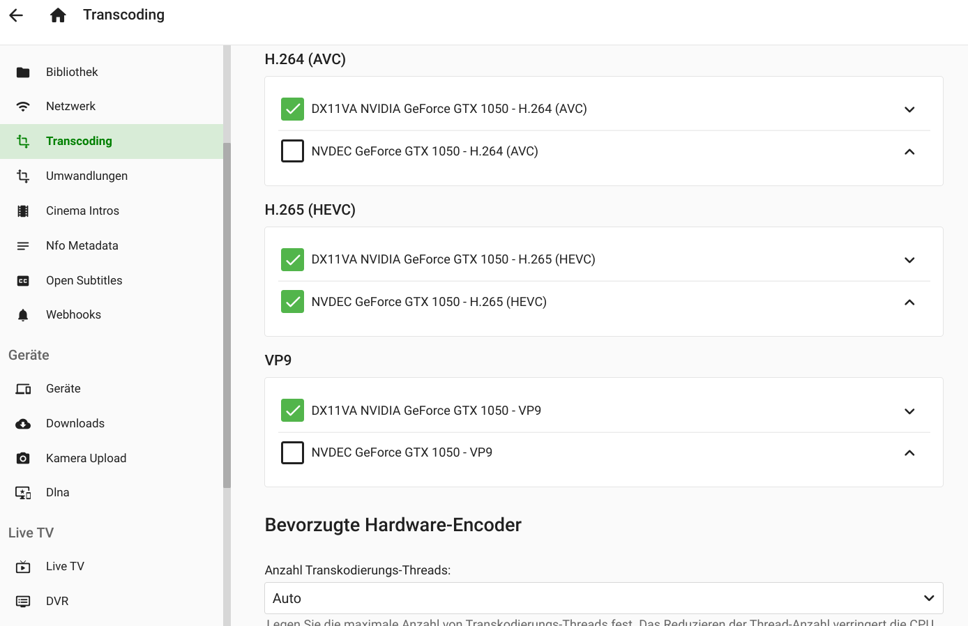

mholin 23 Posted November 25, 2019 Author Posted November 25, 2019 I've got this issue fixed. My latest geforce drivers where v417. Strangely they offered hardware encoding with the 4.2.0.21 server. I installed today geforce DCH drivers v441. maybe it's worth a hint, that beside logfile notice: "v390 is required", even V417 is not sufficient for server 4.3 with v441 now I got hardware encoding offered again in the servers transcoding section. with a quick test, video is currently always encoded to h264 to android client app. h265 is not possible to force. maybe this is an issue for later. today I'm happy. thanks Michael
