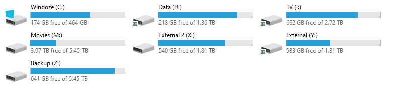

ebr 16313 Posted November 21, 2019 Posted November 21, 2019 Any chance you have a hard disc filling up?
m1stertim 2 Posted November 21, 2019 Author Posted November 21, 2019 Any chance you have a hard disc filling up? Negative.
