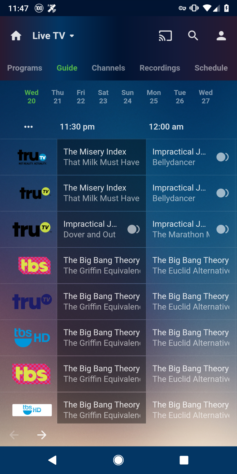

Luke 42217 Posted November 21, 2019 Posted November 21, 2019 You have these odd image urls that the server is trying to download on the fly: 2019-11-20 18:45:00.025 Info HttpClient: GET http://icon.thepk.media/icon/us/CSPAN.us.png 2019-11-20 18:45:00.059 Error HttpClient: Error getting response from http://icon.thepk.media/icon/us/CSPAN.us.png *** Error Report *** Version: 4.3.0.24 Command line: C:\Users\Tino-Media\AppData\Roaming\Emby-Server\system\EmbyServer.dll -noautorunwebapp Operating system: Microsoft Windows NT 6.1.7601 Service Pack 1 64-Bit OS: True 64-Bit Process: True User Interactive: True Runtime: file:///C:/Users/Tino-Media/AppData/Roaming/Emby-Server/system/System.Private.CoreLib.dll Processor count: 4 Program data path: C:\Users\Tino-Media\AppData\Roaming\Emby-Server\programdata Application directory: C:\Users\Tino-Media\AppData\Roaming\Emby-Server\system They're all timing out and this is probably stalling the user interface. So the question is where did they come from. Those urls don't look like they would have come from emby guide data.
Tony B. 38 Posted November 21, 2019 Author Posted November 21, 2019 (edited) The m3u file. If you want, you can move this into beta discussions. As I discussed with you on PM, the guide is emby provided, I sent a picture of that today. It might be better to take the m3u logo data and discard it and follow by the Emby guide logo data. Btw, it's transcoding without a hiccup (right now) at 1.03Mbps. However, trying to force it to 10Mbps causes tons of buffering, even though the server network is 20Mbps upload. I don't want to convolute this thread. The tech will be out tomorrow to check on the remote line. I'm guessing low SNR. Edited November 21, 2019 by Tony B.
Luke 42217 Posted November 21, 2019 Posted November 21, 2019 Ok I would try removing the logos from the m3u.

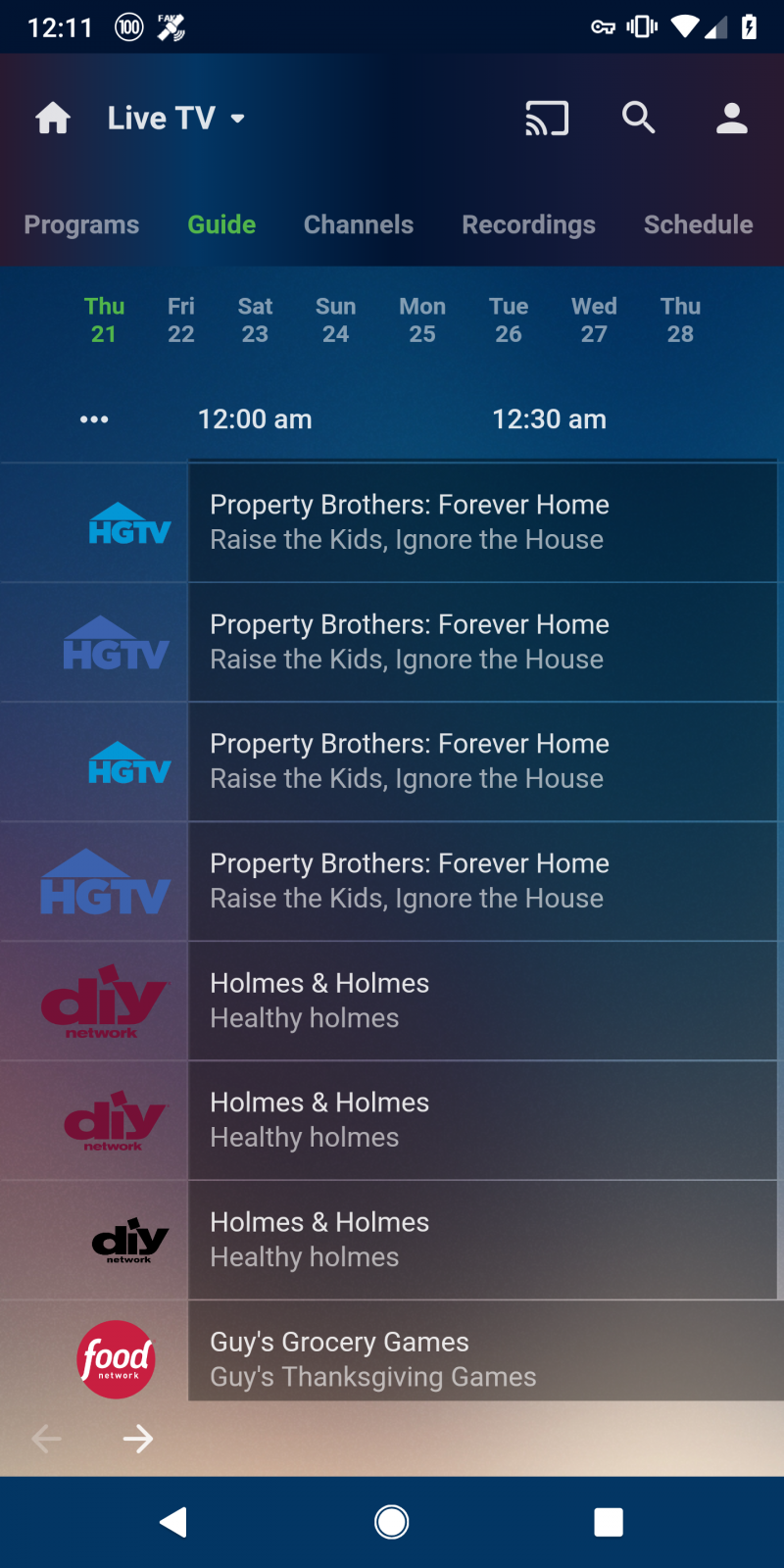

Tony B. 38 Posted November 21, 2019 Author Posted November 21, 2019 (edited) @@Luke Still have logos! (I was worried) But! Shouldn't they look all the same, because they come from the same provider? Edited November 21, 2019 by Tony B.
Luke 42217 Posted November 21, 2019 Posted November 21, 2019 They may have been acquired at different times.

Tony B. 38 Posted November 21, 2019 Author Posted November 21, 2019 No, you kinda changed the subject to logos with that quote from the log. I agreed to the subject change after the fact that I said there would be a tech out to discover what is wrong with the remote end's internet. Then, I was wondering why all of my logos are different even though they are from the same guide provider. Are logos cached? One day am I going to see no logos at all?
Luke 42217 Posted November 21, 2019 Posted November 21, 2019 No I didn't change the topic. I said the logos were the source of the problem stalling the UI because the logo urls were bad.
