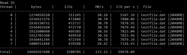

ServerGuy 24 Posted November 3, 2019 Author Posted November 3, 2019 @@ServerGuy - This source video has a rate of 70 Mbit/s. Same as @@Luke, my primary suspicion would be source file reading performance. My current read performance for the G drive is below. No other streams were playing at the time and the server was pretty idle. I know i have a bottleneck of my controller and am currently looking at an H730P, but I wouldnt think a single transcoding would saturate the server. I also ran this against the SSD RAID 1 and got similar numbers, however the SSD write performed at 311 MB/s. The transcoding logs you have are after i changed the transcoding location from the RAID6 (G) to the RAID1 SSDs ©. I did see a small improvement in disk active times and queue length after doing so, but only a marginal amount. (With transcoding on G, active time was around 1.2% and disk queue was around 1, normally below. With transcoding on C, it improved to the numbers i gave in my initial post) With transcoding in either location, I still see the issue.
softworkz 5130 Posted November 3, 2019 Posted November 3, 2019 Could you please post a transcoding log with the video file located on the C: drive (= local SSD if I understood correctly) and playback from the start (not resume)?

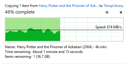

ServerGuy 24 Posted November 4, 2019 Author Posted November 4, 2019 I created a temporary library and copied the file (which copied at the below screenshot rate) to the C drive (RAID1 SSD) and began playback, because I had to use playback correction, i wasnt sure if this started FFMPEG from the beginning of the file or not so I included all logs from that point in time. It takes 2 instances of selecting playback correction for playback to work correctly. Sadly I had the same result, started around 10 seconds of buffer and ate away to 5 seconds where I got a loading screen for it to buffer again for a good while. ffmpeg-transcode-17e978ae-d9a8-4e4e-a981-e1ce3211c7d3_1.txt ffmpeg-remux-dc891cab-fbc3-4f4c-9c87-a7c41b77042e_1.txt ffmpeg-remux-d91859ab-e64f-41b4-9236-a626cfa78c57_1.txt ffmpeg-remux-afdf1d64-6541-4d5d-876d-aff915e7545a_1.txt
softworkz 5130 Posted November 4, 2019 Posted November 4, 2019 (edited) Thanks for the logs! You are right. It's not a matter of disk IO. Could you please open a command prompt and navigate to: C:\Users\Administrator\AppData\Roaming\Emby-Server\system\ Then try the following command lines: CMD1 ffmpeg.exe -f matroska -i file:"C:\TempLibrary\Harry Potter and the Prisoner of Azkaban (2004) - 4k.mkv" -threads 0 -map 0:0 -map 0:1 -sn -c:v:0 libx264 -pix_fmt yuv420p -maxrate 109616000 -bufsize 219232000 -preset veryfast -profile:v:0 high -level:v:0 4.1 -crf 23 -x264opts:0 subme=0:me_range=4:rc_lookahead=10:me=dia:no_chroma_me:8x8dct=0:partitions=none -g:v:0 72 -keyint_min:v:0 72 -sc_threshold:v:0 0 -copyts -vsync -1 -codec:a:0 ac3 -metadata:s:a:0 language=eng -disposition:a:0 default -ac:a:0 6 -ab:a:0 384000 -ar:a:0 48000 -f segment -max_delay 5000000 -avoid_negative_ts disabled -map_metadata -1 -map_chapters -1 -start_at_zero -segment_time 3 -individual_header_trailer 0 -segment_format mpegts -segment_write_temp 1 -segment_list_type m3u8 -segment_start_number 0 -segment_list "C:\Transcoding\transcoding-temp\efa1cf782b41490d871227915afb5148.m3u8" -y "C:\Transcoding\transcoding-temp\efa1cf782b41490d871227915afb5148%d.ts" CMD2 ffmpeg.exe -f matroska -i file:"C:\TempLibrary\Harry Potter and the Prisoner of Azkaban (2004) - 4k.mkv" -threads 0 -map 0:0 -map 0:1 -sn -c:v:0 libx264 -pix_fmt yuv420p -maxrate 10961600 -bufsize 21923200 -preset veryfast -profile:v:0 high -level:v:0 4.1 -crf 23 -x264opts:0 subme=0:me_range=4:rc_lookahead=10:me=dia:no_chroma_me:8x8dct=0:partitions=none -g:v:0 72 -keyint_min:v:0 72 -sc_threshold:v:0 0 -copyts -vsync -1 -codec:a:0 ac3 -metadata:s:a:0 language=eng -disposition:a:0 default -ac:a:0 6 -ab:a:0 384000 -ar:a:0 48000 -f segment -max_delay 5000000 -avoid_negative_ts disabled -map_metadata -1 -map_chapters -1 -start_at_zero -segment_time 3 -individual_header_trailer 0 -segment_format mpegts -segment_write_temp 1 -segment_list_type m3u8 -segment_start_number 0 -segment_list "C:\Transcoding\transcoding-temp\efa1cf782b41490d871227915afb5148.m3u8" -y "C:\Transcoding\transcoding-temp\efa1cf782b41490d871227915afb5148%d.ts" CMD3 ffmpeg.exe -f matroska -i file:"C:\TempLibrary\Harry Potter and the Prisoner of Azkaban (2004) - 4k.mkv" -map 0:0 -map 0:1 -sn -c:v:0 libx264 -pix_fmt yuv420p -maxrate 10961600 -bufsize 21923200 -preset veryfast -profile:v:0 high -level:v:0 4.1 -crf 23 -g:v:0 72 -keyint_min:v:0 72 -sc_threshold:v:0 0 -copyts -vsync -1 -an -f segment -max_delay 5000000 -avoid_negative_ts disabled -map_metadata -1 -map_chapters -1 -start_at_zero -segment_time 3 -individual_header_trailer 0 -segment_format mpegts -segment_write_temp 1 -segment_list_type m3u8 -segment_start_number 0 -segment_list "C:\Transcoding\transcoding-temp\efa1cf782b41490d871227915afb5148.m3u8" -y "C:\Transcoding\transcoding-temp\efa1cf782b41490d871227915afb5148%d.ts" take note of the fps= and speed= values in each case Edited November 4, 2019 by softworkz
