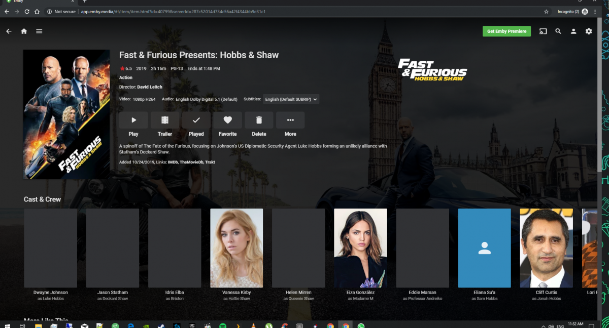

Bobs604 0 Posted October 25, 2019 Posted October 25, 2019 Hello there, I'm new to Emby and I come from the plex world. I'm just wondering how do I get the server to show all the cast thumbnails in the library. Like some of the cast will have the thumbnail and some won't. Why is that and how do I do it without having to manually using the identify option for every single missing one?
Luke 42217 Posted October 26, 2019 Posted October 26, 2019 Hi there, can you please discuss an example? Thanks.
Bobs604 0 Posted October 26, 2019 Author Posted October 26, 2019 (edited) Below is an image of what I mean. How do I get a picture of all the cast & crew to show without having to go into each missing one individually and using the indentify option. Edited October 26, 2019 by Bobs604
Luke 42217 Posted October 26, 2019 Posted October 26, 2019 The blank squares mean that images are loading. it might just be taking a little time. can you please attach the emby server log? thanks.

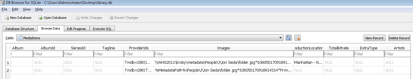

Happy2Play 9806 Posted October 27, 2019 Posted October 27, 2019 @@Luke well it would appear I have the duplicate entries for a most but not all people. So it would appear I will be doing a rebuild in the near future on this system. Had this discussion in another topic, Migration issues.
Happy2Play 9806 Posted October 27, 2019 Posted October 27, 2019 But a quick fix was updating network path to local path in the database. UPDATE MediaItems SET Path = replace( Path, '\\WHS2011\Emby\metadata\', 'Y:\Emby\metadata\' ) WHERE Path LIKE '\\WHS2011\Emby\metadata%'; UPDATE MediaItems SET Images = replace( Images, '\\WHS2011\Emby\metadata\', 'Y:\Emby\metadata\' ) WHERE Images LIKE '\\WHS2011\Emby\metadata%';
Bobs604 0 Posted October 27, 2019 Author Posted October 27, 2019 BTW this isn't for just the fast & furious movie... its for all my movies. I just the fast & furious as just an example of what I meant was going on
Happy2Play 9806 Posted October 27, 2019 Posted October 27, 2019 BTW this isn't for just the fast & furious movie... its for all my movies. I just the fast & furious as just an example of what I meant was going on Right it would appear at some point you had a custom metadata path. C:\Users\Bobby\AppData\Roaming\Emby-Server\metadata files The database still has that path for select persons image, and it would appear that path no longer exists. There are some things that require starting over or attempting to manually edit the database like I did above.
