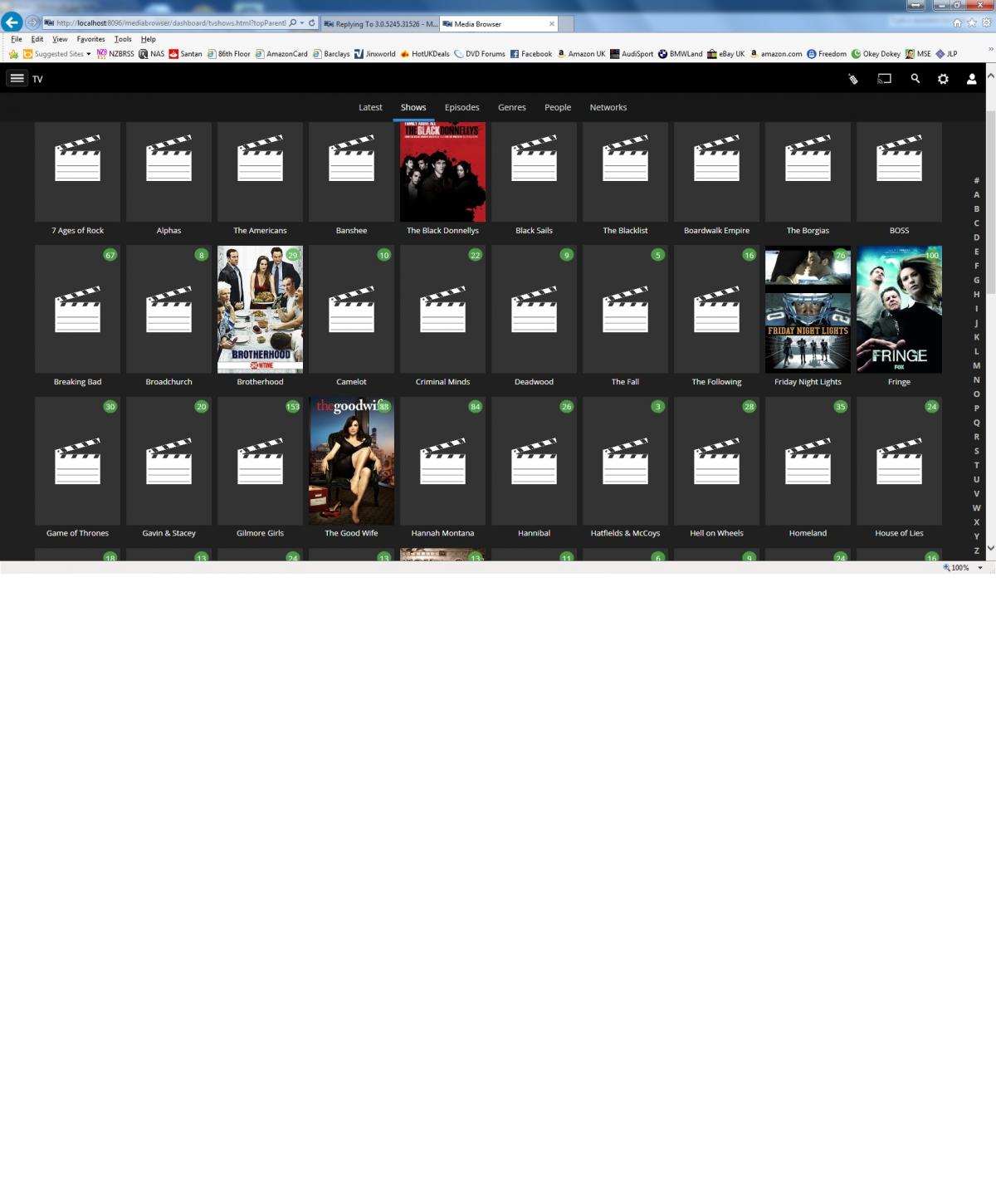

The Governor 1 Posted June 8, 2014 Posted June 8, 2014 Hi all, I reported this in the Alpha section, Luke suggested I start a new thread. I've spent the last week or so tidying up my media for MB3 Server to scrape all my TV Shows and Movies. I'm also an XBMC user and all my media works perfectly through that. Having got all my shows etc identified and all the poster imagery sorted out where the scraper had got it wrong etc, my server was automatically updated this AM to version 3.0.5271.29451. At which point all of the imagery has disappeared, screen shots attached of what I'm left with, yesterday those views were all fully populated correctly In most cases the content is recognised, i.e. has the right info about the movie/tv show, but no imagery whatsoever. Oddly, as you can see, some shows are being recognised, but with no apparent pattern. I've restarted the server, rebooted the PC, kicked off a few Library scans and also removed my "Movies" source and re-added it, all with the same result. I also just realised that any videos that have external subtitles (SRT) files won't play, I think I read something about this issue, is it still awaiting a fix? I've attached pics of what I see in library view and also my logs in case they help? The only thing I've not done is uninstalled and reinstalled the software, which I'm tempted to do... server-63537839123.txt transcode-3cd71d63-0460-48e3-ab9d-e2e5ad93e7ef.txt
Solution Luke 42180 Posted June 8, 2014 Solution Posted June 8, 2014 since you're using a custom metadata path, is it possible the server was started at a point in which that path was unavailable? it's possible the server detected that, removed the links to the images, and has not reconstructed them since. it should reconstruct, but it's possible there's an issue there. In any event, also if you refresh a single title using the metadata editor, what happens there? 1
The Governor 1 Posted June 8, 2014 Author Posted June 8, 2014 Thanks for the reply Luke, It isn't impossible Luke, although the external source is a USB attached hard drive, so if the PC is on the device is available (I wonder if it just didn't spin up quickly enough, but the update seemed to happen very shortly after the PC automatically starts so the HDD is likely to have been as ready as it ever is If I do a manual refresh in the editor that does actually seem to work now you mentioned, so it looks like if I did that for each object it would work (that';s a lot of clicking the refresh button ) Odd that removing/re-adding the source doesn't do the same thing though..?

The Governor 1 Posted June 8, 2014 Author Posted June 8, 2014 Ah, I just realised it's possible to do a refresh at the top level, so in the metadata editor I selected "Movies" and hit refresh and that seems to be pulling all the imagery in now, your suggestion inspired me to have another look at the editor Luke, so thank you I suspect you're right about the drive not being immediately available...
The Governor 1 Posted June 8, 2014 Author Posted June 8, 2014 (edited) Update : I just restarted the server software and all the imagery is gone again, so it looks like it is something to do with it being on external storage... I'm not sure how to get around that, as I have about 3TB of media so there's no way I could practically keep it inside the PC... I can either host it on a USB connected drive (as now) or on my NAS, which is on the network, so either way the storage is external and I guess I might always have this issue? I can't be the only person hosting stuff on an external source though I'd imagine, as we're talking a lot of data for this type of stuff? Any thoughts Luke on way I could find around this? For example is it possible to force a refresh after every reboot to save having to remember doing it manually? Edited June 8, 2014 by The Governor
